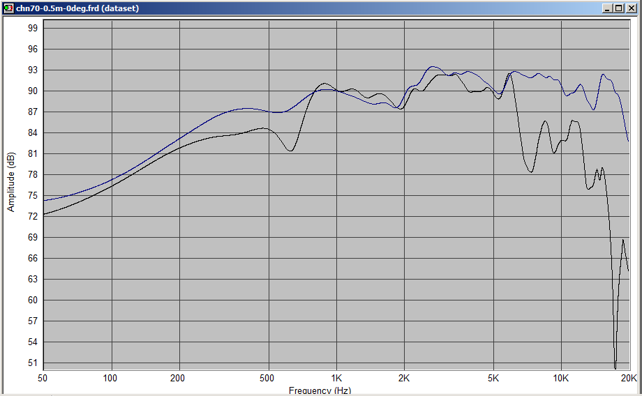

Even from the plot you posted it appears that the TC9FD is flatter over 800Hz and 5.5kHz. Also, when using this as a mid, the responses below and above the XO points should be smooth for an octave below and above the XO point.
Hi X, I was basing (the comment) on this graph, not your original measurements. though if overlayed it may be different. I haven't downloaded those measurements.
470358d1425832404-subjective-blind-comparison-3in-5in-full-range-drivers-all-offset-col.png
