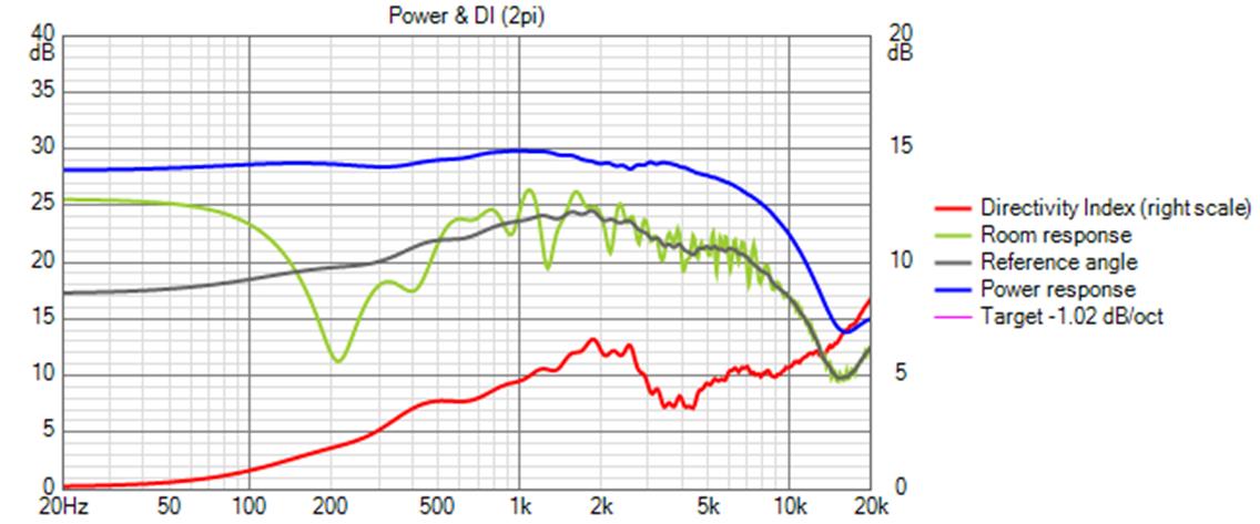

In an attempt to put this to rest, I did a progression of diffraction simulations in which I kept the pitch of the drivers the same 95mm but gradually increased the height of each driver's radiating surface from the 60 mm original up to 95mm at which point there is a continuous line source. At 86 mm where the gap between drivers is about 10% of the spacing, things started looking pretty good.
attachment.php
Given this progression showing continuous improvement with decreasing gap, I am inclined to believe that the simulation accurately predicts where one would see combing effects in the array. (I've also asked Kimmo, the author of Vituix, to comment). That doesn't mean the array wouldn't sound good because those comb lines disappear with smoothing.

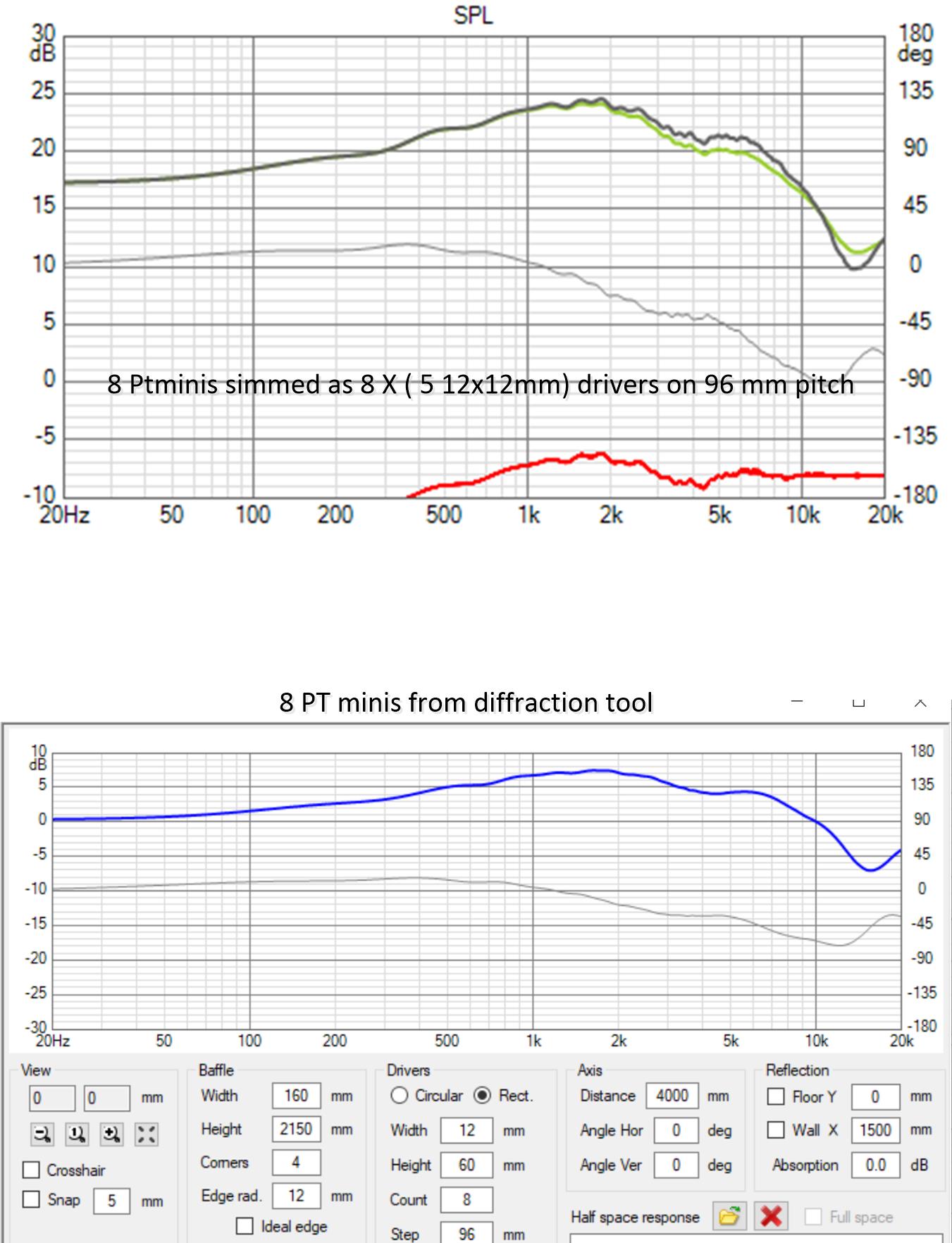

Got a suggestion from Kimmo as to how to get more accurate sim of PTmini - model it as multiple smaller drivers that touch. If its diaphragm is 12x60 mm, it can be modeled as 5 12x12s. This will take a little bit of time but not all that much. Meanwhile, the short array approach still looks encouraging to me.
Well, not that much time at all. I placed 64 of these 12x12 mm drivers then deleted 3 out of every 8 leaving a gap of 36mm between groups of 5. Directivity for the 12x12s was computed at 1 degree steps.
The figure shows both this sim and results from the diffraction tool. Vituix limits me to 65 drivers total so I can't do a bigger array this way but the small differences gives confidence in the diffraction tool results.

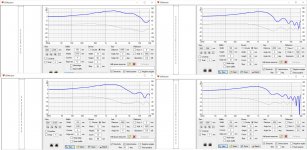

I think now I've done enough simulation to believe that it is indeed worth trying It appears that the amount of combing increases with the length of the array, as does the vertical coverage. The next question is how long should the array of PTminis next to the full height array of TC9s be.
attachment.php
If I were building this, I would go with 12 PTminis spanning sitting through standing ear height. With this length PTmini array, I don't see a need to frequency taper the TC9 array.
I would say the length of the vertical line of PT Minis could be limited to two factors.....the desired vertical listening window size and power handling......which is the bottleneck here. Power compression is REALLY evident with planar drivers as there’s little to dissipate heat which contributes to power compression. I originally considered a length of 16 units for an overall HF line length of 60”.
A third factor is when you get combing instead of just ripples in the frequency response. There is a just a hint of combing at 16 drivers (top right of previous graph) at around 18 khz and starts at about 12 khz with 20 drivers (bottom right in previous graph).
Well as far as power goes, the array both giveth and taketh away. You get more devices in parallel for more efficiency and more power handling but you also get a 3db per octave roll off. There are only ~2.5 octaves between 4 khz and 20 Khz so that is only 7.5 db but you have 9 db of array gain with just 8 drivers and 9 db more power handling. Power compression shouldn't be an issue for the tweeter array even limited to 12 drivers.
The graphs suggest you can go to a longer PTmini array and avoid combing so long as you frequency taper it. Probably smarter to keep it simple.
