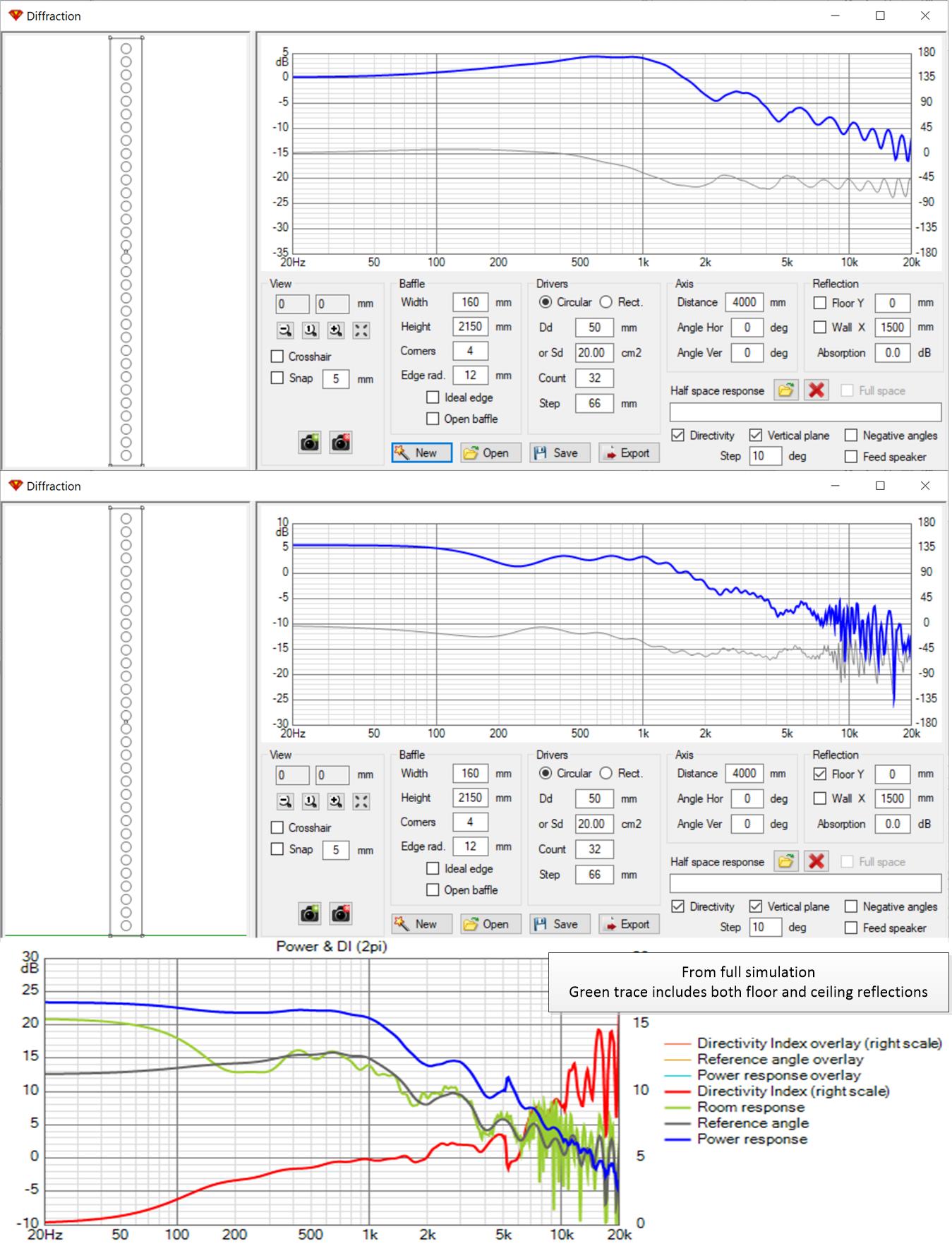

Here in the top two thirds of the image are the apples to apples screenshots of diffraction for the SB65 based solely on its piston diameter and spacing in my array. The lowest third shows in the green trace the computed room response with both floor and ceiling reflections from the full array simulation.

I wondered the same Jim, hence why I asked for the same sim with the Round fullrange for comparison. While there is no published vertical response graph, I’d be surprised if the vertical window differed much from typical ribbon and planar performance.

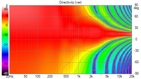

I exported a full suite of Vituix diffraction data for the PT2C and took a look at it. Vituix is indeed modelling different horizontal and vertical directivities in these simulations.

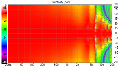

I chose to look at the PT2C rather than the mini because its vertical coverage is around 82% whereas the mini's is only around 63% while 90% is recommended. The PT2C is thus more likely to give good results in an array.
In that spirit, here is the array horizontal directivity as I don't think the aspect ratio issue affects the horizontal much, if at all:
Despite being much wider than the mini, the PT2C still gives a fairly wide beam, about 2x the beamwidth of my SB65 array.
