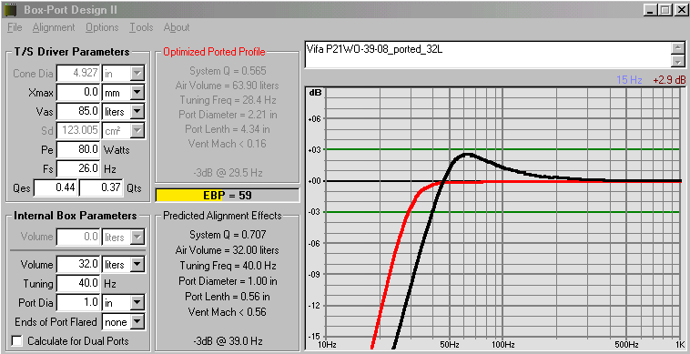

So I can conclude I will have a decent output at 50hz from the P21, albeit 3db down.
I have some idea about the KLH EQ you mention. Is'nt it something like altering the 'Q' to bump the response a few db's up. Well, I have a Active kit I'm trying to put together and am struggling to. It is the John Pomann kit from snippets.org. I'm not very adept at doing this kind of stuff. In fact the bass-unit I'm building is my first shot at this wonderful hobby.

I have a JAES article on that KLH thingie, written by a KLH developer named Daniel von Recklinghausen. I can find out the issue etc if you like.
It is basically a 6th order reflex alignment using a highpass filter with a hump. Additionally it is voltage-controlled by some frequency- and amplitude dependant control circuit, thereby preventing overexcursion of the (very) small woofer.
It is of course possible to make a 4th order closed-box system that way as well.
Even the excursion limiting feature could be used. For a closed box it is quite easy to derive excursion vs frequency: It is a lowpass function with the same order and Q as the amplitude response, mirrored at fsb.
I once did the maths etc on a 2nd order highpass that could also be used for the same purpose and which is even a bit simpler (a standard Sallen-Key with a tuneable resistor built around an OTA) than the KLH circuit.

If you like lower bass, vented box is perfectly alright in a room of 5x3m. The problem with standing waves is not so much in room volume but dimensions and reflectivity. Apart from a listening sofa, break up the walls with bookshelves, cabinets, anything to disperse the sound waves. You will be surprised at the difference, when compared with a completely bare room.

Overexcursion occurs indeed when you reach the "maximum excursion before damage", or maybe even before that, depending on your requirements.
A Sallen-Key filter is the most used filter topology for 2nd order low- or high-pass filters. The filter-structure used by Sigfried Linkwitz within the following link are Sallen-Key filters:
http://www.linkwitzlab.com/filters.htm#2
An OTA is an Operational Transconductance Amplifier. It is basically some sort of opamp that doesn't have a gain defined by output-voltage/input-voltage but by a transconductance=output-current/input-voltage. I.e. it is a voltage-controlled current-source with differential inputs. The transconductance can be controlled by some kind of bias-current.
My favourite one is still the old-fashioned CA3080. It doesn't have very good specs but depending on the way you use it it does only get into action when the overexcursion protection is needed.
In this case one can live with the slightly increased distortion: a driver whose voice-coil is hitting the backplate generates definitely more of it !!
Instead of an OTA you can use a JFET or a LED/LDR (Light Dependant Resistor) combination.

First of all , 50Hz is the "hum" that you hear from your speakers when you touch the inputs of your amp with your finger. It is also the local mains frequency.
You need to get down to 40 Hz or so to really hear deeper bass - far more satisfying than the 50 Hz limit. As frequencies go down , even small changes sound very different. 30 Hz and 40 Hz sound nothing like 50 Hz ! Also remember that when you say "go down to 50 Hz" it is not a brick wall filter so other frequencies will still be there in smaller quantities.
You can convert your 731 into a biwireable speaker and upgrade the speaker crossover with better parts. Polyester caps and air core inductors. If necessary you can damp the cabinet walls by gluing bitumen impregnated sheets to the walls. You have to watch out how much you add as it will cut down the internal volume. These mods should make a huge improvement in sound.
You can then crossover the 731 at Lf ( based on its acoustic roll off ) and add a sub. The P21W in a TL enclosure could be used.
There is a lot of work to be done. I can't put it all down here. Ask your questions as you go along and someone on the forum will be able to help you .

you can do the EQ with a sealed bass units too. results will change depending on unit. if you are feeding bass up to 400Hz to the 21cm driver you are now talking about BSC (Baffle Step Comp). If I were you and were looking at mating the 731 to teh 8" I'd look at one of the 2 options.
leave the XO of 731 as it is (you may make the mods ashok siggested esp to the flimsy cab) and use the P21 to augment the bass belw 100hz via an acitve filter/EQ and seperate power amp.
alternately you can modify the XO of the 731 and let teh P21 take compensate for baffle step insted of the XO.
In both cases the P21 can be built into a stand for teh 731. in option 1 the P21 could be kept as close to the floor as possible (I prefer the method used by Roy Allison in their Allison 9 speaker in the70s) in option 2 the P21 should be as close to the midbass in fact it might make sense to fire the P21 towards the rear wall to compensate for phase anomalies of teh 6db/octave BSC.
I have left the details out of of this but you can either email me in private of shoose an option and we can investigate that further. it depends on if you want to expolre the 731s XO, you want to just augment bass or the midbass as well, if you have a spare power amp, etc.
BTW I am quite happy with a calulated (read as anechoic) F3 of 40Hz or so. In most rooms the F3 changes a bit usually get a bit lower and much more lumpy. below that you needs serius tube traps etc to keep the room for getting excited.
or you could combine the 2 and built a tall TL if you fold the line you could get a Tl of about 48"and then using damping increase effective lenght to about 96" enough for your needs. teh advatage of TL is you can play with damping to extend response to suit YOUR room.

Sorry about all the confusion. These are the facts:
1) I already have a P21 for which I'm designing the bass-cabinet
2) I own a pair of 731's to which I'll be using the bass-cabinet
3) Once the bass-unit turns out well, I want to build the top-unit
consisting of a D27TG & ............. ( P13 or P17 or M18 )
Navin,
The question is, which of the three will be best for midrange from 100hz onwards ? I plan to cross the D27's at around 2500hz.

- Vifa P21WO-39-08 Woofer - Sealed
