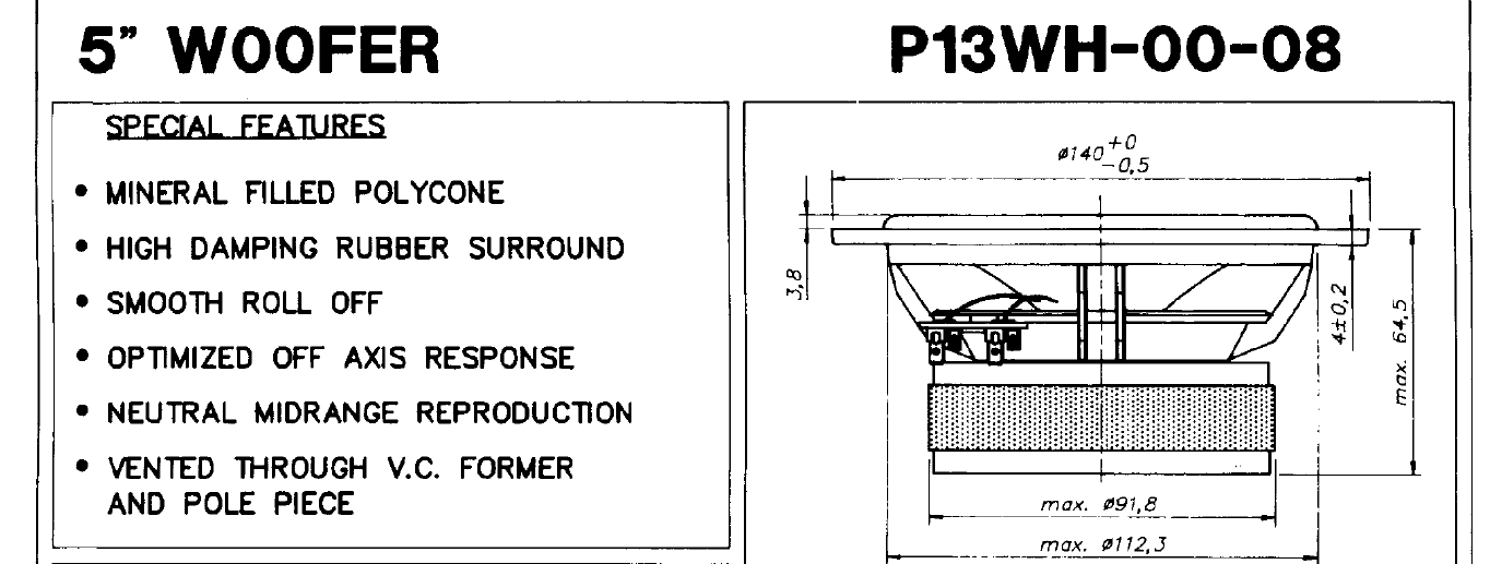

I have a pair of NOS Vifa P13WH-00-08 mids which have the dreaded surround hardening problem, but otherwise are OK.
Looking to replace the surrounds, but I cant find a source for new ones. There was a European company which used to carry them but no longer do.
The markings on the surround read SR-115-1
Anyone know of a good source for these?

Good suggestions guys. I thought about running them as is, but Fs was off between the two by about 30 hz and I feel the cone is too dampened. I tried a few cocktails of liquids to soften them, but they wouldn't budge. I may try a touch of acetone or silicone fluid.
The ABCD dimensions are 122mm, 112mm, 96mm, 90mm.

I sent the diameters and data sheet to speakerrepairshop.nl and a couple of other places, but nobody could help.
The surrounds were always firm; the data sheet says that the surrounds are "high damping type" so I am not convinced that they would sound right with aftermarket replacements.
