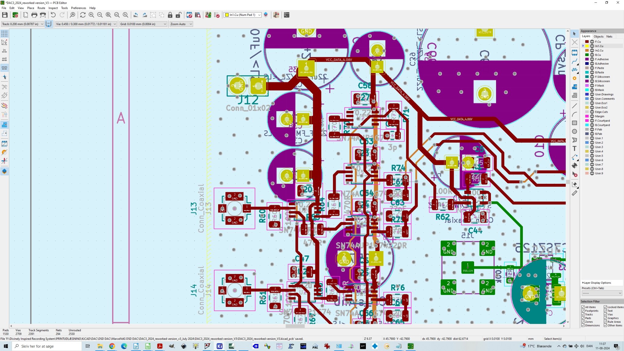

As it is I have for some time now been wondering about the effect of through-GND-stitching-vias (TGSV onwards), i.e. GND vias going all the way through the PCB, on the shielding effectiveness of the PCB copper layers between the top and the bottom sides of the PCB. That is: How much is the shielding between the top layer and the bottom layer of e.g. a 4 layer PCB deteriorated by adding (many) GND through-vias / stitching vias to the PCB?
Not one bit, assuming that the via barrel is properly plated. In that case, the top plane is directly connected to the bottom plane by copper tubes. And anything between those two planes is contained by the shield. The limit will be the via spacing and dielectric constant of the pcb, which determines the upper frequency limit at which the shield loses effectiveness
It would help you, and anyone watching, if you made a drawing of what you are thinking if. Even a rough hand drawn one.

Anyway, here's a screen-dump of part of the layout that I am working on (a variant of MarcelvdG's FIRDAC) - as you can see there are some through-vias connecting the planes.
Hmmm ... it would be interesting to know what the relationship is between these parameters. I remember Rick Hartley (reknowned PCB designer, I think) said that 15mm spacing between vias is sufficient for a 1 GHz "efficiency" - but would you happen to have a formula (or maybe a link to such information?).
Typically, the via distance on the PCB in question is 2.5mm and the Dk of the PCB is 4.4. PCB thickness is 0.8mm and the copper layer thickness is 35um on each layer. Vias are 0.3mm hole size and the copper cladding is appr. 18 um.

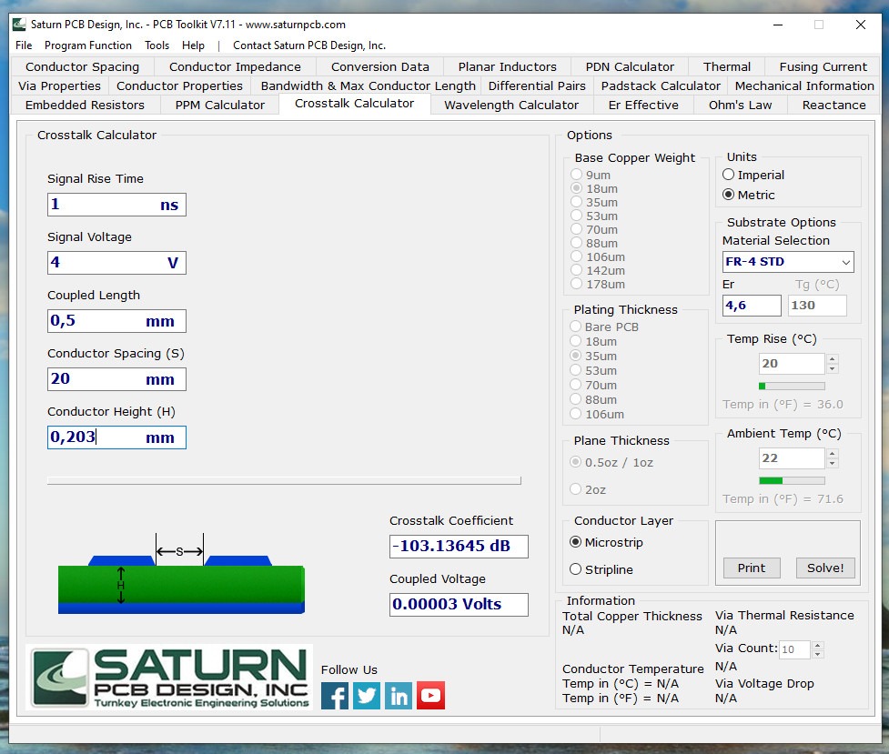

BTW - since you appear to know about these things - would you happen to have a guideline for how much a stub via radiates (second part of my post above):
And then an additional via related question: How much does a signal through-via - e.g. connecting a trace between layers 1 & 3 (but ending on layer 4) - radiate on layer 4, i.e. the "via stub"-end-layer?
I have considered this using the crosstalk calculator in Saturn's PCB design toolkit but I am not sure it is applicable to this context (pls see attachment 2) ...
Jesper
