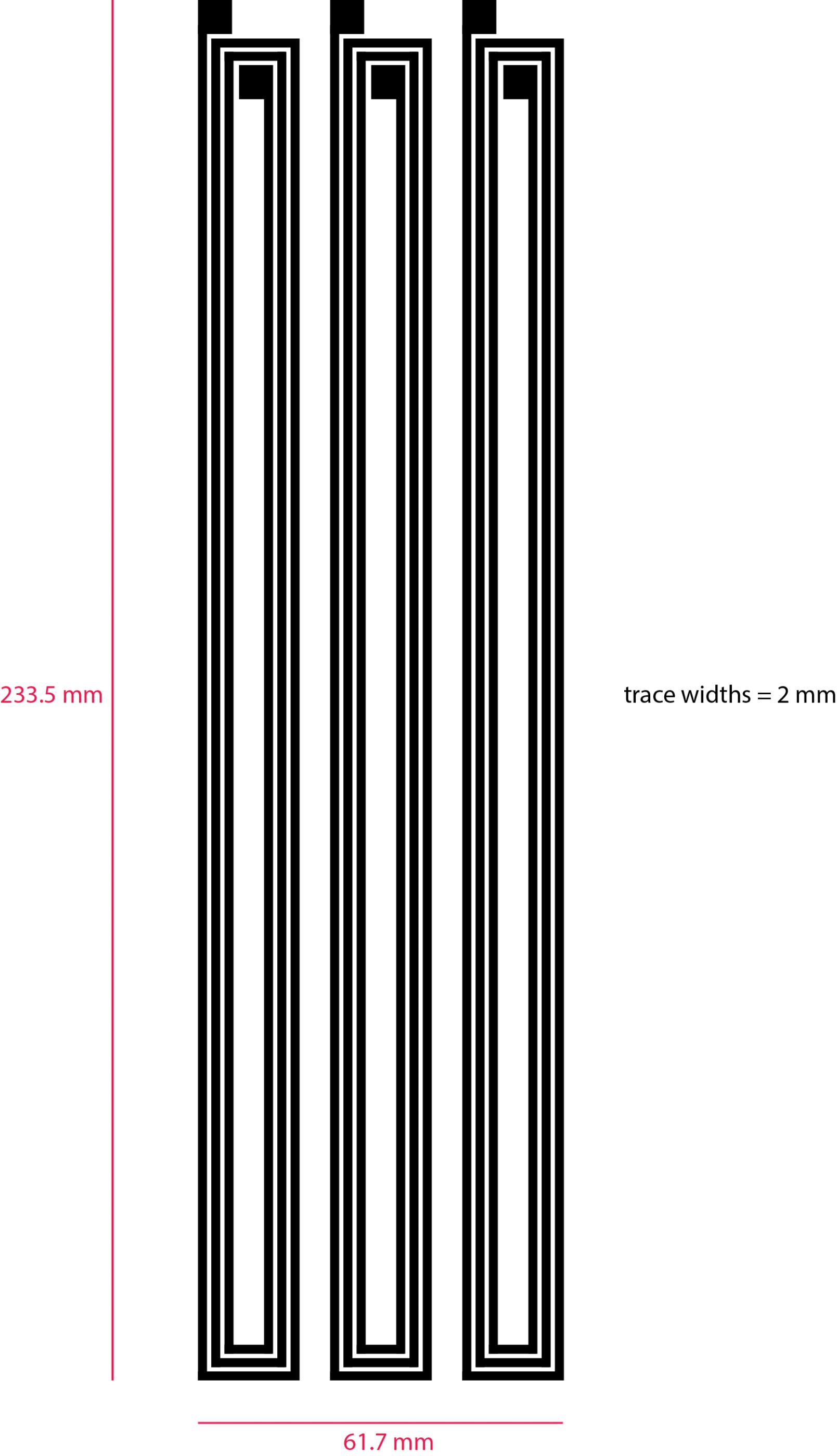

The weekend festivities are done here so I'm posting the conductor files Bernt requested. I'm trying to attach the file in two formats but I'm not sure they're both going through. I only see the jpeg version in the preview. The png file keeps getting lost for some reason.
Both files have overall height and width of the pattern. Please let me know if you need more dimensioning information.

I have a template for the cutter:

Looks great! If you accidentally cut 20 copies of the pattern and glue them to 4 micron thick mylar diaphragms, feel free to send them my way!😀
More seriously, how does your cutter operate? Does it rotate the cutter's orientation as it cuts in different directions? I've not seen a good video of how it does its thing.

Yes, it rotates the cutter's orientation as it cuts in different directions.More seriously, how does your cutter operate? Does it rotate the cutter's orientation as it cuts in different directions? I've not seen a good video of how it does its thing.
As this machine is also used by DIY circuit boards designers in order to cut SMD solder templates, there are better third party knives to be bought with different angles.
