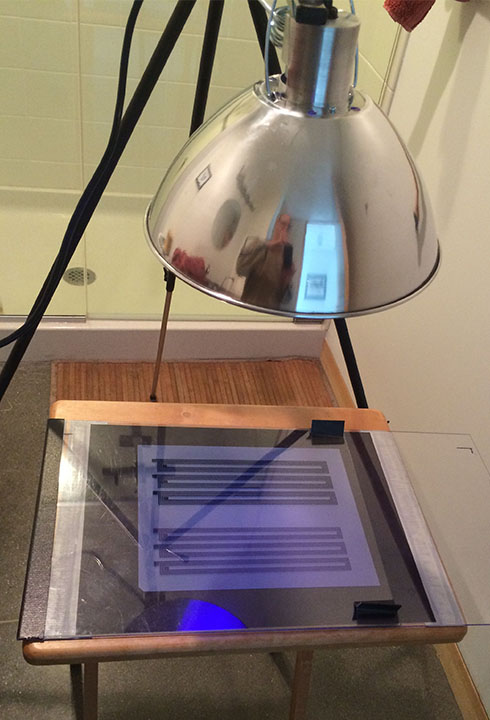

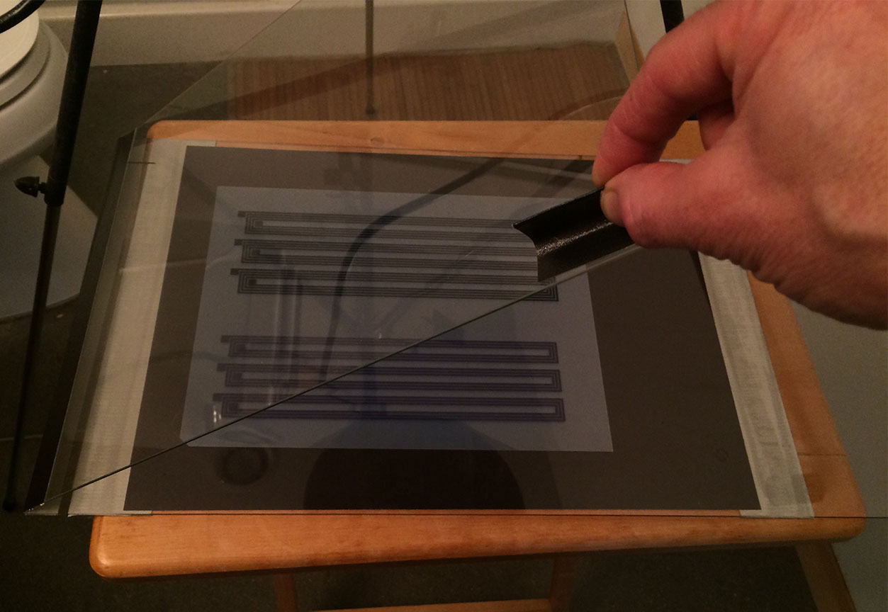

I thought I'd post a couple photos of my simple UV exposure set-up on the off chance someone would find them useful. The key point is finding a cover that will press the transparency firmly to the photosensitive emulsion on the silk screen and that will also transmit enough UV light. The first photo shows the lamp mounted above my glass-covered exposure platform. A reflection of the purple glow from the UV compact fluorescent bulb is visible in the glass cover. I keep the lamp about 12 inches above the transparency as a decent compromise. If it's closer the exposure takes less time but it is less even across the emulsion (my patterns are about 9 inches by 4 inches). Also, a point source of light gives sharper edged exposures, meaning more distinct edges on the resulting aluminum conductors, than does a broad diffuse source of UV. Moving the lamp farther away and using a single bulb makes it act more like a point source. Lately I've been using about 1.5 minutes of exposure with the bulb about 12" above a thin glass cover. (Apologies to readers who are not in the USA, Liberia or Myanmar; I keep switching between metric and stupid-units.)
The second photo shows how the glass lid is hinged at one edge so it's easier to handle things in the dark. Try to ignore the porcelain fixture in the background of my photo lab. This bathroom is about the only room in my house that doesn't have windows so I'm using it as my dark room.😱

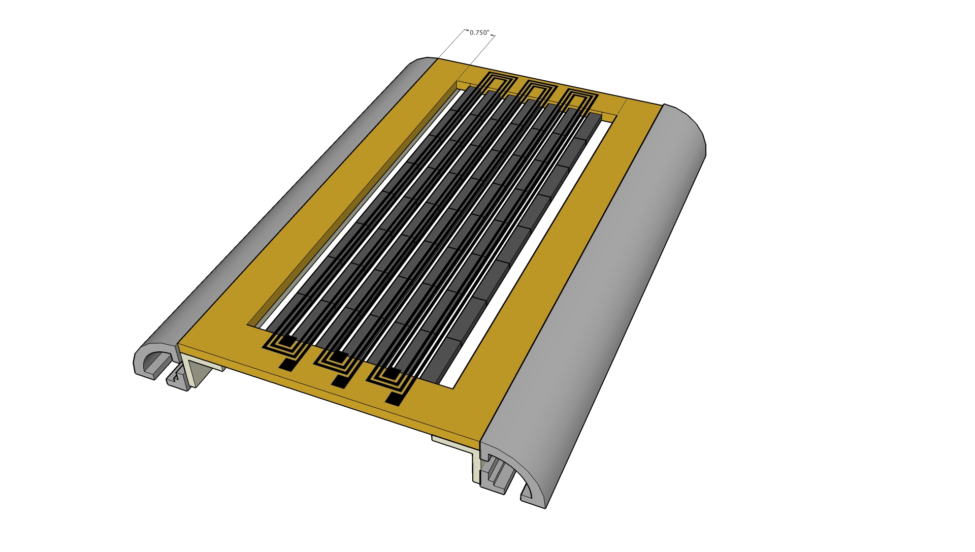

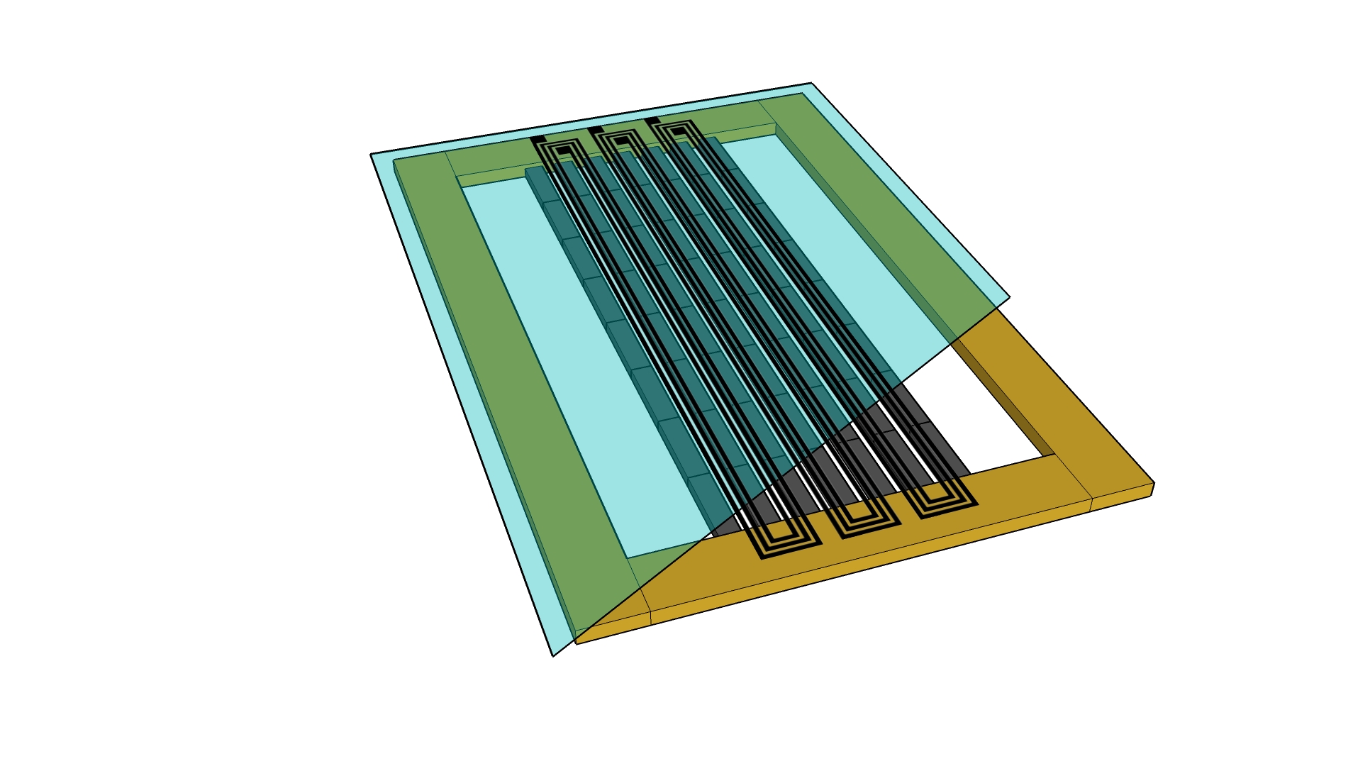

The attached Sketchup drawing shows what I'll try for my first prototype once I print and etch a conductor pattern. The diaphragm is cut away in one corner to make it a little easier to see the columns of 1" x 0.25" x 0.125" NdFeB magnets.
The wide gaps at the sides are there so that I can experiment with methods of damping the undriven parts of the diaphragm. Some discussions in the context of diy ESL speaker design suggested that the treatment of the diaphragm/frame interface combined with the diaphragm tension determine how much hash will appear in a waterfall plot (thanks again Capaciti). I'm going to try to apply those ideas to these drivers.

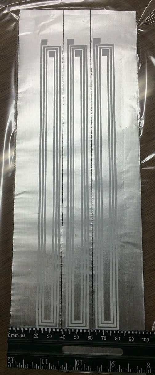

I have cut this with my "Silhouette Portrait"
If you post a drawing of your membrane with a Height or Width measure in mm.,I will try to cut it to measure the resistance.

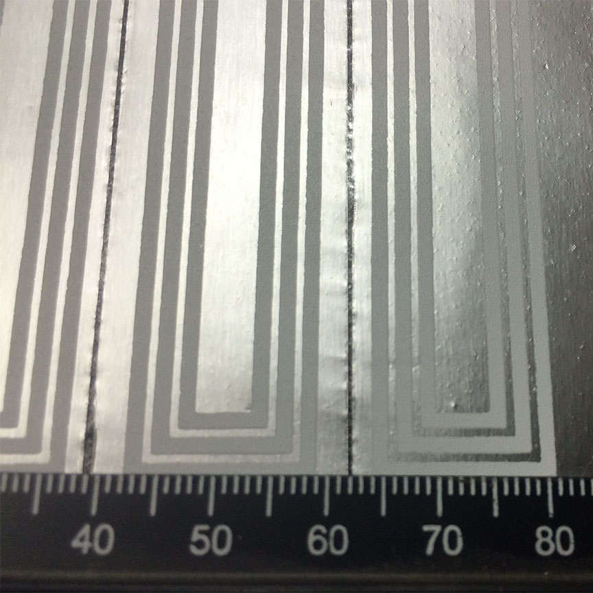

The foil is placed on a "cutting mat" 0.5mm thick plastic sprayed with 3M remount glue.
The ruler on the Picture shows centimeters.
Gap is app. 1mm.
The cutter has a program to trace the lines ,so a good Picture in JPEG is enough.Sketchup Picture better.
Gap is app. 1mm.
