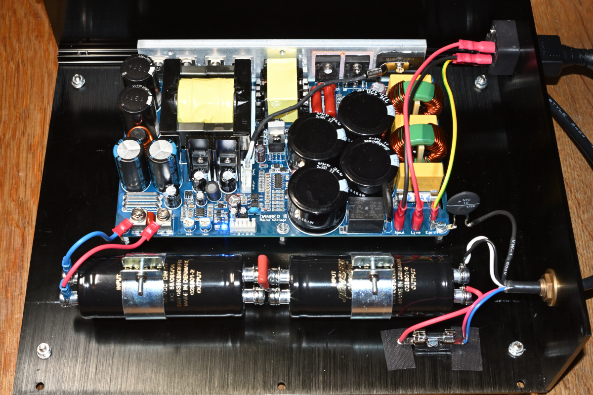

The new SMPS module arrived after two months last week and I then built the module into a chassis and added a couple of filter caps at the output (4-poles) as you can see. It reduced the ripple noise a bit (from 9 to 6 mV when just measured using a DMM).
Also added an output fuse (4A F) and in IEC inlet there is a 1A T fuse to avoid any disaster from the 2 kW module. Without additional heatsinking it run about 62 C where it is hottest (when loading amp (3.2A)). The thermal fuse kicks-in at about 90C according to spec. So I think it is ok to let it run "as is". When chassis is closed it will probably be a little "hotter". I guess it is ok as I measured the temp direct at component side. Heatsink is a bit cooler. Module has soft start both at input and output and has no problems with the filter caps.
But noise problem is still there. I get these "noise bursts" from time to time (20 mV when it peaks) at speaker out. Other times it is 0.0 mV and can be that for at long time. Other channel is always 0.0 mV AC.

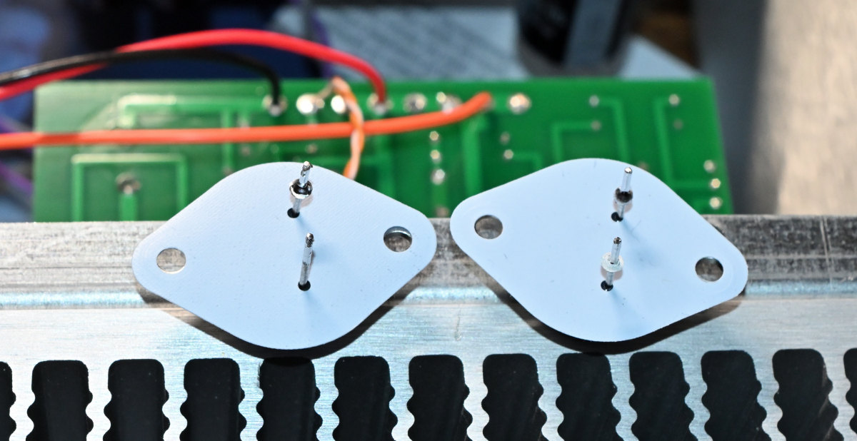

I made the big decision to de-solder VFETs and swap them. Until now only de-soldered and as you can see three solder pads also came off. But I assume these are "stand-alone" and it will only make it easier to de-solder next time 🙂 ...still one pad in place....
I need to clean the TO-3 PINs and insert again. I have marked the "suspicious" one 🙂
Correction.....it was solder only on pins (no pads). So it was easy to clean.
I used hot-air to de-solder and it went rather smooth.

Noise problem has now moved from right to left channel. So one of the VFETs makes these "noise bursts" from time to time.
