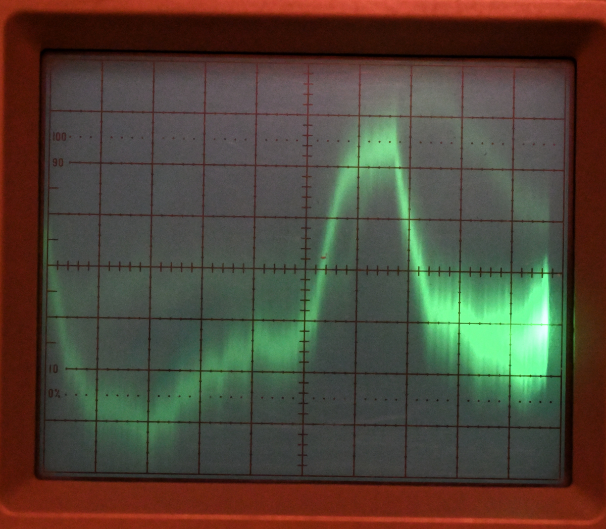

What I see on scope on both channels is that ground noise looks the same. I measure at 1mV/div with X1 probe. Probe probably picks up also from environment as I see 2mV pp high frequency noise.....or so.
Difference is that L-channel.....the horizontal midline is of signal is stable while R-channel the signal jumps up and down (very random).....lets us say.....1-2 mV and this fits with the "clicking" or "poping" noise I hear with ear close to units.

I have tried to make a small MP4 video showing the difference between my L and R channel. The "ground noise" is the same but the low frequency jumping up and down of the signal you see is the difference. These jumping up and down is heard as the "cracks" or "pops" with ear close to tweeter and it is also audible in mid-range. Something I have never been used to hear.
Measurements are with shorted input and sensitivity is 1mv/div. So "jumps" are about 1mV which is audible in 94 dB speakers. 3-4 mV RMS noise is audible at listening position 3m away.
Next component to change is as far as I remember the optocoupler. But could a bad one cause this kind of noise?

If I measure on L-channel the jumping up and down is a least 10 times less.

I can add that something we hit a "storm" and then the "jumps" are 3-4 mV and signal almost jumps out at screen. And then suddenly it is almost silent......
It is not a bad connection.....this has been checked and solder joints re-flowed etc....so I don't want to discuss bad connections 🙂 .....only if is it inside a device. Have also verified that it is not the FE-board.....

I slowed down the sweep to 20 ms pr. cm and captured one of the "jumps". Sensitivity is still 1mV/div.
So here you can see a "pop".....or "crack".....
What is the origin of this?
If it is the VFET itself I might "chill" a bit...... 🙂
