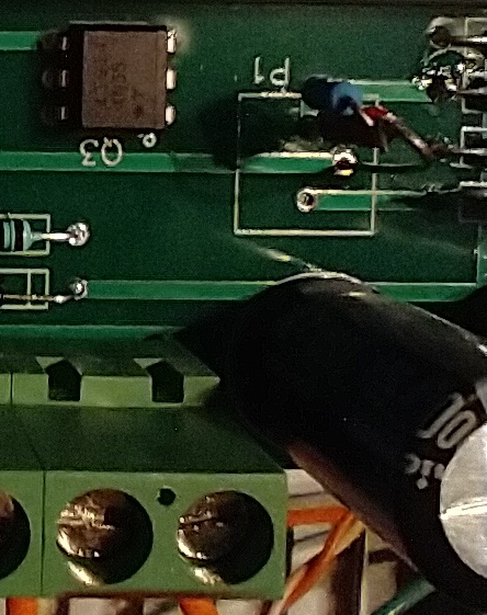

I have started the small academic exercise to verify if the 25k Bourns trimmer is the root cause of a very small amount of on/off noise in R-channel. It is academic because it is only audible with ear very close to tweeter. But L-channel is almost 100% "dead" and could be nice to achieve this also for R-channel. While new 25k trimmers are on the way I did the removal of the old and also I measured a value for a R1 and R2 resistor if I should want to try this out and use fixed resistors insted.
The removal went very smooth. I used a smd hot air gun I got long time ago. A hobby version (Velleman brand). But it worked perfect. I adjusted the temperature to 390 C and set airflow to medium. After 10 sec. or so heat up I could pull out the trimmer.
I measured 3 resistor values (R1: 10k80, R2: 12k52 and R3: 23k30 (check value). I miss 20 ohm somewhere.....
I guess if I had a 12k5 and a 10k8 resistor I was good to go but I don't have these values. But it looks very close to some standard values.
I suspect the trimmer is the problem as it creates noise by just the slightest touch of the trimmer screw. But time will show......
23k3 is quite far away from 25k but within the 10% tolerance. So maybe you guys out there has a 23k in one channel and 27k in other channel? 🙂

I got new 25k trimmers today (10 pcs).
They measured from 22k9 to 24k2.
I selected a 23k3 trimmer like the one I pulled out and installed the new trimmer.
Until now I have same constant very low noise level in both tweeters. So until now it behaves as I hoped. Amp can also play nice music.
I will check over several days if it still "behaves".....or I should just relax now and enjoy some music.....
If anyone would like to try the old 25k trimmer I will be happy to ship it.....to someone.....it looks very nice with thin straight trimmed legs.....
