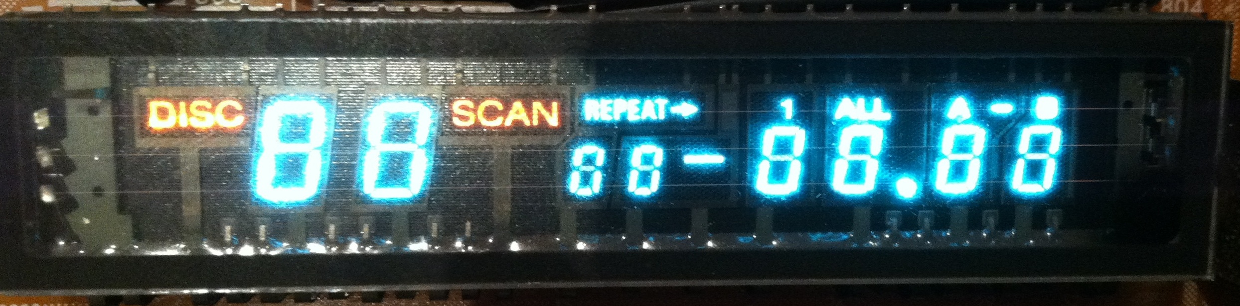

Long story short: I had to match the VFD circuitry from a Sony CDP-103 to a CDP-502. Both players are from the same age and share the same mechanism controls. All connections, voltages, measurements on the scope (like clock cycles) seem to be o.k., as described in the service manuals.
But all segments of the VFD are illuminated. One can observe this in the beginning of the video.
When the player is switched on, all segments are illuminated from the first second.(But they should be black)
Then, there is additional brightness added to the segments that are "corectly" illuminated. (Like display of time etc.)
So data is displayed correctly, but somehow the segments do not become black where/when they should be.

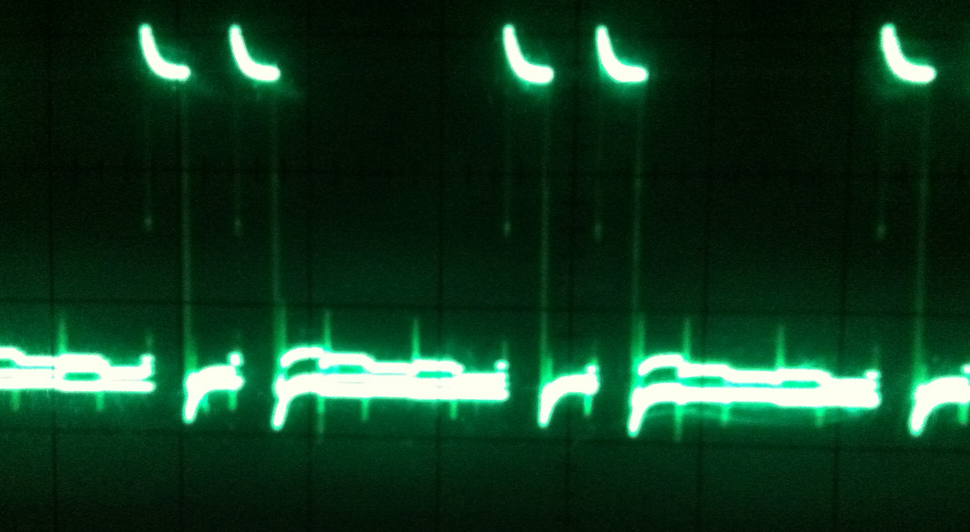

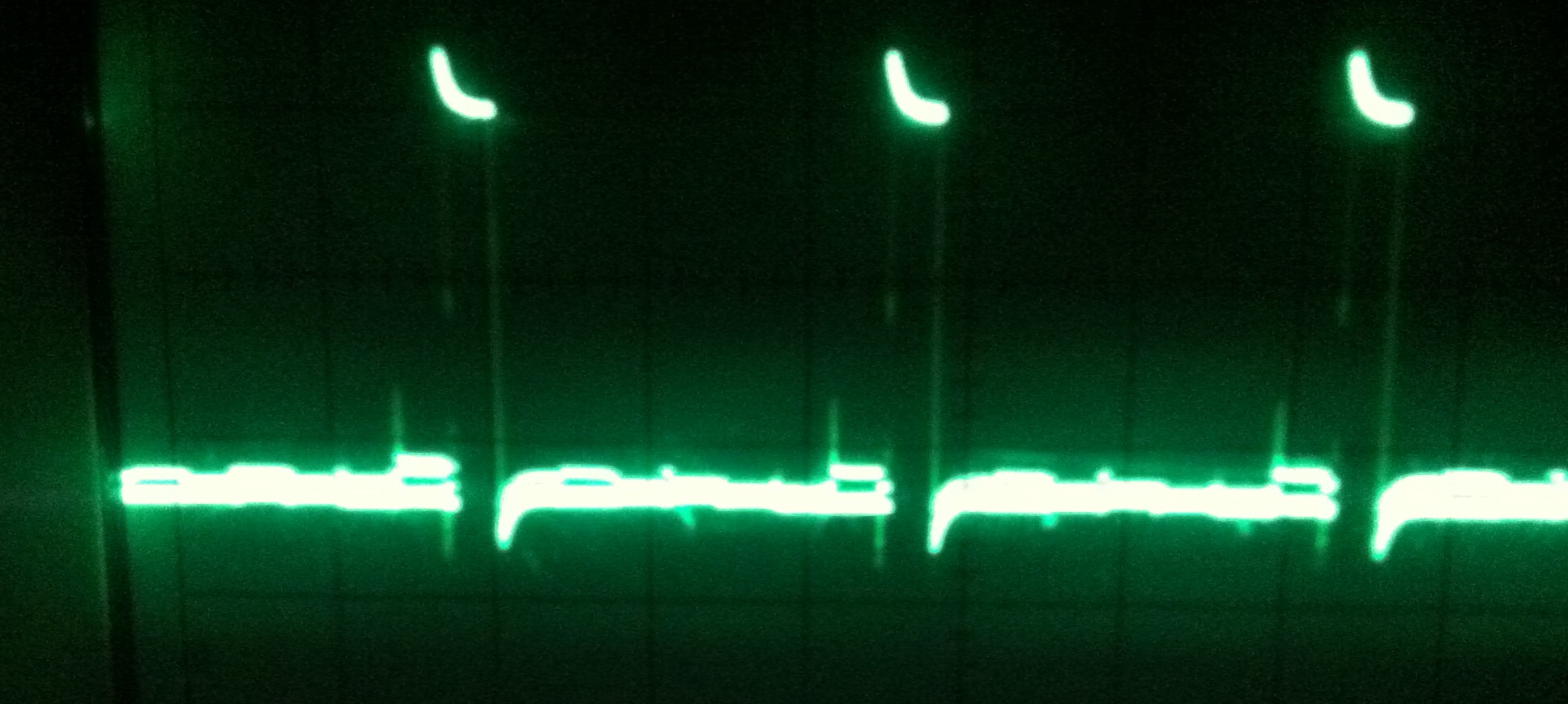

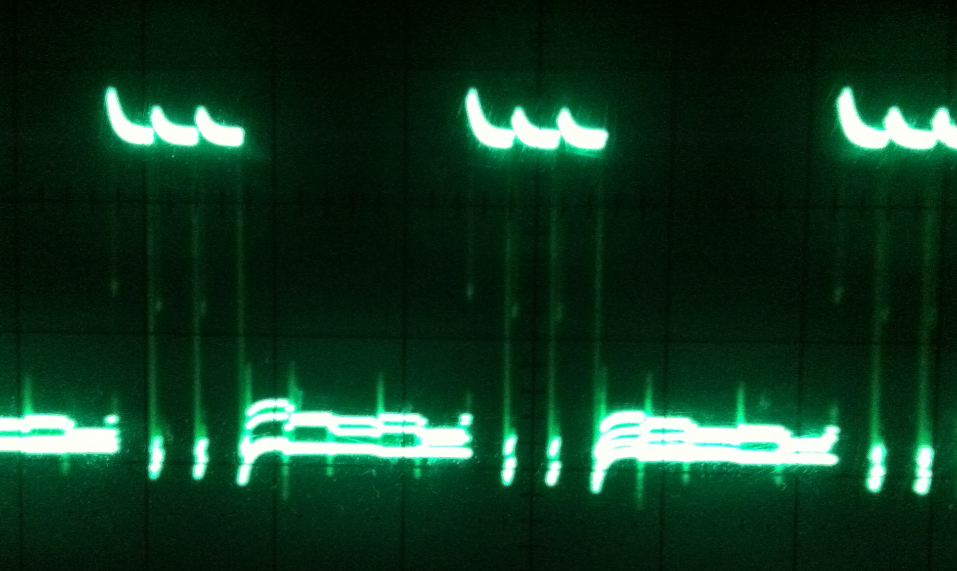

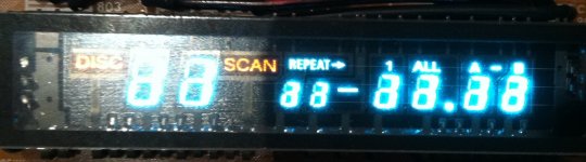

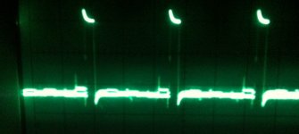

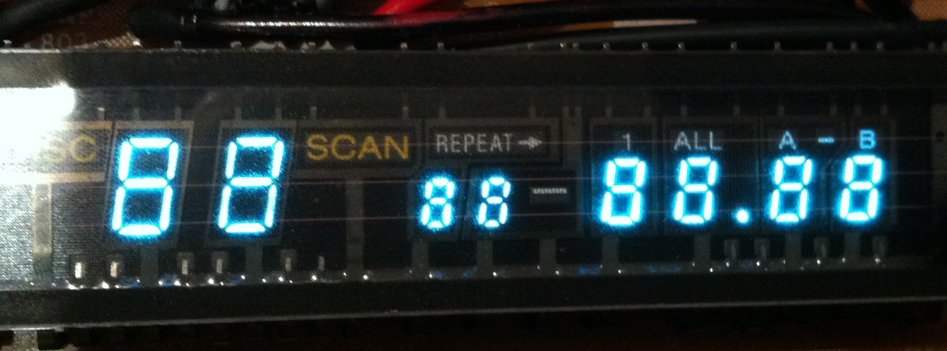

Hi Chris!
I did. I have no experience, but the signal for the segment driver looks noisy.
Some photos, I hope they will be attached in the correct order:
They show the display and the corresponding scope signal, around 1ms and 20V.
The scope signal was taken from segment "a" only (Pin 30 of the VFD)
1) Display during stop.
2) Scope during stop
3) Display during play (Hard to see, some segments are now brighter)
4+5) Scope during play.
6) The display with +32V supply voltage removed from the VFD-Drive.
The segments "a" to "g" (for the digits) are still lit, but not the segment h(For the
typos like "Disc" "Scan" etc. I assume nothing should be lit, as long as the VFD drive gets its +5V supply only?
7) Excerpt from the service manual of the CDP-103 from which the complete circuitry, master control, VFD drive and SIRCS decoder, are taken. Besides the noisy
segment signals, all other measurements seem ok according to the service manual. Voltages, also the noisy ones, are correct.
Also pushing the two skip buttons distorts the display. They are, like all other buttons, attached to the multiplexing signal.

So there must be something I might have overseen, but I checked all connections several times. Also, besides that there is an Inverter for the reset Signal, all connections are direct. Besides the fact that one might mix up Connections, everything is pretty straightforward.
I also assume that the IDP signal for the data Display is not based on the fact wethet the Drivers for the symols and gatters are have a negative or positive suplppy voltage.
In all chip-variations I tried, some flickering can be seen.
Also all digits are lit up when powering on, they should be black during the
first 1.5 seconds of powering up 😕
