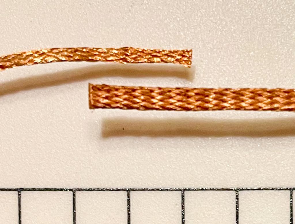

Success! 👍 I got some new solder wick today and tried it out right away. It's 1mm wide and brand new and shiny.
Here it is compared to what I was using.
I coated the wick in flux paste and it pulled the solder right off the traces, not trouble at all. The new solder sucker pump was much too large to do the job, but the thin new wick worked like a champ. Here are the cleaned up traces. Now I can work on the repair proper, bridging the crack with fine strands of wire.
Thanks to everyone in this thread for your help and advice.

Sometimes the problem is that with this new silver based solder (lead based not allowed) solder wicker is not wicking it up. I normally flood it with lead based solder and then use a very good brand solder wick. Not all solder wick works and there is a lot of counterfeit around: Know where you getting your solderwick from. And thinner is better. When using solderwick I often start an inch or even two from the end and then slowly pull the wick across once it is absorbing the solder. I much prefer solderwick to a solder sucker.

The solder sucker I just bought has he silicone tube tip, and replacements. I've never had one of those before. But in this case the 1mm wick did the trick.

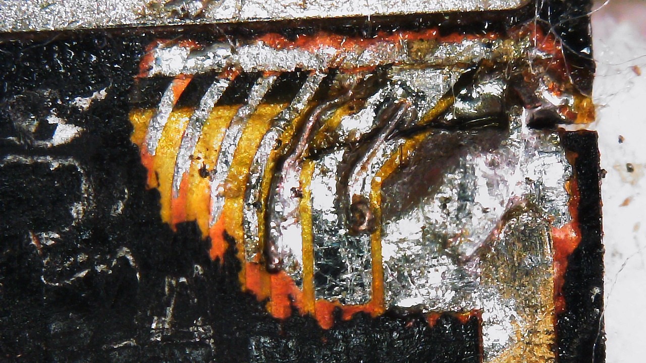

I did manage to bridge the ribbon crack with fine strands of wire. Took some effort, I'm not used to working at this scale, and it's been years since I did SMD work. Not pretty, but fingers crossed it will work. The tracks repaired are; ground, V+, ground. The thin unbroken tracks on the left are LED return lines.
Tomorrow will be more flux cleanup, cotton strand removal and reinforcing the ribbon from behind with some thin plastic taken from the solder sucker package. I don't want it to bend and crack again. 😀

Well, anything smaller than 1206 is a pain. And I have steady hands, and a stereo inspection microscope.

Are you going to drop some epoxy on it to reduce flexing?

Maybe epoxy. It does have to bend some - so I was thinking thin plastic glued on the back side. There is a second one that hasn't cracked yet so I'll stiffen it with plastic to prevent a severe bend and crack.
This certainly showed me how much a stereo microscope would be nice. Not having depth perception made this even clumsier than it already was. I truly did not think I could do it. Surprised that I got it done, it seemed near impossible with my skills.

Try hot glue to stiffen the cable, it is pretty hard to bond the polyester sheet used in flex cables.
If you have a vehicle sticker / reflective sheeting, the adhesive on those is very good, and suitable for many substrates. Should work on polyester.

There was no solder there to begin with, it's a ribbon cable. so I added the solder for the repair. Solder is classic Tin/LeadSometimes the problem is that with this new silver based solder (lead based not allowed) solder wicker is not wicking it up.
Solder is Kester SN63PB37 0.02" diameter.
