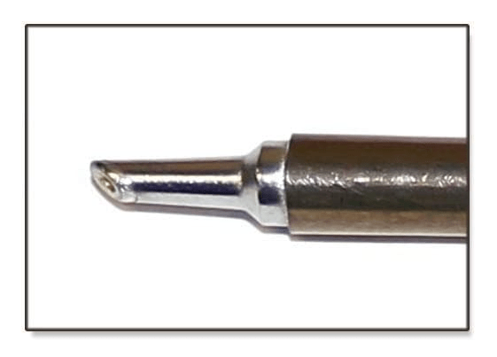

Well I have spent hours with an Xacto knife trying to move the solder off the traces. It won’t budge. I haven’t tried quite the techniques you described.
I have ordered some very fine solder wick and am still attempting to make a very fine solder sucker. This repair is beginning to look like it is beyond my capabilities.
Do you have a hot air station? Using a small (reduction) nozzle and at high speed you can try to blow it away, I`ve done this accidentally.
Alas, no hot air station. Used to have one, wish I still - did as I think it would work like you said.
Get a heat gun...overgrown hair dryer, it was used here before hot air stations were available.

1. Flux. use generous amount of flux, a lot of it. Literarily pile the flux up on the job. there is no such thing as using too much flux. The excess can be easily washed off with propyl alcohol after. What breaks the bridges is the surface tension of the molten solder, and surface tension is best encouraged by flux. Keep the job wetted, very wet!
2. Tip. if braid wire does not work well, try a soldering tip with concave working surface, like this one
or DIY a concave tip by grinding a cavity on the flat tip surface with a Demel tool. This cavity would pick up a small amount of solder from the job, then be emptied by wiping on a damp sponge prior to next attempt. Soldering tip must maintain well tinned and without oxidation.
3. Temperature. Maintain the tip temperature in range of 325C-350C for leaded solder jobs.
Oh there were great globs of flux all over everything. 😀 That darn solder just does not want to leave its happy home.
I had forgotten about the concave iron tip. Haven't seen one in years. Worth a try!
