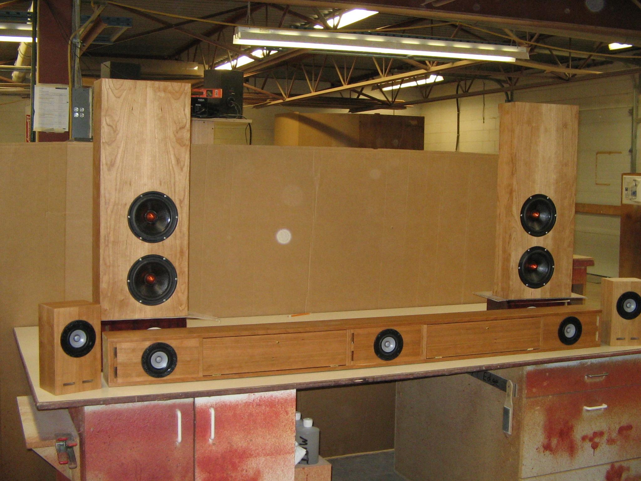

I have used the (no longer available) SDX7 in slim woofer boxes. Designed such that when wall mounted they would not extend beyond the front of his TV. The wife objected when he got them and they were used behind the couch. With a touch of EQ they are happy to 25 Hz or so sealed. You won’t get 2 in a slim box push-push thou.
Visaton KT100V — you miight be happy with sealed and some EQ but a vented box can get below 30 F6, below mid 20s F10 (12 litres per driver). No xMax given so only a guess as to when you’d run out of steam. At 80 dB sensitivity it is clear they have really pushed the Fs down for such a small woofer. At least 6 per side is a wild guess at how many would be needed, but that depends on how loud you need. Ignoring material thickness (loaded push-push 15mm quality plywood should be suffiicient 9maybe even 12mm), a depth of about 12 cm should be doable.
dave
