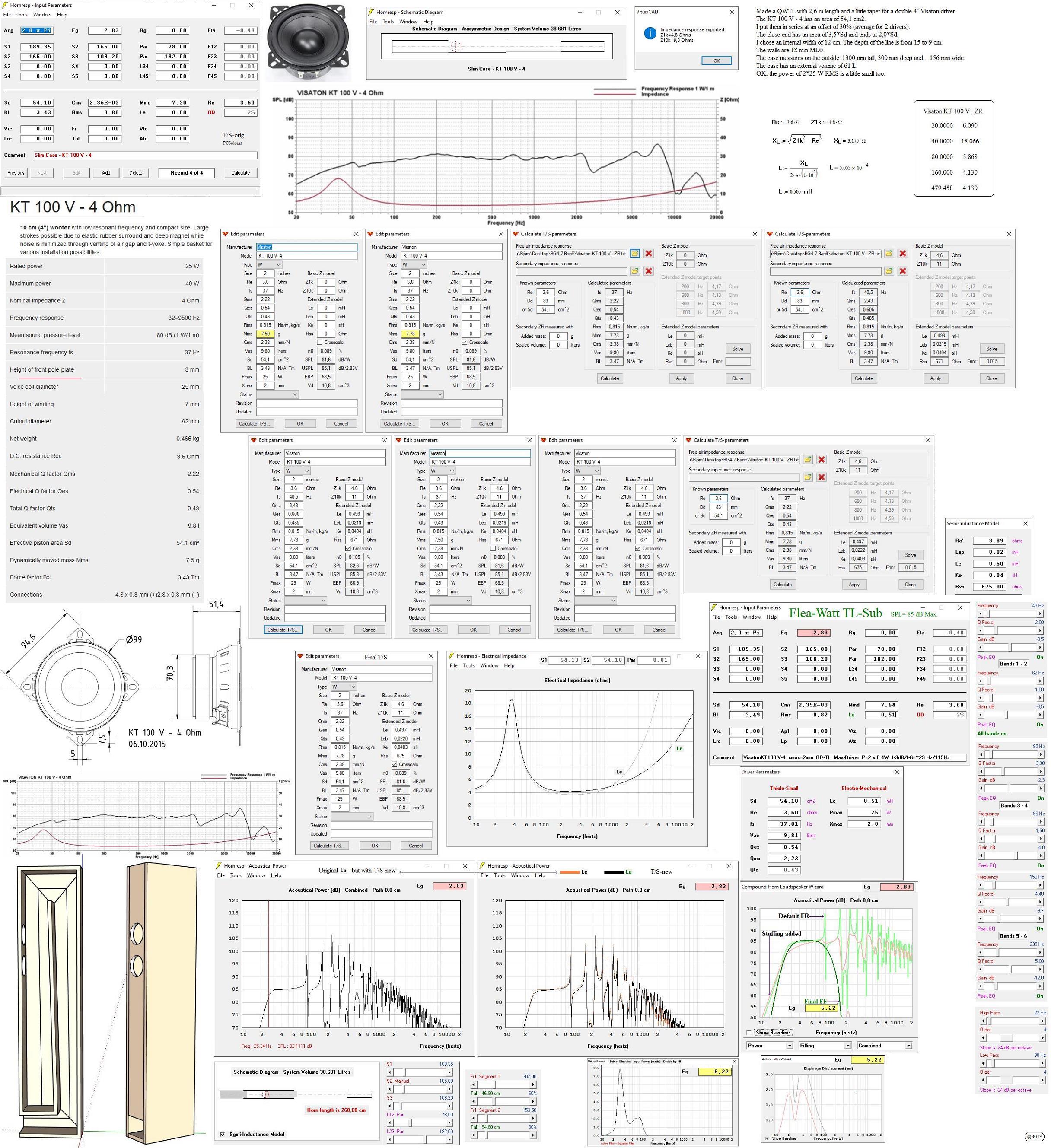

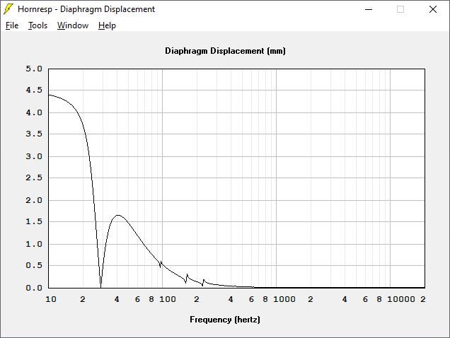

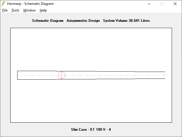

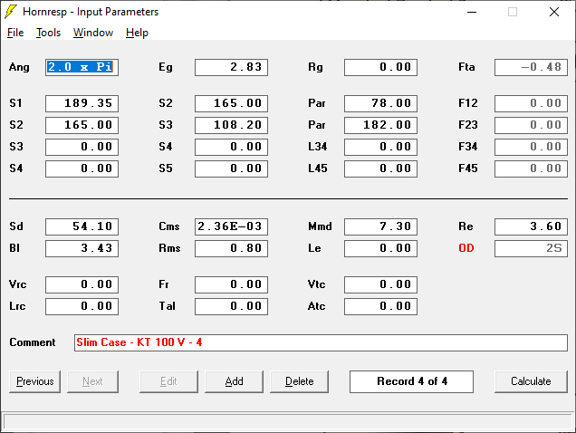

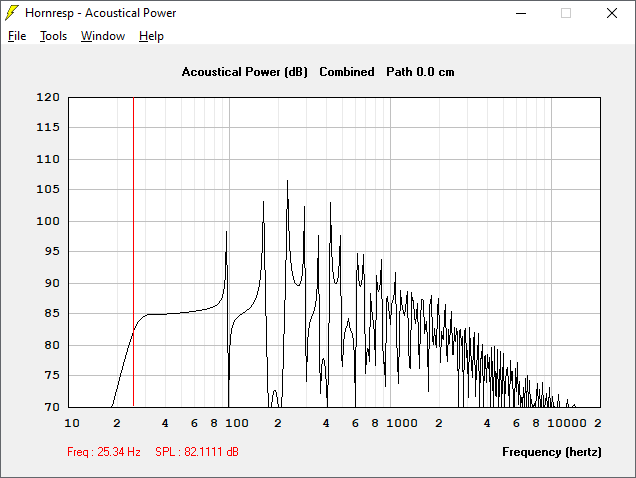

Hi PCSoldaat,
You published a couple of non-closing Simulations= Results (after hitting the Calculate button) that tell almost nothing about what you are aiming at when not providing important information, I.e all other possible Screen Plots (+ the underlying ones that are all essential when clarifying the Results and making interpretation of your Design possible).
But One was a Posting of Transfer Function Plot = 'narrow bag - horn response 4.png' at Eg = 2.83 V Rms.
So, I just increased the Voltage to 3.58 V(= ~0.82W/Driver) as this Voltage makes the Excursion to reach 2mm at ~ 40 Hz.
Then if a Power Amp using 2 x 2 V Rms= 4V Rms, a margin of ~20 x log (4/ 3.58)= ~0.96 dB occurs or ~ +1 dB Voltage handling margin for the Power Amp, of course a minimum Head-Room but IMO enough if using this Power Amp.
You're mentioned a 2 x 25 W Amp to be ‘ little to small’ but is way to capable as the Eg margin will be 20 x log (14.14//3.58)= ~11.93 dB enough to push the displacement to +- 8 mm at 40 Hz I.e. if you toying carelessly with the Power Amp Volume Control.
b 🙂
PS: My Picture: I added Semi Inductance Parameters but everything else is from HR besides the Calculation of Le 1k that was taken from the provided Driver Impedance Plot.

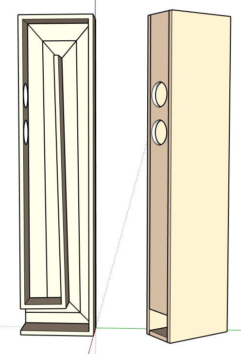

...and mount the driver(s) on the left and right sides...
Worth emphasizing. Anytime you use more than 1 woofer in a box, mounting them push-push and tightly coupling them has tremendous benefits in terms of reducing box load (dramatically) due to active reactive force cancelation.
As long as the drivers go low, and you have lots of width and height, and you can fit the drivers into the box, you can get whatever volume is required. Volume is the key box aspect that determines how low it can go.
I have used the (no longer available) SDX7 in slim woofer boxes. Designed such that when wall mounted they would not extend beyond the front of his TV. The wife objected when he got them and they were used behind the couch. With a touch of EQ they are happy to 25 Hz or so sealed. You won’t get 2 in a slim box push-push thou.
attachment.php
Visaton KT100V — you miight be happy with sealed and some EQ but a vented box can get below 30 F6, below mid 20s F10 (12 litres per driver). No xMax given so only a guess as to when you’d run out of steam. At 80 dB sensitivity it is clear they have really pushed the Fs down for such a small woofer. At least 6 per side is a wild guess at how many would be needed, but that depends on how loud you need. Ignoring material thickness (loaded push-push 15mm quality plywood should be suffiicient 9maybe even 12mm), a depth of about 12 cm should be doable.
