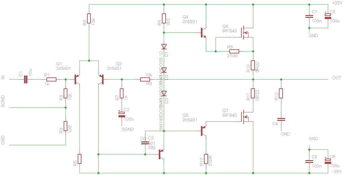

Hi , i posted a comment and you recomanded me to build the first schematic at post no1
this one:
Mooly said : Q3 actually needs to be an NPN
kasey197: " two initial comments:
biasing for Q5 looks dodgy - missing a resistor i think.
Q3 needs to be fed from junction of Q1 and R5 - looks like a typo. "
so i need to change q3 to be npn and it works ?

Ranchu LTSpice Analysis
Hi Folks,
I have put the Ranchu QUASI through LTSpice, and some of the findings are in the schematic attached.
A few issues:
1. Gain is modified by R5 68k and is 22.1, which is 26.9dB.
2. On the schemat I have deleted the input offset network for simplicity, which would normally be on the real circuit as shown on Ranchu's schemat. I have inserted the offset into the source heading.
3. I have tagged a few actual (simulated) values to give some idea of current and voltage in critical areas around the circuit. They have 7 sig figs, which is of course the ideal. In reality it won't be measured that well and there will be variations due to component imperfects and tolerances.
4. I have kept lag comp as C4 (33pF) but added the feedback shunt C11 (68pF) while dropping the bypass across R5 68k. I have added a Miller cap across base/collector on Q5, the phase inverter. All this flattens the gain structure (it was toppy, dangerous for stability and ringing) and ensures the net gain is below unit at the frequency where phase shift is 180 degrees (where the negative feedback turns nasty into positive feedback, creating a destructive oscillator).
5. These tiny pF caps used in compensation are very difficult to predict with math and simulators. The badly affect the sound quality too, so the best option is to try it on a real amp and have a listen. If you have done it a few times, you develop a sense of under comp, or over comp. Once you are ready, you try it with a few caps across an 8R resistor load. The most difficult combination if 100nF//8R.
6. Notwithstanding, I do not say this is the correct combination of compensation caps. It's a start, there are no definitive answers unless you actually DO it.
7. This amp has very good harmonic profile. H2 is high at 12.5W into 8R; it's at -70dB, and H4 is around -84dB. H5 is well below -100dB, which is very good - no machine tones, very warmish and engaging. Recommended.
Thimios, I hope this helps, and directs your efforts to polish this lovely little amplifier! Thank you for your hard work, I'm just the remote fanatic!
Hugh

Thank you , but why does it use a mosfet and a bjt ? and not two mosfets ?

Bruno,
A few good reasons:
1. Better harmonic profile.
2. Higher output from the design rail voltage.
3. Cheap build, good npn and nmos are inexpensive.
4. Non-conformism. People think it will never work, but it's fabulous.
5. Hybrids rule!!
Hugh
