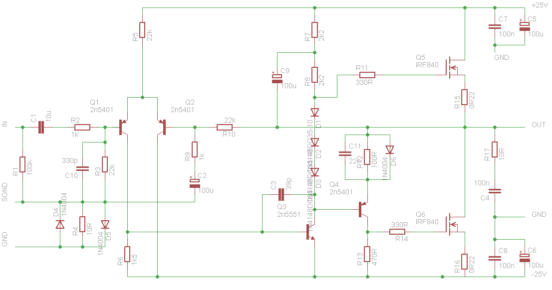

Gee, this is very odd....... I will go back to my LTSpice, I suspect we need to put in 47p across C to B on the phase inverter..... Damn.........

Now, we should get back to Thimios' QUASI. How is it with a 47pF on the C to B of the phase inverter? Fix it?

Testing this amplifier again i can't see the instability.
Can you advice me to a stability test? What is the maximum capacitance pareallel to dummy load where amplifier must be stable?
I prefer not to instal this capacitor yet.
I want to repeat test and see scopes.Something is strange with this amplifier.
Did you had the time to look this in Ltspice?
At what output level,square wave or sinusoidal ,what frequency?😉thimios, you could try 1uF in parallel with a 8R dummy load.
Go through a range of capacitor from 1nF to 1uF. Remember that ringing of the cap loading through the output inductor is a necessary and unavoidable result.
This test either needs to ignore that ringing or omit the inductor from the test.
It is the amplifier stability margins that you are wanting to examine not the ringing of a C+L load.
You also need a fairly fast, but not instantaneous, step in current/voltage as the test signal. This usually requires that the input filter needs to be crippled/removed/adjusted to pass a fast transient. I typically change the 0.7us input filter to 70ns time constant to see the effect of fast transients. The generator has a 50ohm output and the 1k0 input resistor gets changed to 51r//1k for an effective 100ohms of total RC impedance, giving a 10times faster signal step.

If you have time then you should do the following 6x sine wave tests:
1. 1kHz into 10n || 8R
2. 1kHz into 100n || 8R
3. 1kHz into 1u || 8R
4. 20kHz into 10n || 8R
5. 20kHz into 100n || 8R
6. 20kHz into 1u || 8R
This is what I normally do when I'm feeling diligent and when I'm not I just grab a 1uF and test at 1kHz and 20kHz.

Thimios,
Christian's suggested regime is very good; I found most amps tend to lose it at 100nF to 220nF. 2uF I the value of an ELS63, particularly at 20KHz, it's a severe test for ESLs.
The instability is clearly coming from the inverter. I conclude that trying to keep them equal is probably not possible; I always see them different, with the Bax resistor lower than the base to rail on the quasi. Seems to me to be best at 120R Bax, and 150R quasi. I have seen 82R and 120R too.
The 22nF Bax cap is not critical and has now effect on stability. It supposedly simulates the junction capacitance of a driver, but in fact it damps any ringing on the diode as it turns on and off. The stability is always created at the collector of the inverter, and this is why a small miller cap is recommended from C to B.

Hi
There is another way to stabilize the inverter who is not using miller cap C-B.
Bax capacitor could be 390 pf?

Ok thanks,this test wil be at the max out.level?
Hi, can i build this version ? is it functionally
can i replace IRF840 with irfz44n ?
i want to try an power amp with mosfets, and i own irfz44n ( it is used in power supply i dont know if it's good in audio )
