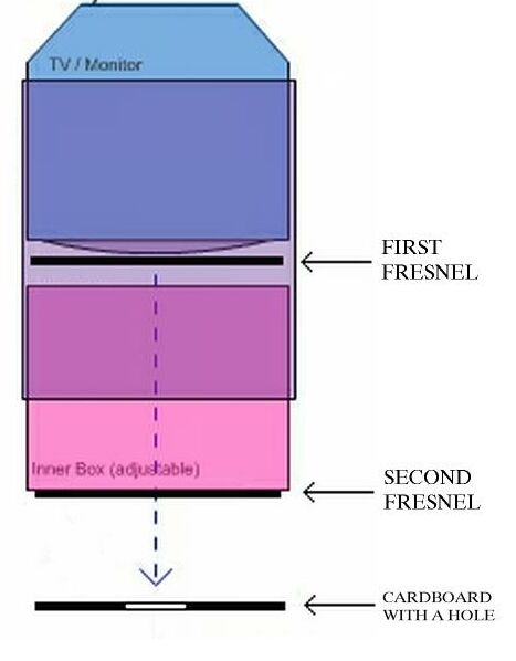

tinker, try this:

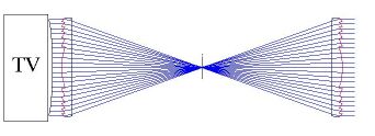

The winner,
this one can't work properly, cause the CRT is a diffuse light source, which emits light in all directions, not only parallel. So the first fresnel is hit also by lightrays at all angles. This doesn't give a collimated beam for those which are not parallel!
The condition for imaging with a lens is, the lens has to be arranged in a distance between 1 x focal lenght and 2 x focal lenght.

i know that the CRT is a diffuse light source, which emits light in all directions, not only parallel.
but, when i made my first 100inchTV, 4 inch glass lens was picking few non-parallel rays from CRT and projecting them on the wall (with good middle part of image but blurry edges).
what i mean is that you dont have to pick all the light rays in order to get good and bright image!
only parallel rays fresnel would pick up would be suficient to get good image! it would pick up those rays and project them on second lens, and that way you could get much more light then i did with my original concept.
and anoteh thought was that first fresnel would correct problem with edges! back on the greenspun board one guy suggestd to put peace of glass in front of CRT, and to focus lens on the glass, not on CRT. that way lens would project image from FLAT glass instead of COURVED CRT!
first fresnel would do the same thing, and gather more light!
ofcourse, you would have to put lenses in black box, and to put diaphragm (i am not shure how to spell it) - i mean peace of cardboard with small hole in middle of it - between the fresnels. that way only correctly projected rays from first fresnel would hit the second one.
i tried it with two 4 inch glass lenses (i placed peace of cardboard with 4 inch hole and 4 inch lens in the middle of it in front of the screen), and it worked great!

the whinner- I tried that combination you showed but with two fresnels. It doesnt work. The best I got was a blurry screen. I put the first fresnel in one end of focus box and then put the hole cut in cardboard piece 12" down the box (this is the focal length of fresenls I have) then the second fresnel at other end of focus box which was 24" long. Seems to be over magnified. But I'm thinking a regular magnifing lens first then fresnel second maybe the right combination. The blurrieness must have somthing to do with how the fresnel is- vs. a magnifying lens. Still not giving up. A tv is very bright compared to a light bulb and there must be some way to use that light. So much is going waisted and this is the problem. A very large fresnel on a 30" tv would prob. be the best, but I cant find a fresnel any larger than a page magnifier yet. If I do I'll be very happy.🙁

put the first fresnel in front of CRT and FIX IT there! it is not supposed to move!
put the second one on the box and move it until you get the image!
after that, put the cardboard with a hole in front of the apperature, it will cut off the light that defracted wrong, and it will clear the picture! later you can fix it inside the box, after you determine all the distances!
you can use other lens (glass etc.) instead of second fresnel, but not instead of first one!
look at this as OHP with the CRT instead of glass plate!
and DO NOT use the fresnel from OHP, it is two lenses glued together! fresnel from OHP cant work in 100inchTV!
