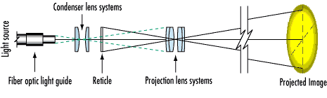

after 2 years i am stil convinsed that it is possible to build tv projector! i beleive it is all about optics!
i think that all wee need is appropriate lens(es)!
take a look at this diagram from edmund optics!
http://www.jersey.net/~edsci/techsup/Dia1.gif
(you can see it on the bottom of this post too)
i think if we take the right side of this apperature (second half of condenser lens and magnifying achromat - without the reticle) and place it in front of TV we can do it! instead of second condenser lens we can use full page magnifier (which is as big as 13" TV or 14" monitor and can cover whole screen) to collect all the light and beam it to the magnifying lens. since page magnifier has chromatic aberation, maybe second page magnifier used as magnifying lens could correct that aberation. or we could use OHP head as magnifing lens.
the second approach would be using only the lens from opaque projector. it has appropriate focal length to pick up and project big image (its stage is usualy over 12"x12"), and the lens itself is much bigger than OHP lens, so it would give much brighter image on the wall. i tried OHP head with my 100inchTV (without the fresnel) and picture was perfect, only pale, becouse there was not enough light since OHP lens is small and cant put enough light through itself.
besides, using opaque projector lens, instead of OHP lens, with LCD projector panel should also give you much brighter image (same reason - bigger lens passes more light), and therefore you can use less powerfull light source.
one more thing!
most opaques uses 2 light souces simultaniously, and than projects light that bounced from projecting material (paper, book, photograph,etc.). does it means that opaques dont use fresnels, and that opaque projector lens can project image from non-pointlike light source? i dont know! if so, that would mean that with such lens you could use non-pointlike light source in your LCD based projector?
