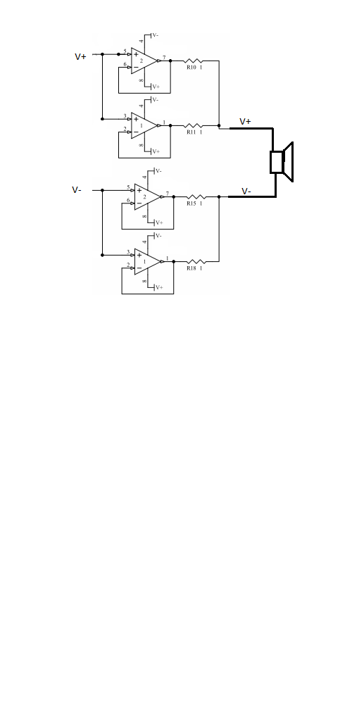

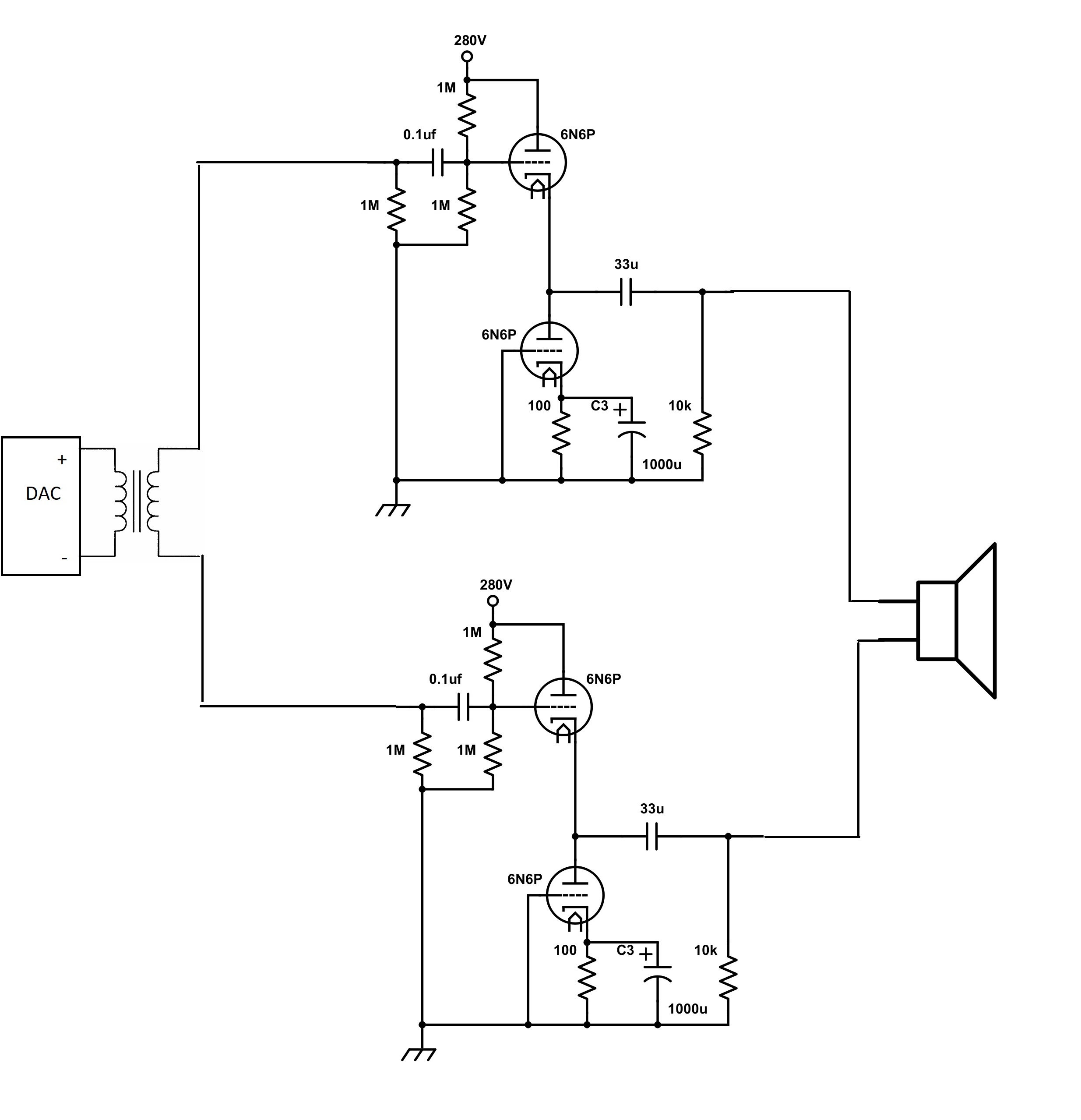

perhaps the attached will give clearer idea what I was trying to convey with that schematic, how the 2 amps would be connected for balanced drive.
and what the result would be if the 0.1uf input caps (and preceding 1M resistor) were removed.
What's the point in balanced drive?
It is "bridged", actually. Used when the amp can not output enough voltage swing due to limitations of a battery voltage. Twice higher voltage, with the same load impedance output current of each half-amp is twice higher, so output power is 4 times higher.
The point as you say is 4 times the power, or realistically 2 times the power with the same headphones. also making it possible to omit output caps by balancing voltage on the output evenly.
Most importantly my experience using 2 different SE SS amps in bridged configurations was that they sounded a lot better.
In one of these cases the SE SS amp was based paralleling op amps to increase output current. To bridge this amp I halved the op amps per channel instead of doubling them, so power output did not really increase but this implementation still sounded far better bridged, example, the OPA1622 used were running on 17V supply.
With high impedance HPs the tubes would still be dealing with reasonable loads when bridged I think, but still the output impedance is a bigger obstacle with OTL than the SS amps.

I can see that there isnt much point doing this as the result will most likely be disappointing, im mostly concerned about lack of power. It would make more sense to stay single ended and add the extra tubes in parallel, eliminating output caps is more of a novelty compared to lowering output impedance. Also it would need some kind of DC protection and then things become over-complicated.
For output caps, instead of some boutique caps these KEMET DC Link are probably nearly as good (still far better than any electrolytic) and very good value. I used these before in a power supply and notice they have pure copper leads instead of copper clad steel like a lot of general purpose polypropylene caps
The point as you say is 4 times the power, or realistically 2 times the power with the same headphones. also making it possible to omit output caps ....
With tubes into low-Z loads, we are often *current* limited. Then the bridge-mode power is the *same*.
What we'd usually turn to is Parallel mode.
Yes, paralleling does not semi-cancel 2nd distortion. And does not eliminate output caps, though _I_ would be very dubious about any two tubes matching close-enough not to damage headphones (especially at turn-on/turn-of).

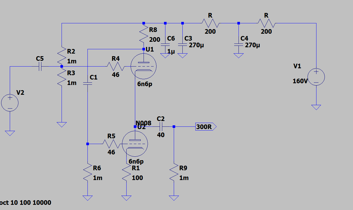

Its been a while but im finally getting around to putting this amp/buffer together...
This design is white cathode follower I think.
You get both lower output impedance and higher output current with this configuration, its what the schitt valhalla 2 employs and that is known to be one of the more neutral and ''SS-like'' tube amps you can buy.
Power supply will be linear using 115 x 2 transformer... The tricky part is managing supply voltage, I will either need HV regs to burn off nearly 50VDC at 230VAC or run tubes at lower voltage with basic cap multiplier at 115VAC.
I assume higher voltage is best for SQ, output current headroom decreases as voltage goes down, are there more reasons for running higher voltages?
Tubes could be run at 300V limit, would nearly half dissipation in regs and could bring further sound improvement with same idle current. tube life could suffer but 6n6p are dead cheap and I have 8 pairs to test longevity.
I have a 6VAC trafo for the heaters so the option for DC or AC heater supply is there, AC seems preferable to me but the possibility of hum is even greater with headphones... or maybe not with no gain. Not hard to test both

This is the amp I ended up building, a WCF and it sounds far better than expected.
I tested with and without cathode bypass cap but felt the cap really messes with the sound (hashy, gritty), 470uf were used.
May try bypassing 46r grid stoppers completely.
Dual 160V supply from 115V+115V trafo,
That CRCRC filter is enough for dead silent operation with 300ohm sennheiser.
