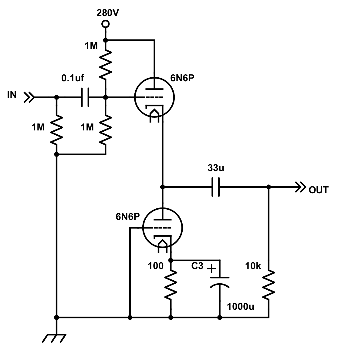

very simple class A buffer for headphones?
perhaps the attached will give clearer idea what I was trying to convey with that schematic, how the 2 amps would be connected for balanced drive.
and what the result would be if the 0.1uf input caps (and preceding 1M resistor) were removed.
The point as you say is 4 times the power, or realistically 2 times the power with the same headphones. also making it possible to omit output caps by balancing voltage on the output evenly.
Most importantly my experience using 2 different SE SS amps in bridged configurations was that they sounded a lot better.
In one of these cases the SE SS amp was based paralleling op amps to increase output current. To bridge this amp I halved the op amps per channel instead of doubling them, so power output did not really increase but this implementation still sounded far better bridged, example, the OPA1622 used were running on 17V supply.
With high impedance HPs the tubes would still be dealing with reasonable loads when bridged I think, but still the output impedance is a bigger obstacle with OTL than the SS amps.
I am not sure, only that polypropylene output caps would be about the same cost (or even more) as some resistors and a couple more tubes, which could run off the same power supply.
I can see that there isnt much point doing this as the result will most likely be disappointing, im mostly concerned about lack of power. It would make more sense to stay single ended and add the extra tubes in parallel, eliminating output caps is more of a novelty compared to lowering output impedance. Also it would need some kind of DC protection and then things become over-complicated.
For output caps, instead of some boutique caps these KEMET DC Link are probably nearly as good (still far better than any electrolytic) and very good value. I used these before in a power supply and notice they have pure copper leads instead of copper clad steel like a lot of general purpose polypropylene caps
PRR
Joined 2003
The point as you say is 4 times the power, or realistically 2 times the power with the same headphones. also making it possible to omit output caps ....
With tubes into low-Z loads, we are often *current* limited. Then the bridge-mode power is the *same*.
What we'd usually turn to is Parallel mode.
Yes, paralleling does not semi-cancel 2nd distortion. And does not eliminate output caps, though _I_ would be very dubious about any two tubes matching close-enough not to damage headphones (especially at turn-on/turn-of).
thanks for clarifying, 40mA does seem awfully low if that measured the same as an op amps output current. The op amps in a DAC's unbalancing circuit will swing at least 50mA, though not in class A and not solely as a buffer. The transparency of OTL is the most appealing thing but without power thats not worth much.

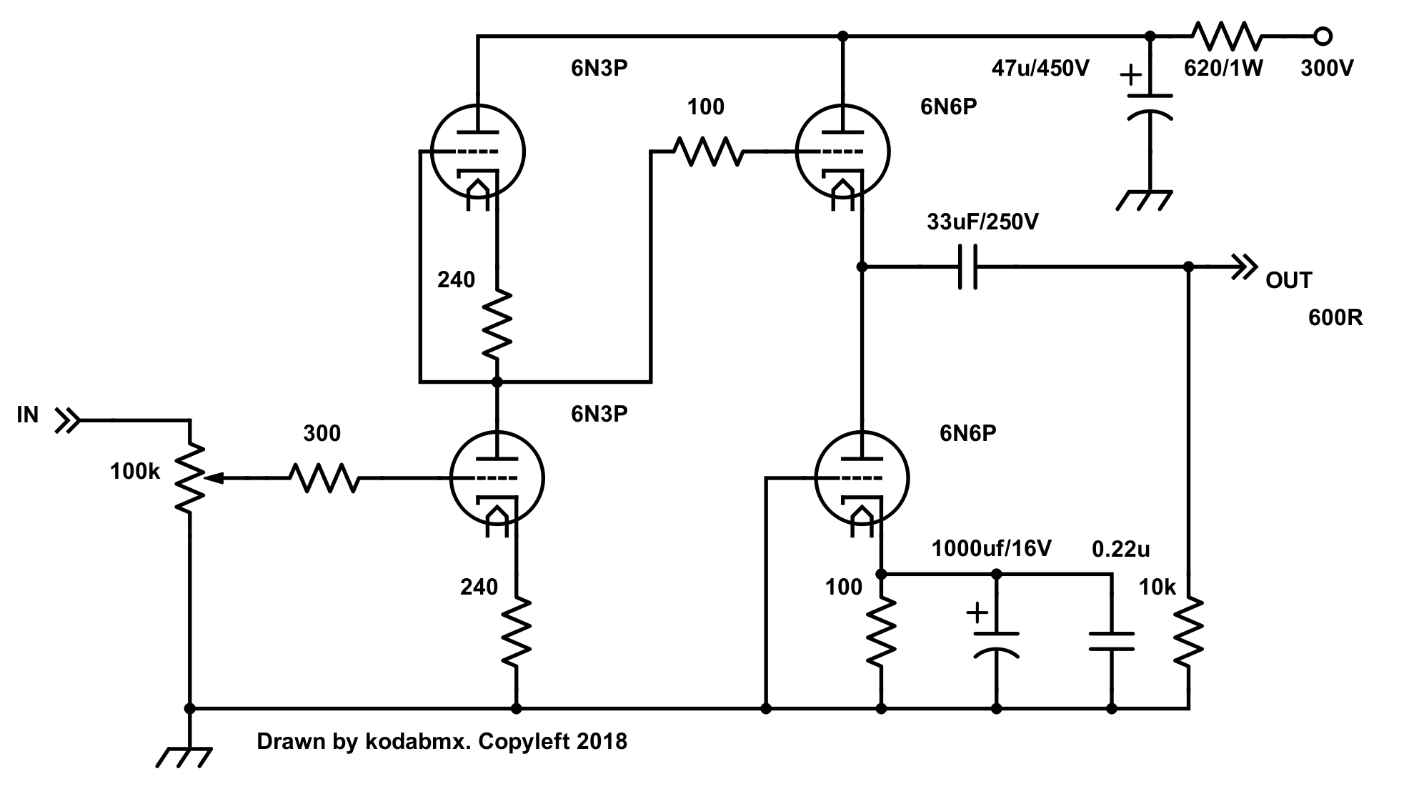

Gain is roughly 1/2 of the mu of the first tube.
The circuit can run without gain with the addition of fixed biasing... This unfortunately adds a cap.
See attached.
Add a grid stopper if you want, but I've never needed it with this circuit. Also assume the same 620R/47u filter (which was based on an SMPS, and because I had the parts already. If you use a passive power supply, use 220uF instead.

The PP version will swing 40mA :)
The Aikido-ing is removed in my version. It has good PSRR because it's actively loaded unless I'm wrong. I've never used a linear supply to power it. The fact that I'm running mine on an SMPS for heaters that also powers the boost converter and I hear no PS noise, hiss, or hash is great, but I don't expect any hum this way. In the push pull version, the "aikido-ing" is what makes it swing both ways.
The tube cad aikido can be reduced to aikido cathode follower and remain an ''aikido''.
The physical difference between the tube cad ACF and WCF circuits I can see is top triode plate resistor that allows WCF to work in push pull, increasing output current, lowers distortion and also decreases output impedance.
The ACF has ''low'' output impedance but I realised it's a relative statement, a simple CF has even lower output impedance but neither are particularly low in the context of headphone, only line level.
WCF is half that of the CF which is big step in the right direction for headphone.
