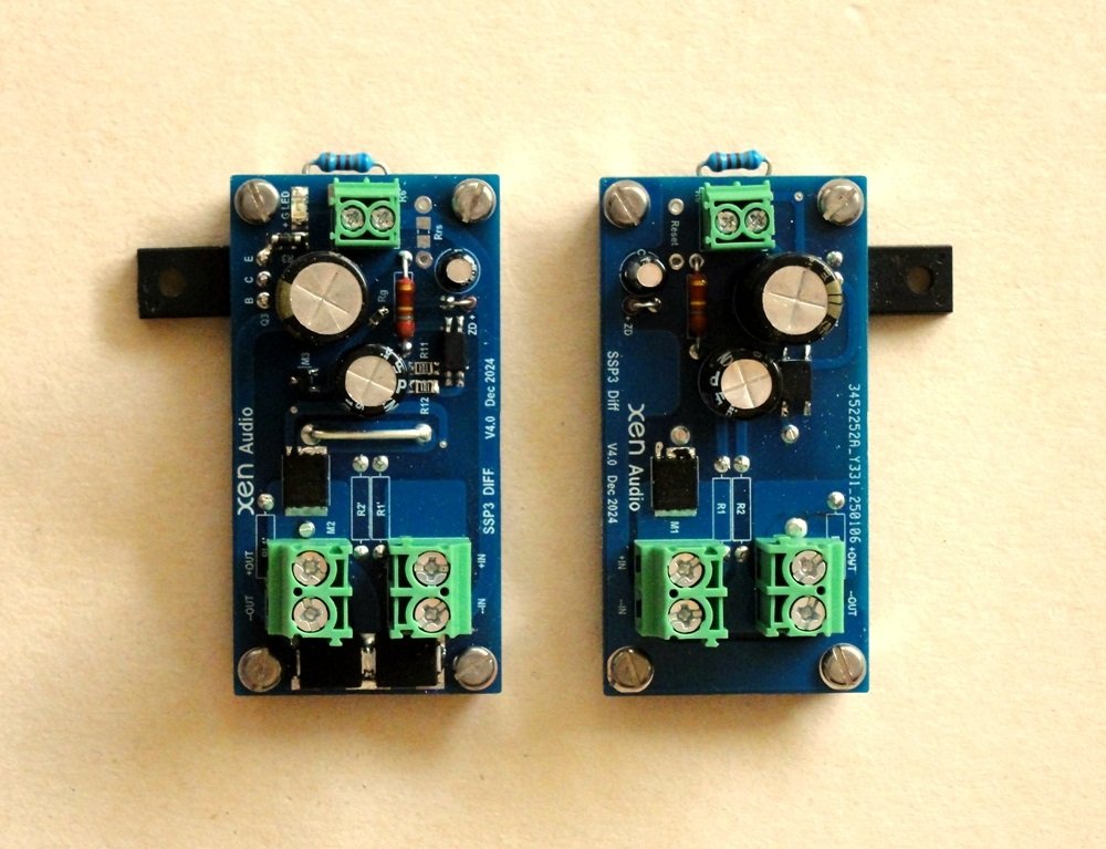

Hi all,
Testing and preparation is now complete, so the group buy is now open at
Fran
What is offered:
4x pieces of a speaker protection module as shown in the thread here:
https://www.diyaudio.com/community/...-universal-speaker-protection-circuit.415149/
enough for 2 stereo amplifiers.
Since the MOSFETs used are tricky to solder effectively at home, the boards will be provided with the MOSFETs already soldered. The rest of the parts will need to be supplied by the subscriber. They are easily available and in stock at Mouser, DK etc. The modules use SMD parts with the smallest at 0603, but most are larger than this - I'm only saying...

Many many thanks to Fran again who has been testing the latest version in his F5EXC with +/-50V rails over many evenings.
He also repeated the trigger timing test multiple times at +/-12V, +/-25V and +/-50V to confirm that they are consistent with the design values.
Patrick

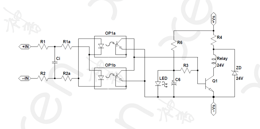

This is what I did a while ago, seems to work fine, does not false trigger even on 50V 5hz ( simulation ). Disadvantage it takes around 0.5 sec to trigger ( not a problem for subwoofers I think ) . Uses separate supply. Relay turns on on fault . Can be used to short the Speaker relay coil. or be modified to latch after "fault detected ".
Thoughts ?.
Thoughts ?.
Hi !, Does Ci high value ( 330uF ) in the input filter " upset " the amp ? or the 1K resistors help with that ?.
I'm also looking for a reliable DC protection for my subwoofer amp. So it might trigger on low freq like 20hz .
