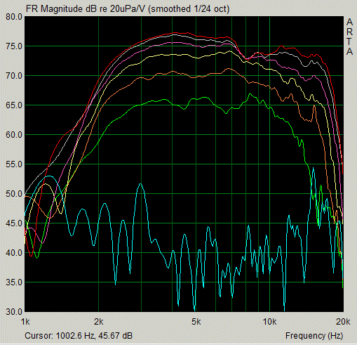

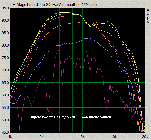

Beg your pardon, cuibono
but since everybody is showing his dipole tweeter measurements in your thread, I dare to throw in another one:
I placed two Dayton ND20FA-6 back to back on a small baffle (8 x 4.5 x 1.2 cm) and got this horizontal response (0, 15, 30, 45, 60, 75, 90 deg), measured at 45 cm distance (not calibrated):
There is no EQ involved apart from a 12 dB/oct HP at 2.5 kHz. For sure the vertical response is a mess and this botch will not find its way into 'production'. But it shows how mounting two very small tweeters very tight together can take you a loong way.

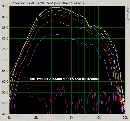

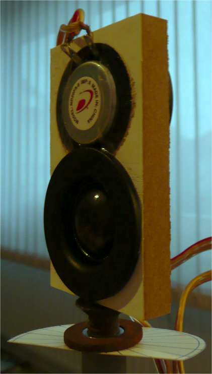

What if you tilt the dual tweeter construction a little backward, so that the domes are in the same horizontal plane?
They should behave rather well between 15 deg up and down, but have severe notches from 10 kHz up at 60°. My 'real' attempt is with the same drivers mounted on axis back-to-back, as you can see in the picture - the smaller one to the right and bottom. Size is 4.5 cm dia and 3.3 cm depth.I hadn't thought of mounting them that way, I guess because I think the figure of 8 pattern would be pointing at the floor somewhat.
I've only listened to test noise yet and - as said - I did this configuration only for some impressive measurement curves. 😛But tell us how it sounds, it looks really good so far!
If the more serious second configuration lives up to expections I will do some real listening. Sadly I don't have any BG Neo3 to compare.
Yeah, probably the first lazy Susan for tweeters only ... 😀I like your 'turntable' too.
Good idea. I had not thought about it yet. The voice coils should be within millimeters already. I am not sure if the acoustic centre is supposed to be much in front of the VC.What if you tilt the dual tweeter construction a little backward, so that the domes are in the same horizontal plane?

What a dissapointment!
I measured the back-to-back tweeter and just afterwards the tweeters in that small baffle again. I must have changed something with the EQ, because the treble falls of earlier than in my first measurements. But both last measurements are 100% comparable.
I measured the length from the rear dome center to the front plane of the front tweeter. This should be indicative of the dipole length. I got 5.6 cm for the back-to-back and 3.8 cm for the offset drivers. This corresponds to full wavelength of 6125 Hz and 9026 Hz. Quite near where the diagrams have their on-axis dents, because the backwave is 360deg out of phase with the front wave.
You will not be surprised that I will dig deeper into that flat baffle thing again ...
Hmmm, too bad. The back-to-back response looks like mine. Basically unusable. I'm surprised what a difference there is between the b2b tweeters and the Neo3. I wonder what makes the difference?
The b2b tweeters are almost ideal dipoles - circular point sources - and hence show the strong dipole peak/nulls. The Neo3 is a square diaphragm, and the frame shape and grill may have something to do with it. Recently, I added a rectangular frame between b2b tweeters, but it didn't help. I just hope BG doesn't go under anytime soon!

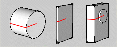

It is the dipole length, like the red lines in the picture. It is 5.6 cm for my b2b, 4.1 cm for the Neo3 and 3.8 cm for the offset baffle. That's why that little baffle looks a bit better (on paper) than the Neo3, and the b2bs look a lot worse. A variation of the dipole length around the perimeter may be helpful too IMHO. It is provided by rectangular configurations, but not by the b2b tweeter.I'm surprised what a difference there is between the b2b tweeters and the Neo3. I wonder what makes the difference?

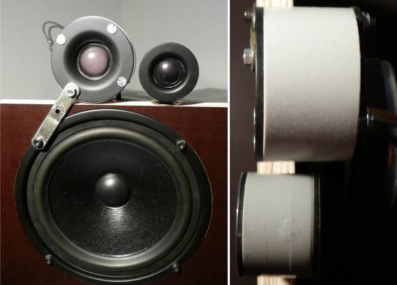

Look at the picture in post #52. Those are b2b tweeters in a tube.Back to back tweeter in a tube flush mount like this?
Smoother than shown, yes. But I would not add any mm to the sides to round them off. This would be detrimental to the dipole length.In the treble shapes must be very smooth
