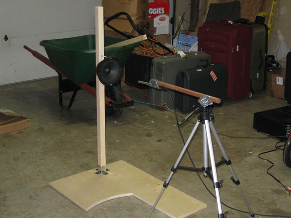

Here is its nearfield response of the bare driver. Not bad, some problem at 3.3kHz:
Here is what happens on and off axis when used as a dipole with no baffle. Measured at 1m, rotated 0deg, 30deg, 45deg, 60deg, and 90deg.
What I'm interested in the above is seeing that the off axis polar irregularities have moved up to 2kHz (the 8" and 6" had them around 1kHz): excessive attenuation at 45deg and 60deg, then a spike at 90deg. I'm fairly sure one of the main causes of the frequency of the off-axis irregularities is the width of the magnet structure, but the frame ventilation makes a difference too as we will see. This suggests neo drivers may have some advantages when it comes to dipoles and regularity of the polar response.

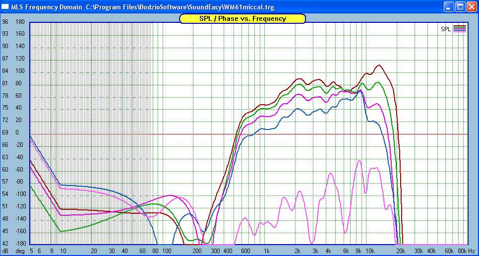

Next is what happens when the driver is put into a small sealed enclosure (I'm guessing its about 50 in sq., plus there is stuffing inside). This was measured at 1m, but was measured out to 180deg off axis:
Looks pretty different than the no baffle dipole huh? What we can see is that it is basically a monopole up to 2kHz. Also, you can see the baffle step taking place between 1-2kHz. Not bad overall. I gave it a listen. More on that in a second.
Here is what happens when you put two of these back to back:
Yikes, that won't do. That notch/peak thing at 1.1kHz is classic dipole action. Really, the response looks like garbage from 800Hz up. The on center separation between the front cone and back cone was about 14", so to get the peak up well past 2kHz, the separation would have to be reduced to 4" or less. SOOO, long story short, there is pretty much no way one can get two drivers to cover 200-2000Hz, as far as I can see.

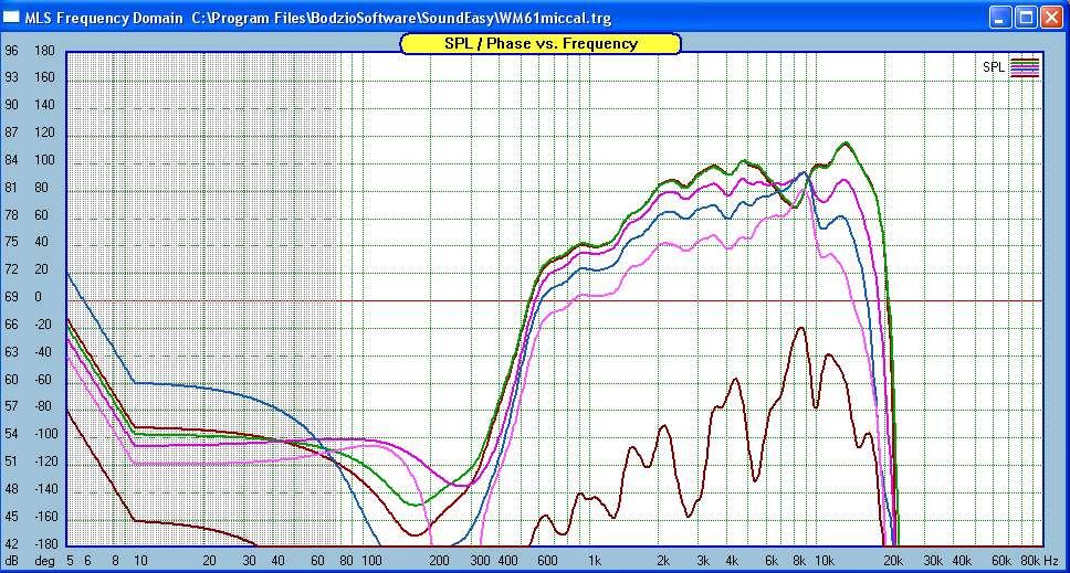

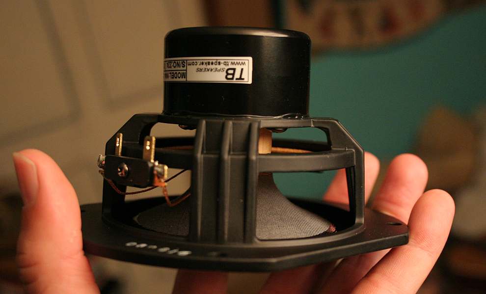

Here is where the TB driver comes to the rescue:
This is the bare driver, no baffle, measured at 1m, at 0,30,45,60,90degs. This actually looks really promising. Looking at 2kHz, at 45 and 60deg, the level is much less attenuated wrt other drivers (even the 4" poly), and the 90deg measurement shows no great spike in output. The diameter of the magnets of 4" poly and TB are about the same, but the rear ventilation is much greater on the TB. My guess is that this leads to a much more regular polar response.
Just to compare, look at what the Eminence Alpha 6a was doing under the same conditions:
Much more irregular between 1-2kHz. Really, the TB maintains very good polar response out to 4kHz, which is great! Actually, the only polar response error below 4kHz is the bump at 2kHz, which I'm guessing is the baffle peak. There is no way to avoid this, but it doesn't look to be much of a problem. At least, it will be less of an error than with other drivers.

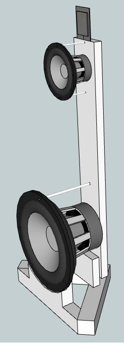

I've recently embarked on a similar adventure. Attachments show a sketch of my initial concept, a test jig to see how my midrange (Audax PR170M0) performed with no baffle, and the response curves (front and back, test jig rotated by hand so the angles aren't accurate or even). If I believe UPS my Neo3PDRs should be here Friday, so hopefully I'll get to play with them over the weekend.
I was concerned about diffraction problems around the 'nude' tweeter, and I see you used foam to address that. How much of a difference does that make, both audible and measurable?

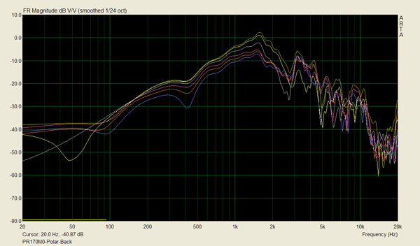

Great topic!
I am currently using a Visaton AL170 as an unbaffled midrange. The disadvantage with smaller drivers is that the magnet and spider are relatively large compared to the size of the cone. The AL170 has a relatively small magnet and spider and does better than any other 6.5" I've seen measurements of. See the pictures at Visaton - Lautsprecher und Zubehör, AL170
Maybe I should have used some smoothing here, as there are a couple minor reflections within the time window.

SOOO..... I hope nobody ordered any TB W4-656sc drivers. 😱 I've had four here so far, and they all buzzed. I don't know why, they do it right out of the box. It isn't super loud, but it is not too hard to hear either. Pretty obvious on music.
So, I went with what should be a better driver, but also $20 more, the TB W4-1320sj. It has a much smaller magnet, and much better rear ventilation, I've attached a picture. It also has shorting rings in the magnets, so it should have better nonlinear distortion performance. I'll get it on the bench tomorrow hopefully.

Honestly, I don't know enough about the wave physics or the exact dimensions needed for reflections to happen - but there seem to be some basic relationships. The smaller the magnet, and the farther it is from the cone, the better, in terms of regular dipole response, at wide angles. Not really news, probably.
I'm guessing though, that there is a relationship between magnet/basket/spider size, and the reflection frequency - up till now, I've guessed that reflections occur at a frequency of roughly half wavelengths, wrt the magnet structure. IE, magnets are 4" to 6" wide, and the 90deg reflection abnormalities occur between 1-2kHz. Distance to the cone matters, but there seems to be an approximate relationship there.
Anyway, if I'm lucky, I'll get to take some measurements today, and post them.
