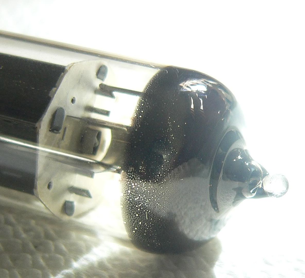

I've got a bunch of EL84 tubes with black getter flashing (instead of silver). They seem to work fine for me. I think powdery white getter flash is bad (air in the tube), but silver or black is OK. Some getter flash is brown, and that's OK too.
Here's an odd 6p14p (EL84 equivalent) with what appears to be tiny pinholes in the getter flash. It also appears to be black. This tube works perfectly well, although I don't know what caused the pinholes. Perhaps it was that way since new, and I never noticed before.
