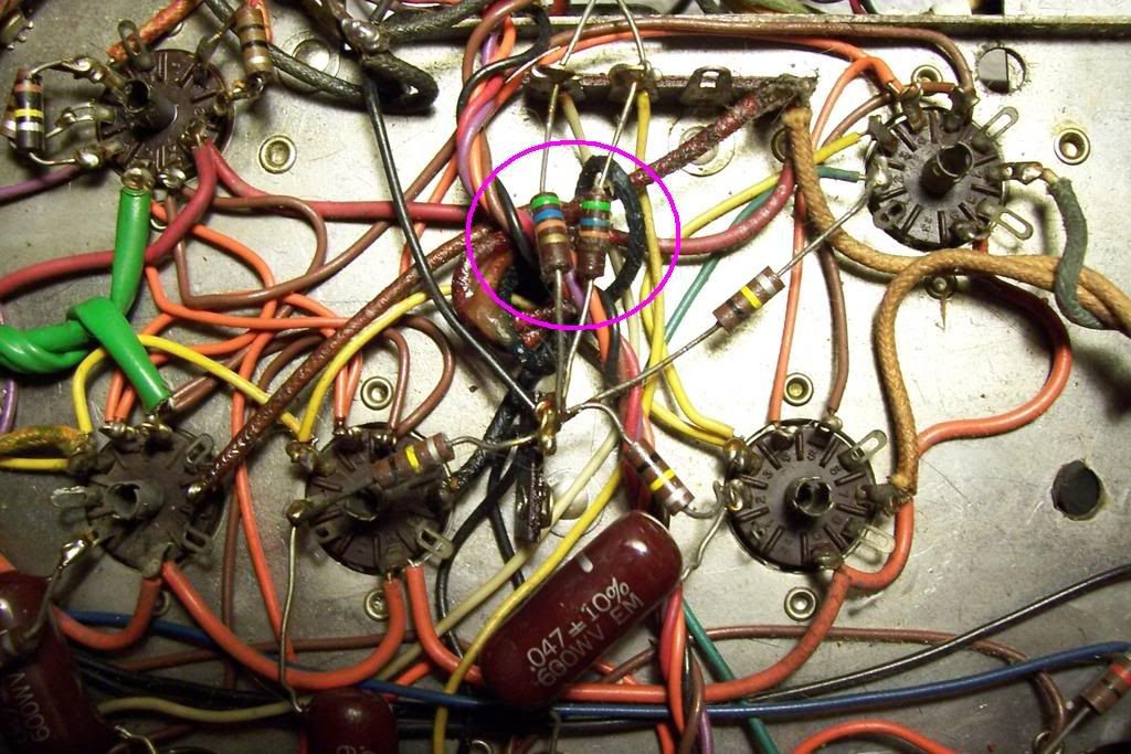

> OK I've uploaded the pics to Photobucket:
Very useful photos.
> A couple of things: I was right the first time, the bypass cap is
>10uf 50v, not 50uf.
This KN928 seems like a lower performance version of the KN734. Nothing wrong with that, but they probably saved a few nickels going with a smaller cap. I wouldn't worry about it for now. Maybe after it's working again, some of these items can get revisited.
>If I replace the 47k resistor, what power rating should I get?
>Is quality an issue here? (i.e. metal film vs carbon vs unobtainium
>$50 resistors from the back of the Absolute Sound?)
Assuming we're talking about R55, you'd be fine with a 1/2 watt. There's no real power moving through there. Even a 1/4 watt might do. In what way did the old one fail?

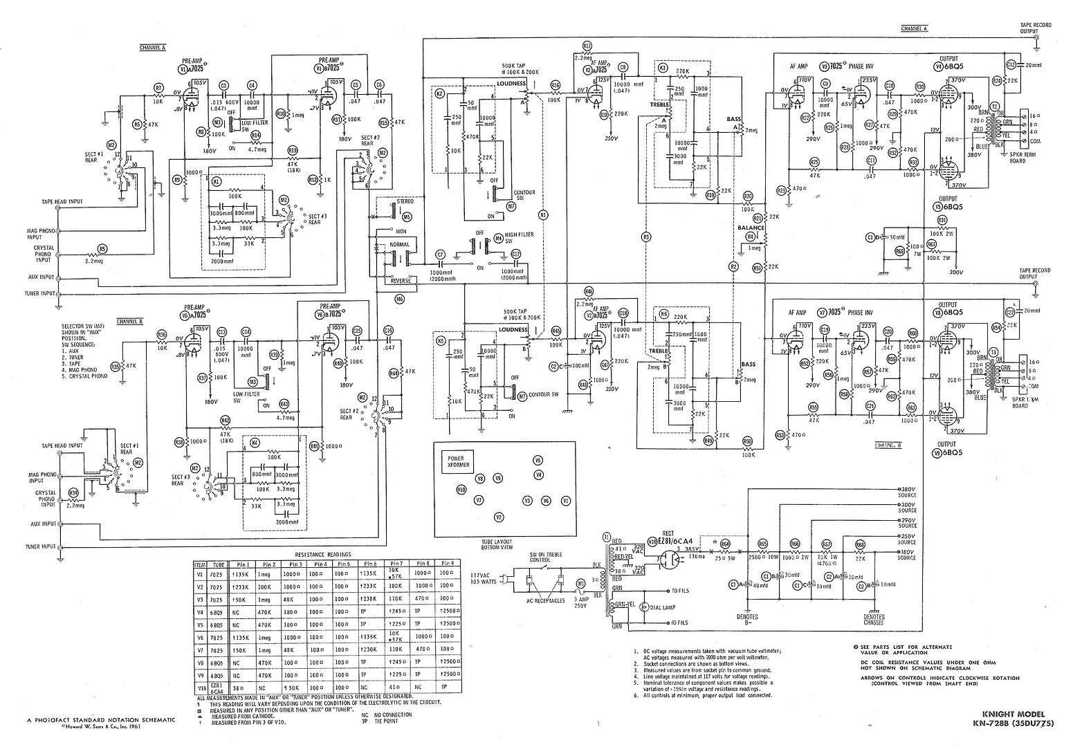

>Looking at the KN-734, I see what looks like 2 12ax7s, but that's
>actually one isn't it? The diagram shows each one as a triode,
>but this tube is a dual triode as I understand. Am I reading this
>right?
Yup. Two triodes inside one bottle. The schematics routinely show only half the tube if that is all that is being used for that piece of the circuit.

Check this and see if it is close.
I can't see R48 in your photos, but it shouldn't be hard for you to find. C26 is the light brown ceramic disc cap sticking straight up in your photo. I'm assuming it's a .047 since I can't read its numbers.
I've been deliberately ignoring the two 12AX7 tubes in the far corner (#3 and #4, as you call them). One half of them is almost certainly used for the phono preamp. The other half is probably used to make up for losses in the bass and treble controls. If the stage that provides the gain for the tone controls is whacked, that might be responsible for your low volume. But first, I'm still curious as to why you see 20 volts where is should be closer to 60 (on the PI).
R48 is most likely a 47k part, same as R49?
Try to figure out what voltage is on either side of R49. You already know the voltage on one side is 240V (at pin 1 of 'X7 #1/#2). I'd like to know how many volts are on the other side, or how many volts are dropped across it. Max plate current for the 'X7 is 1.2mA. There could be as much as 55 volts dropped across R49, but something tells me that tube isn't conducting as much as it should be.

As far as C26...the ceramic disk cap between pin 2 and 6 has these markings:
RMC - This is the manufacturer I think?
.01 .01uf
Z5U is this tolerance?
57 volts are dropped across R49
I am not seeing R48..is it possible it's not there?

Here is another Knight 724 circuit:
http://wb9k.tripod.com/
Sorry for hijacking your thread, but please can you give me the correct values for the RC-circuits behind 6c4/EZ81?
I have a Knight 735 on my workbench...somebody has make the attempt to better the original circuit with much higher C´s....but as far as I can see without knowledge....and maybee some false connections.
So...for you, it could be a great learning excercise to take a look at the original circuit and post the original values...this will help others.
Regards, Carsten
PS: the 47k from the opt is located in a feedbackloop (for better performance)...1/2W is enough.
Regards, Carsten

Regarding your updated drawing of the AF/PI stage:
- I don't think R45 exists?
- The disk cap bypassng R44 is labeled 68NF750 10%
which I assume is 68 nanofarad , 10% tolerance. Don't know
what the 750 means...
Kirk
Kirk

I have a friend who found the schematic for a Knight KN-728B. It still isn't exactly the same as your 928, but I think it's as close as we are ever gonna get. The output tubes are arranged the same, with the addition of a 1000 ohm grid stopper resistor (which I couldn't spot in the photos of yours). The rectifier uses the same 6CA4 tube, so I'd expect the rest of the power supply circuit is identical. The AF/PI stage looks awfully close to what I sketched up, except they show a 470 ohm resistor where I thought I saw a 5600 ohm part. I thought it was a green/blue/red. Maybe it's really a green/blue/brown, which is a 560 ohm. The 728 also uses an extra triode (half a 12AX7) immediately after the volume control, but before the bass & treble controls. I'm expecting your amplifier does not have this additional gain stage, so just ignore it on the schematic.
After seeing the KN728 schematic and noting the 370 volt specification on the output tube plates, it really makes me think maybe you do have a weak rectifier. You mentioned you have a variac. Do you happen to have any 1N4007 or UF4007 solid state diodes around? You might be able to get a couple at the Radio Shack. You can rig up a couple of these guys in place of the 6CA4 tube. One gets connected between pin 7 and 3, and the other diode goes between pin 1 and 3. Be very careful that the banded (striped) end of the diodes go together on pin 3. Mechanically, you'll have to be creative. You don't want the 6CA4 tube in the socket at the same time as the diodes. You can try stuffing the leads of the diodes into the tube socket holes, but be careful not to stress the fingers in the socket holes. You can also tack solder the diodes to the underside of the socket.
