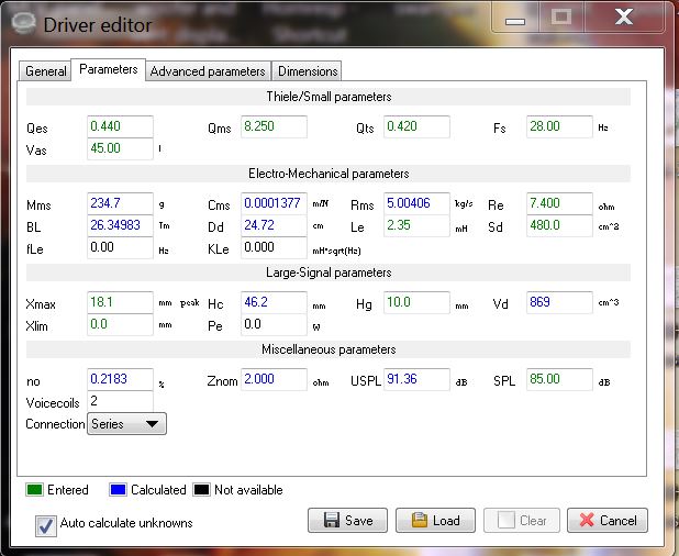

Hi GM. What driver did you use for the example sims that you so kindly provided? I reattached them for convenience sake.
Edit: Never mind, I just noticed in the comment section that it is the 18 Sound 18LW2400.
It was 49.20.
Hi tizman,
Thanks for the confirmation, that explains it 🙂.
Prior to Version 49.30 it was possible to set Eg = 0, which gave the driver diaphragm a constant rms velocity of 10 cm/sec at all frequencies. The functionality was changed in Version 49.30 to allow the user to specify a constant velocity value other than 10cm/sec, and a constant acceleration option was also added at the same time. It was no longer possible to set Eg = 0.
Kind regards,
David
