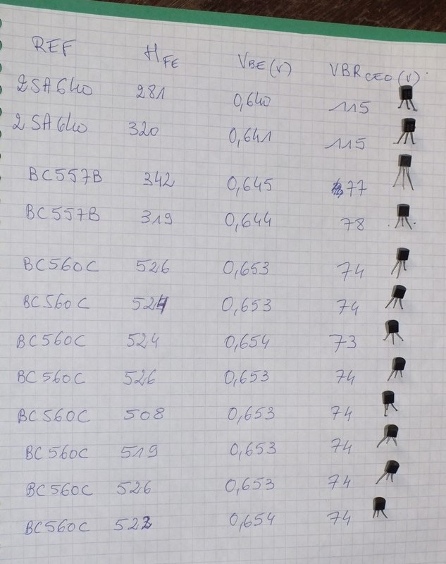

Hello,
I made measurements on some of my transistors.

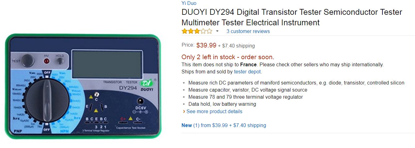

I used a PeakMeter PM8233D DVM to measure Vbe, whilst measuring
Hfe with a Duoyi DY294 transistor tester, @ Ib = 10µA.
The 2SA640 were LTP extracted from an old power amplifier.
I don't remenber the brand.
The BC557B and BC560C were baught from an eBay chinese seller.
They were presented as matched transistors.
So ??

what are the digits that look like an inverted "V"?Hello,

How did you measure VBR ce0?
Hello,
"what are the digits that look like an inverted "V"?" It's Volt.
"How did you measure VBR ce0?"
With the transistor tester Duoyi DY294.
- Review of the DY294 Digital Transistor Tester-Part 1 | Electronics Repair And Technology News

Number 1 European style.what are the digits that look like an inverted "V"?
Ahh! That's why I didn't recognize any abnormalities in the picture 😛!

Hello,
Right, I didn't understand your question !
The way you wrote "1" is like inverted "V". I had no problem reading it even tho I didn't know about any European style.
I don't know why you made the test, as BC550c/560c is pretty standard low noise high gain (typically above 500) transistors, and OP seemed to want something better than that.
BUT, important information from your test is that they actually have such a high break down point!! (74v?). I have also believed that the rated max SOA characteristics in the datasheets are underrated for original products from top manufacturers. That's why I use Vceo=45V device all over the places.
I found that BC560C s of Fairchild semi that have Hfe a bit lower than genuine ON Semi on last time. I dont know exactly reason why.
Hfe parameter is performed by low cost transistor tester kits that are commonly selling on Ebay.
C grade is the highest grade having hfe from 420 to 800. It is normal that some manufacturers produce typically lower than others. It is also often found that once in a while ON semi can perform better than the published maximum (in this case 800)
