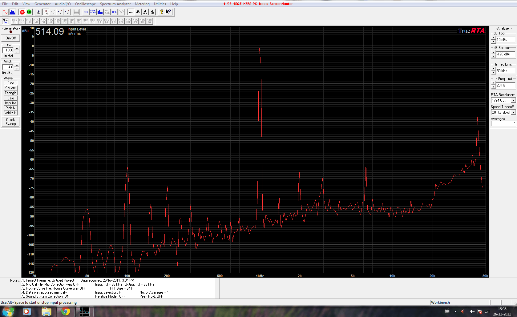

but with this fets, it will interesting, but now, I have did a measurement with 2sj/s2k lateral mosfets.
see the picture, everithing below fundamental is pc related, I don,t get that more flatten, see only the first couple of harmonics, higher she dissapear,, explane the warm sound of this amp, driver of the mosfets are CCS loaded cathode follower EL84 dc coupled to the mosfets with dc tracker for low offset measurement is for 12AU7 electro-harmonics tube preamp.
I search still for best measurement software, if you know a good one let me now, thanks.
Amp is without feedback, exept local, because a kathodefollower has 100 procent local feedback. Some people say that kathodefollowers are not sound friendly, is that so? I don,t try yet and so I am busy with plate follower and with feedback because of a lot more amplifiing.
