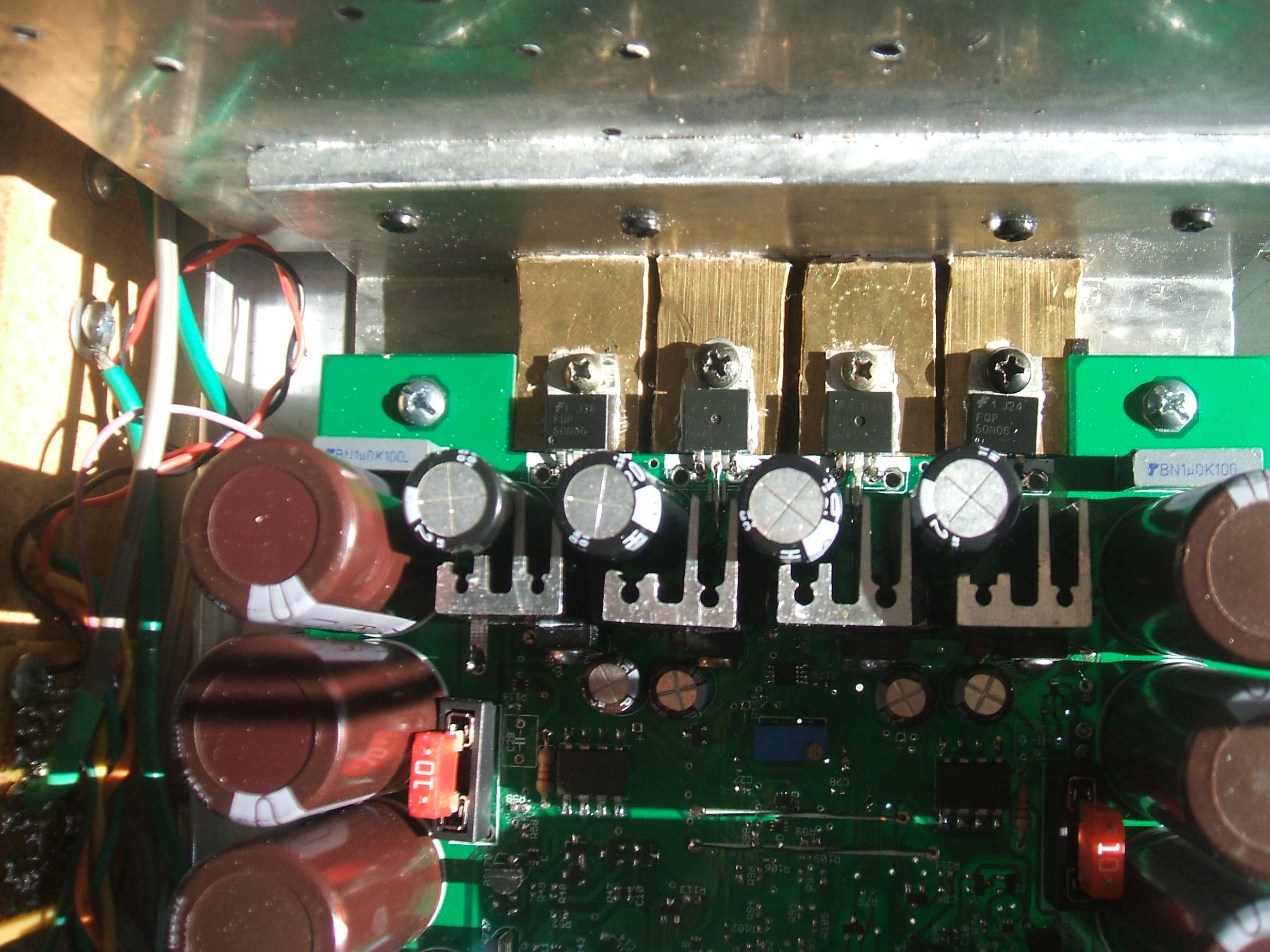

very heavy J-fet
hmm but the money you saved on fets you blew on solid gold heatsinks? 😀

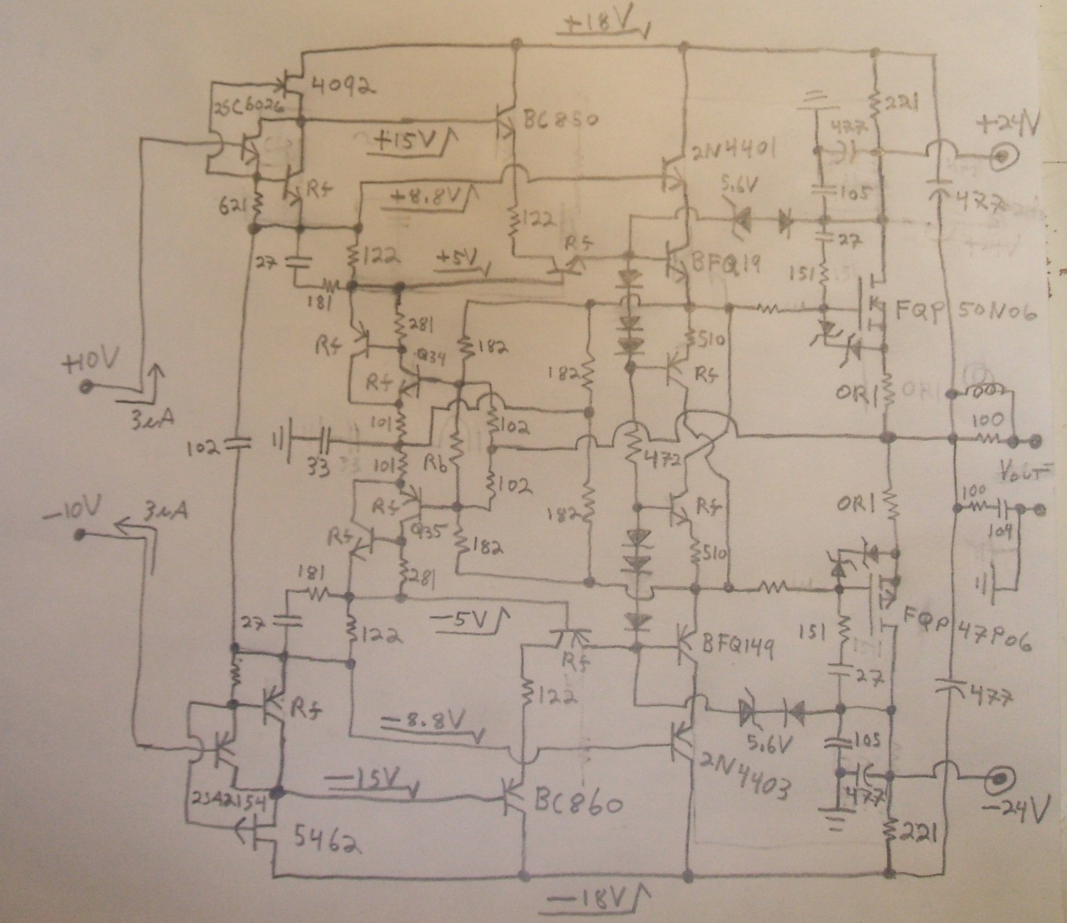

HA ha....gold...I wish.😀 That metal is white brass, scrap metal I happen to have laying around here. By directly mounting the tab (drain) to the brass block because it has much higher density than Al, it acts as a thermal capacitor, and extended heat spreader. The idea is to achieve a more average temperature and keep the die temp from spiking and destruction. Since there is no mica insulation between them, the brass block is energized, but separated from the Al bracket by mica, 4) TO-220 mica pads (I have a whole package of TO-220 mica🙂) has more area so less thermal resistance. Not all switching fets are suitable but this type is very tough. The major drawback of using them in a linear amplifier is the distortion they create, hence the EC circuit. By having a proper drive and straightening out the non-linear transfer, they become quite the output stage. I have amazed myself at how much power I can suck through just one pair of these cheap devices.😀 Pd@ 150 C is 20W for the weaker N-ch device. 27W for FQP47P06. Compare that to a TO-220 or even a TO-247 BJT.

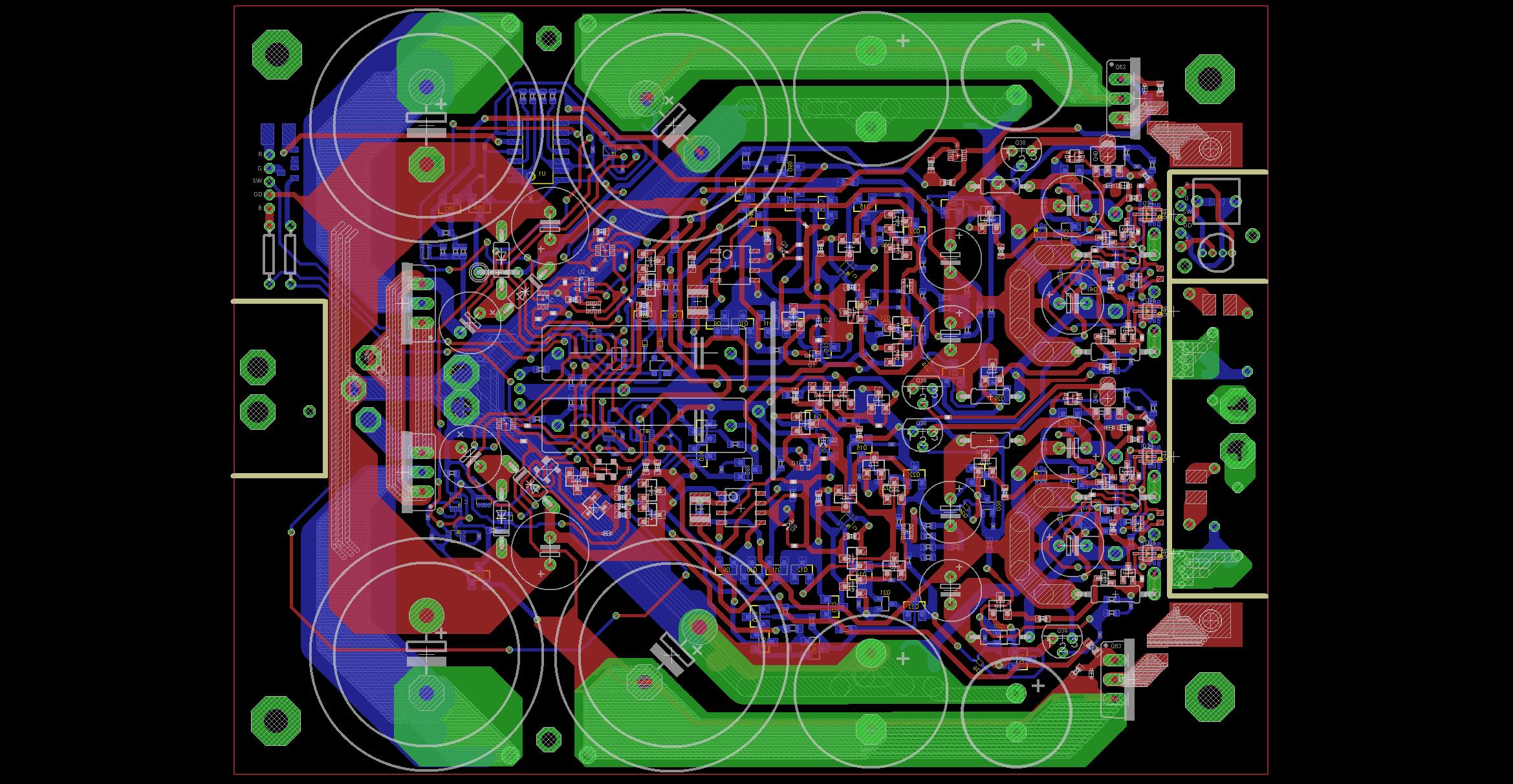

BTW, the circuit drawn in Eagle has only 3 stages before the EC follower circuit, and this counts the DC servo that supplies the 'virtual gnd' for DC input bias. It looks complicated because there are two amplifier channels, the power supply, V-reg circuits for the amplifier front-ends, clipping detection, and DC detection/cut-off. Hopefully I can finish before the end of the year.😎
Are these packages really able to dissipated 1650 watts?
These are switching devices as well, but they appear to be of the Trench type structure. I'm not 100% on any 'new' age trench-fet but generally the trench type is susceptible to hot-spotting if used in a linear application. Sort of a secondary like breakdown effect. These may be different but >1600W is highly de-rated at high temp and continuous duty.

My philosophy is that for a power amplifier, you don't need much current and power until the final stages.😉 This opens up the door to lots of different parts that can be used.

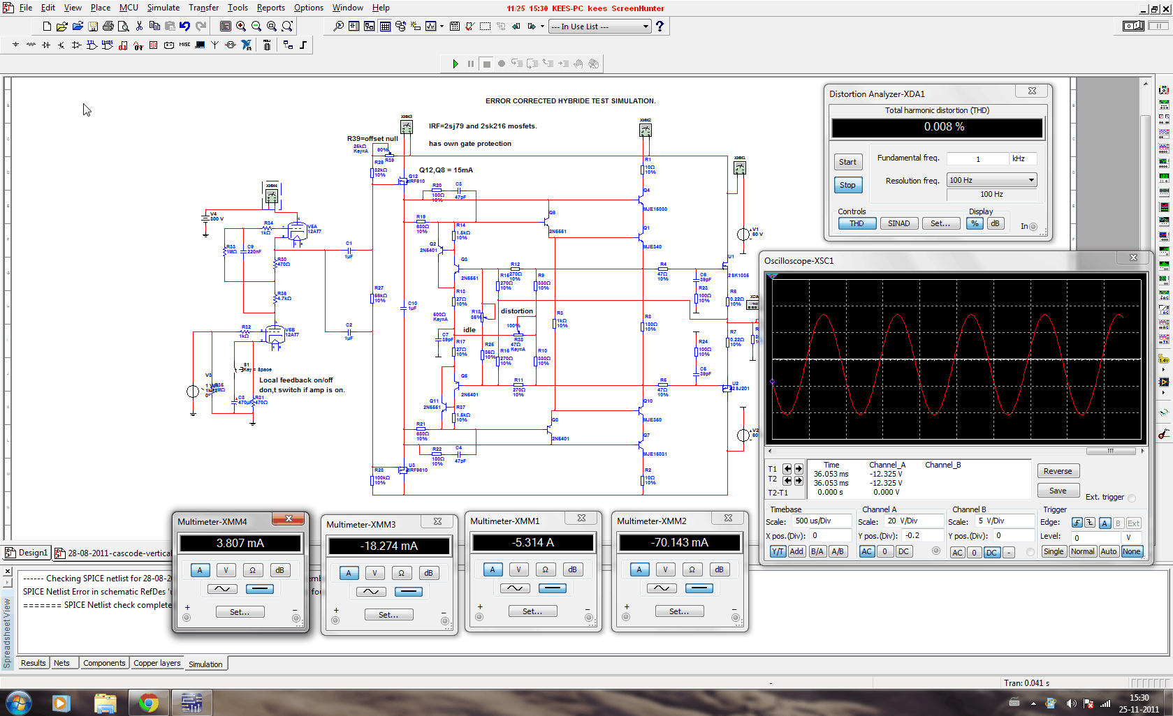

but with this fets, it will interesting, but now, I have did a measurement with 2sj/s2k lateral mosfets.
see the picture, everithing below fundamental is pc related, I don,t get that more flatten, see only the first couple of harmonics, higher she dissapear,, explane the warm sound of this amp, driver of the mosfets are CCS loaded cathode follower EL84 dc coupled to the mosfets with dc tracker for low offset measurement is for 12AU7 electro-harmonics tube preamp.
I search still for best measurement software, if you know a good one let me now, thanks.
Amp is without feedback, exept local, because a kathodefollower has 100 procent local feedback. Some people say that kathodefollowers are not sound friendly, is that so? I don,t try yet and so I am busy with plate follower and with feedback because of a lot more amplifiing.
