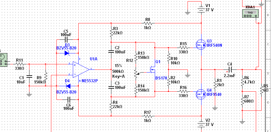

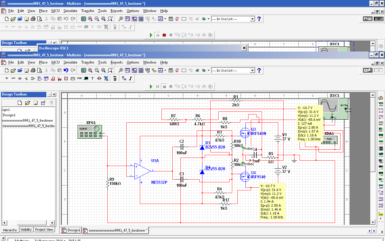

Hi nothumans, i designed this amp and it works 😛 in Multisim with 0.000% THD 😀,
+-15.82V output voltage.
I am using 5532 opamp and +-37V input voltage feeding the opamp and the 3.5V bias with 20V zener with 1k resistor 🙂)
I built it and it sounded only a few seconds when mosftets failed instantly 😡@ 😡 i tried 20 times with different modifications and it burns the fets without asking me and without heat them at all, they were cold. i dont have any fets now and i dont want to lose :RIP: :RIP: other fets, they are priceless to me.
I think would it possible the problem to be the bias because in the datasheet threshold voltage is between 2 and 4 volt ? and 3.5 to cause many amps flowing throught both fets ?
I am very confused, PLease help me, Any ideas ? 😕

The circuit looks a bit erm 😉 bizarre.
The biasing for the FET's is totally wrong and uncontrollable... but hey, lets not lose sight of the fact you designed this... and nothing beats practical experience.
Tip... use a bulb tester in all your experiments. That way the bulb lights, and the FET's live to fight another day.
It might be possible to make this work but I haven't time at the moment to look closely at it. The secret will be in rigging up a proper bias network between the FET gates because as you say, even a slight increase in bias voltage will cause the FET's to conduct very heavily.
Also (a bit hard to make out) but the feedback return (R6) needs to connect to the FET's and not the output end of the speaker coupling cap.
It needs a lot of work but it might just be possible to get some music from it.

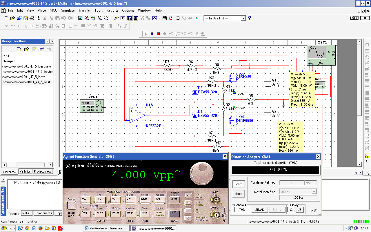

hey initially feedback was before the cap but changing it improved the THD performance and I added 2k to ground before the cap to allow fet sources "touch ground","clearly".
Look at this attachement, initially i built this & actually i listened to it 2 days.. It was fantastic magical experience 😀, sounded very good but i made those modifications and everything went to hell 😱
modifications include adding zener diodes (before i used another supply for opamp and bias was from the high voltage 37) and output stage's input is changed from "resistored" to "capacitored" (in multisim that improved THD and decided to use it with two capacitors)

Welcome to the real world, i.e. the perils of designing with a simulator without actually understanding the parts and circuits.
For some pointers see if you can figure out the data sheet diagrams for dependance of Vgs versus Id curves on temperature, and also what it means when the treshold voltage specification says 'typical'.\
Also, did you ever think why you can only get output voltage to be around the same as OP-amp power supply voltage, and where the 'rest' of it goes?

Why use +-37V while testing a circuit which cannot give you more than +-16V or so. i asked where you think the rest goes, and until you figure that out you will not understand how MOSFETs can fail so quickly. And you are lucky - if it was BJT it would be 1/10s of seconds.
Also - you do NOT fix a parameter which varies from MOSFET to MOSFET. If you set bias voltage to 2.5V it will likely not conduct at all. And if you set 3V, on one MOSFET it may be 100mA, on the next it might be 500mA, on the third 10mA. Mosfet treshold voltage has high tolerances between the same type MOSFET at the same temperature. You cannot rely on this parameter. The proper way is to make the bia system adjustable. Then you start with the lowest setting while checking bias CURRENT through MOSFETs and slowly adjust upwards until you get the desired current. If you have done your job right with the thermo-coupled bias, it will remain more or less constant.
Also - do not even try running the amp with no heatsink on the MOSFETs. Think about it - the silicon crystal inside the MOSFET is tiny and it can heat up far over the destruction level before the outside case even becomes warm.
I am sorry but none of this you will learn from a simulator. Read some basics on electronics circuits and elements.

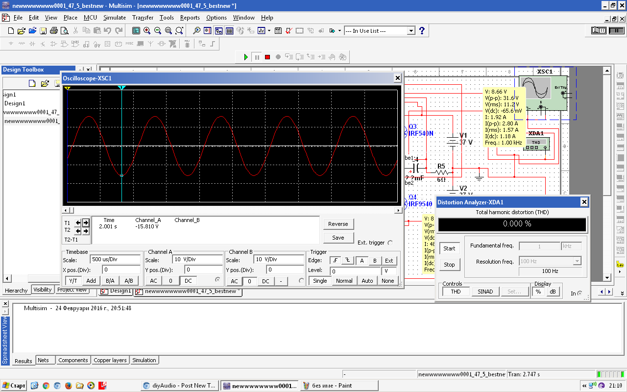

Heey, this works without R14 when R3 and R4 are 10k
Is it right without R14 ?

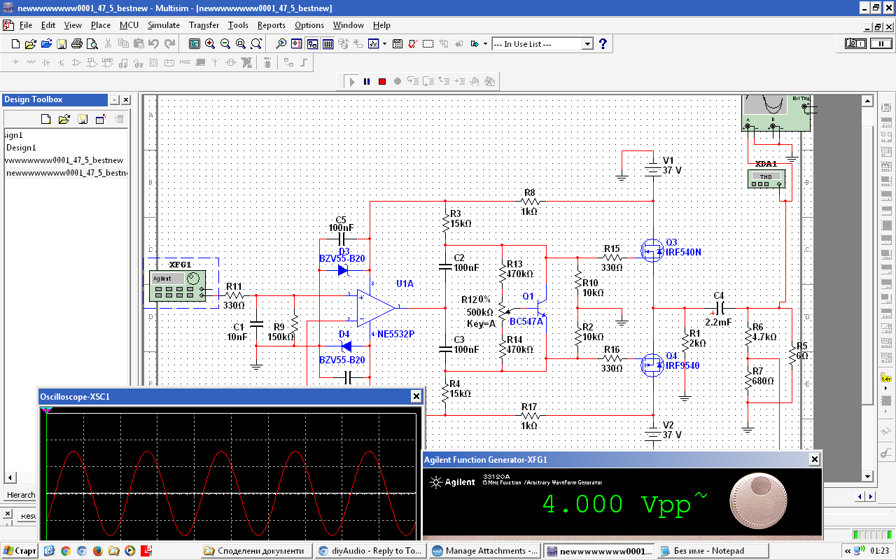

hey, would it god if i use bs170 instead bc547 for the vbe multiplier ?
like in the attachment 😀
Thank you all you are gods 😎
and would it possible to build a long-tailed pair with bs170's 😀 for better sound quality 😀
