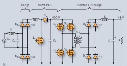

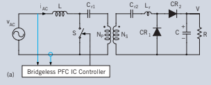

So here's the proposed SMPS front end, by Dr Cuk - anyone seen it?
Note that it runs off AC without the usual rectification to DC first but still works on both polarities :eek:
attachment.php
It replaces a conventional SMPS that usually looks like
attachment.php
So Cuk's circuit looks simpler but it's not exactly obvious how it can work, full explanation here.
PETarticles.pdf - Google Drive
David

This is a conventional PFC circuit, did you look at the Cuk article?
The claim is that it supersedes this type of rectifier based PFC, eliminates diode loses and complexity.
It looks clever and Cuk is well credentialed.
But I haven't seen this idea used, maybe I have just missed it or maybe the idea is problematic.
