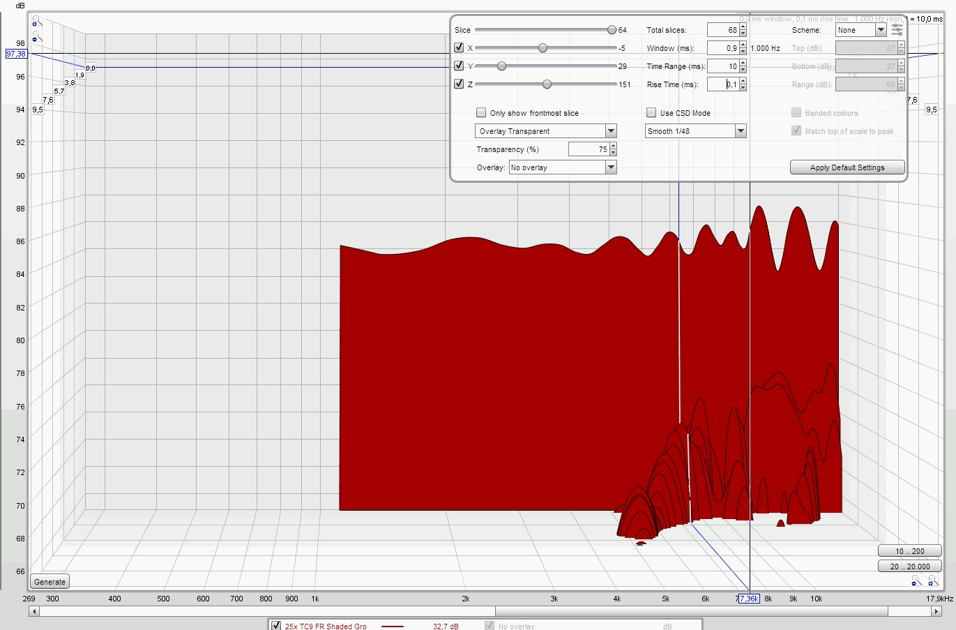

I just typed in a very long reply, only to delete it myself... pretty inefficient, must be the heat we have currently .Have to get back on that tonight, got other stuff getting in the way right now .

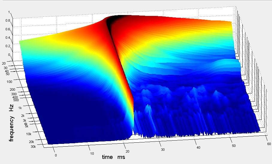

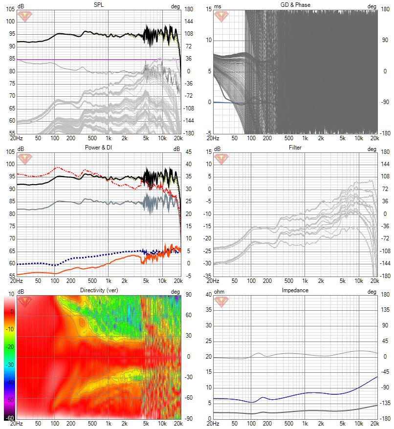

To show a little préqual:
A modeled result of the floor and ceiling mirrors (mirrors at -6 dB).
When viewed in REW:
So in short: browse trough the Window (ms) value to travel trough time and see the wave form itself. Keep Rise Time low, but play with it.
It makes the floor and ceiling reflections visible over time. Making it easier to find it in other graphs.
I used this tool, and the spectrogram extensively to figure out what windowing to use in FIR processing for my arrays. While measuring a lot in my room, armed with
fiberglass damping panels to figure out what did what and making lots of measurements with those panels in every place you can imagine:
Afterwards vacuuming the house before the rest of the family came home .
It resulted after quite a while in knowing where every bump in a graph like this comes from:
And more important: learning to make the right choices for my EQ in DSP processing using DRC-FIR, making it about speaker control, way more than room
correction! Except maybe for the low end, as that is where room correction actually makes sense. But first I had to learn to be able to separate the two.
If I would have had modeling like Vituix presents us, I would have have been able to see the arrays by themselves, saved as an IR trough View _>
Impulse Resonse -> Total SPL. I could have added the floor and ceiling reflections separately, while comparing it with actual results. But it would provide me
with way more information than the end frequency response, as you're able to scroll trough it. Both in Spectogram and Waterfall tabs. Not to mention the
filtered IR's that we have at our disposal within REW. Disecting a room + speaker is harder than it may look, these programs make it more accessible, as
we can separate the results and "see" it happen.
Hope this helps... not typing it again .

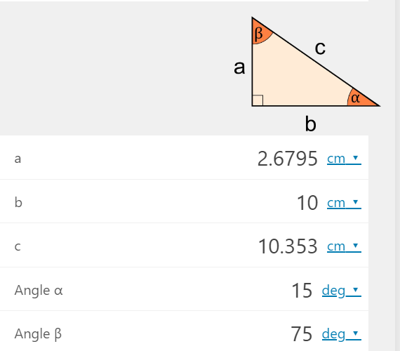

"I suspect tilting back speakers about measly 10 degrees give or take would positively affect imaging."Hello,
Long story short I suspect tilting back speakers about measly 10 degrees give or take would positively affect imaging.

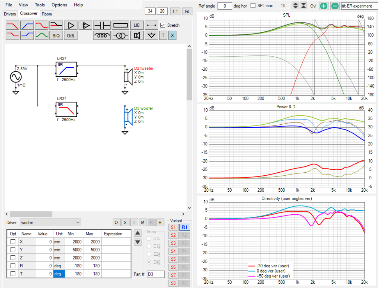

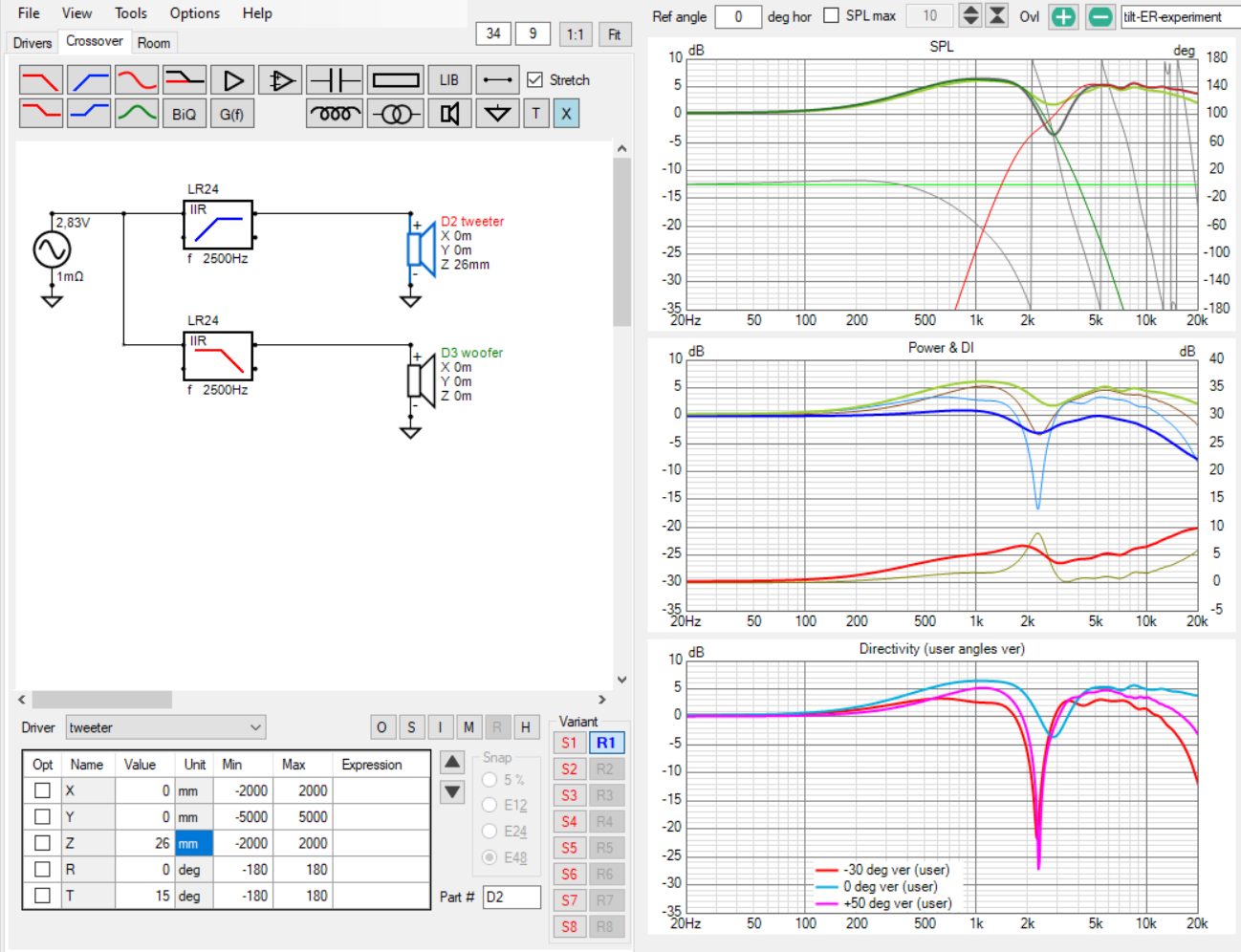

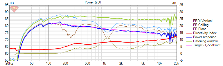

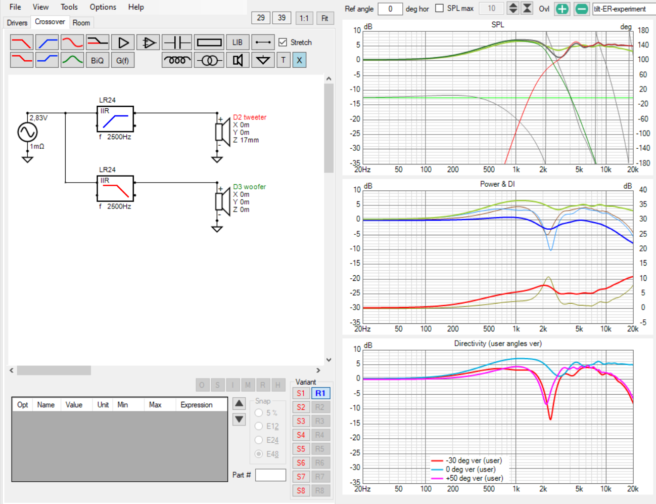

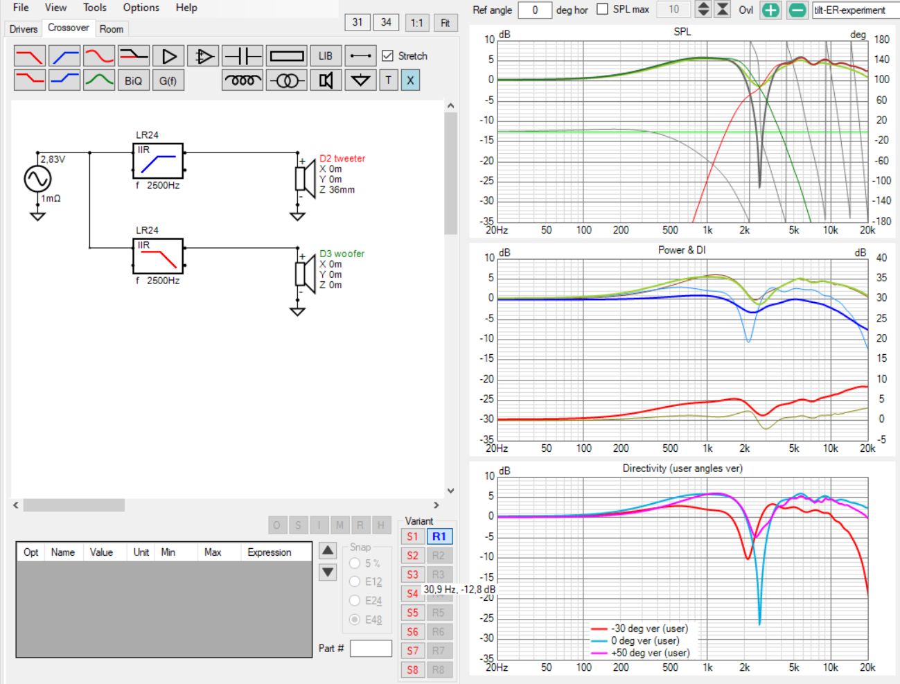

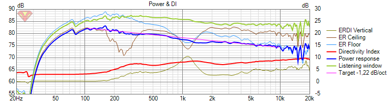

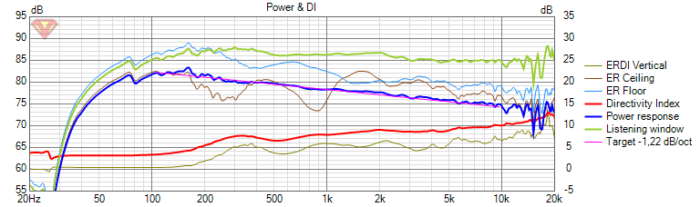

This is a thread where it would be nice to collect some observations and experiences on tilting back loudspeakers, is it worth it.
Without further ado I'll explain an observation I had recently from VituixCAD simulation and I'd like to know better what you have experienced in terms of sound stage height and / or stability with and without tilt. If you have any comments regarding vertical early reflections and speaker tilt and height, crossovers, how we perceive the vertical reflections, what ever related.

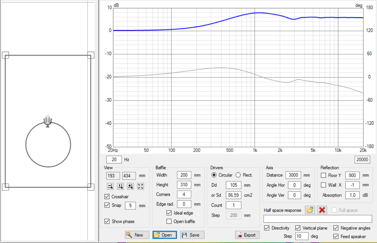

This is made up sim with ideal drivers, its a two way box with 5" woofer and 1" tweeter, 20cm wide and 31cm tall, rather typical bookshelf speaker. The situation would be about the same for any loudspeaker that has a small tweeter and a woofer who are not coincident but stacked one above the other, perhaps 90% of all speakers out there, could be two or more ways, bookshelf or tower. Speaker with coincident tweeter and woofer (or a fullrange driver, or an array etc.) would have pretty much similar frequency response towards these reflections and perhaps there is not much difference. Perhaps this is partly the reason people like such speakers?

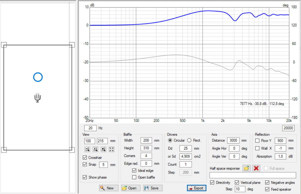

Drivers and baffle, responses made with mic at center for simplicity.
View attachment 1073049 View attachment 1073050
Here is the basic simple simulation setup. Arbitrary crossover point at 2500Hz, could be more or less doesn't matter, this is just some plausible crossover for such system.

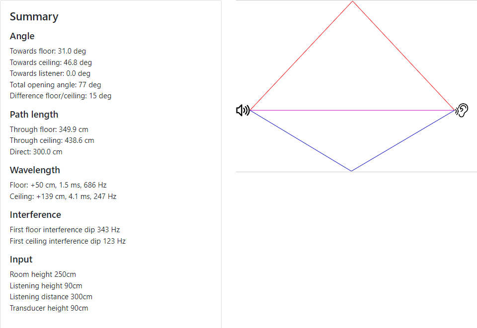

Angle calculations, the room setup and simple right angle triangle calculator to get how much I need to increase tweeter Z coordinate with the Tilt angle in simulator. On the calculator B was set to driver c-c distance of 10cm and desired angle to alpha. This is not too accurate do it like so but accurate enough to zone in the tilt for listening experiment.
View attachment 1073053 View attachment 1073054
Here is the angles visible illustrating zig zag. Bottom graph shows -30 angle towards floor, direct sound and +50 angle towards ceiling. The zig zag happens roughly between 2-5kHz in this example, when ceiling reflection is relatively louder than floor reflection ( I think these graphs don't include attenuation due to path length ). Same graphs are also in power and DI window as light blue and light brown, these are default in VituixCAD so one doesn't have to setup the user defined angle if you are checking the stuff out in your project.
Now with small 10 degree tilt we can align the floor and ceiling reflection responses better so that dip due to lobing on both reflections happens roughly at same frequency. The hypothesis was that now both floor and ceiling reflections are about as loud through the whole frequency spectrum keeping the vertical image more stationary, stable. Alignment is not perfect but there is about no zig zag. 15 degrees would work fine as well but in the example listening axis response suffers already quite much. I don't know how bad this would be with your speaker, perhaps affects perceived sound or not.
Here is also 15 and 20 degree tilts. 20 degrees is too much in this case, zig zag is worse.
View attachment 1073058 View attachment 1073057

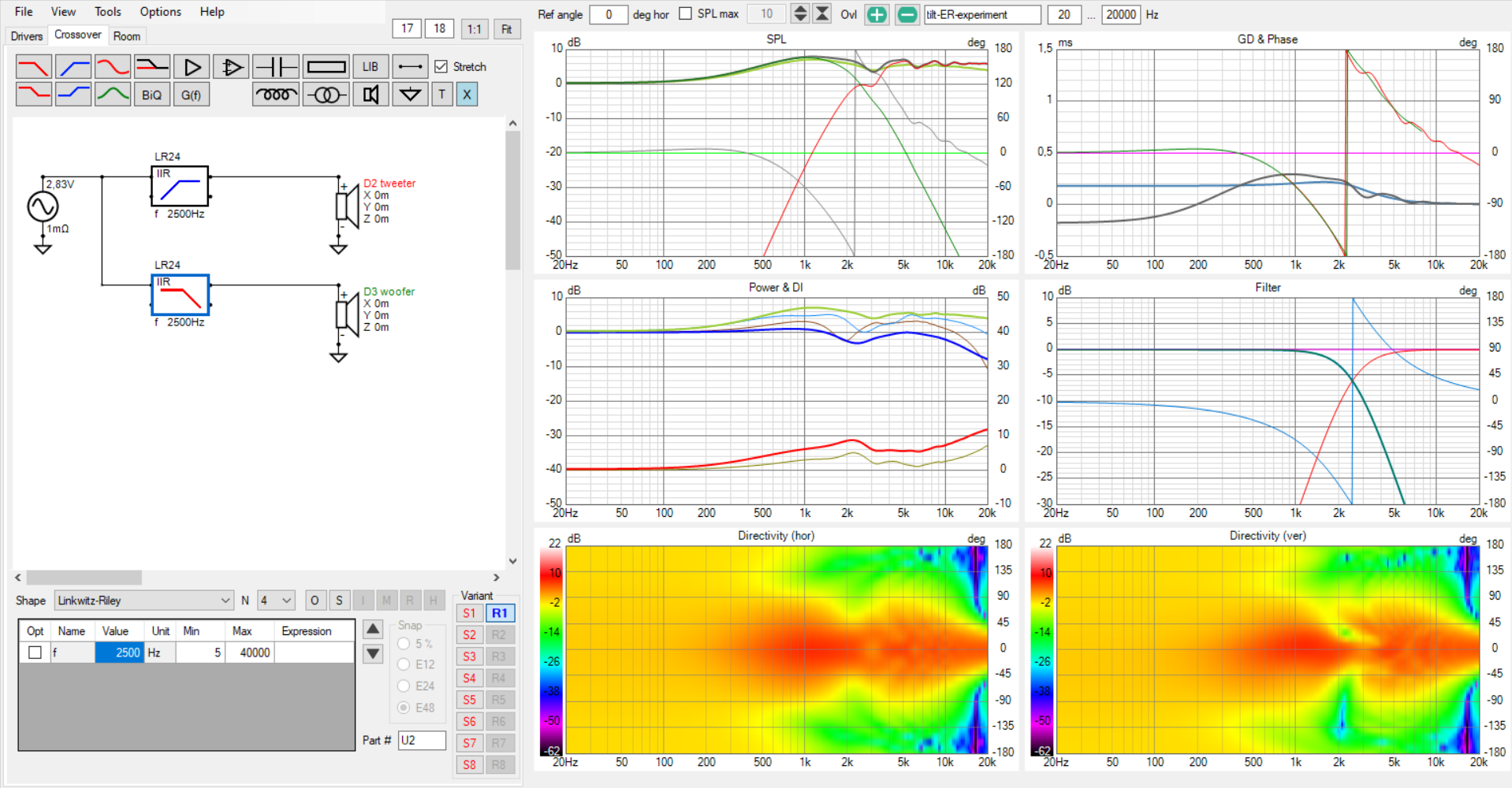

And here is completely another kind of system a three way with waveguide based on real measurements, not sure what kind of crossover slopes are, symmetric enough at least to make the zig zag. See the ER lines, light blue and brown. The first image is system adjusted before checking out this stuff, for basically power and DI and that kind of stuff. The second image shows that if I was to sacrifice some of the other lines and just adjust delay of the system to get tweeter back some and steer the nulls toward reflection angles the zig zag is gone. Not much of a sacrifice because the response can be adjusted for this new delay. Third image also tilts the waveguide little, now there is relatively more sound through ceiling on high frequencies than through floor, similar thing than perhaps a thick rug does as well. As frequency goes up more from above and less sound below listening axis. Here the 10 degree tilt works just fine.
View attachment 1073060 View attachment 1073063 View attachment 1073068

Here are some quick rough numbers to tilt your speaker roughly 10 degrees, put some Lego (a standard block is ~1cm high) or something else under front edge of your speaker. You could try more or less tilt if you wish. Careful not to tip over your speakers, I don't want to be held responsible for broken stuff! If you have DSP you could just delay the tweeter (driver closest to ceiling) some extra to tilt the nulls instead of physically tilting the speaker.
Box depth affects how high the front edge needs to be lifted to achieve 10 degree tilt. Here is few for starters:
20cm deep speaker box use ~5cm riser on the front, 5 lego blocks.
30cm deep speaker box use ~7cm riser.
40cm deep speaker box use ~10cm riser.
50cm deep speaker box use ~13cm riser.
