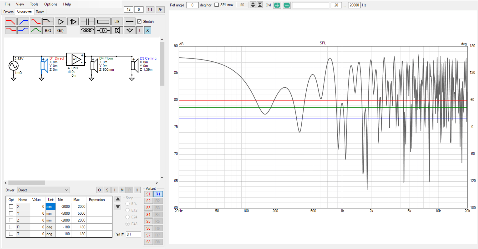

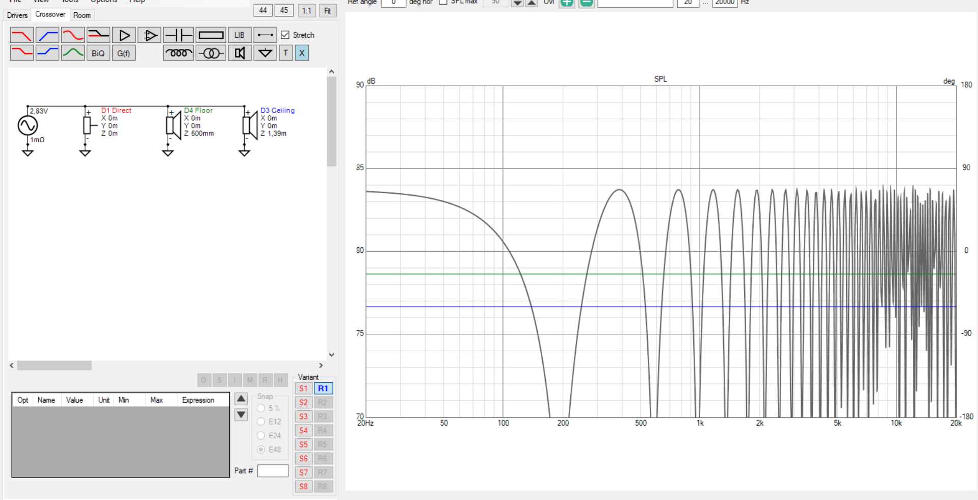

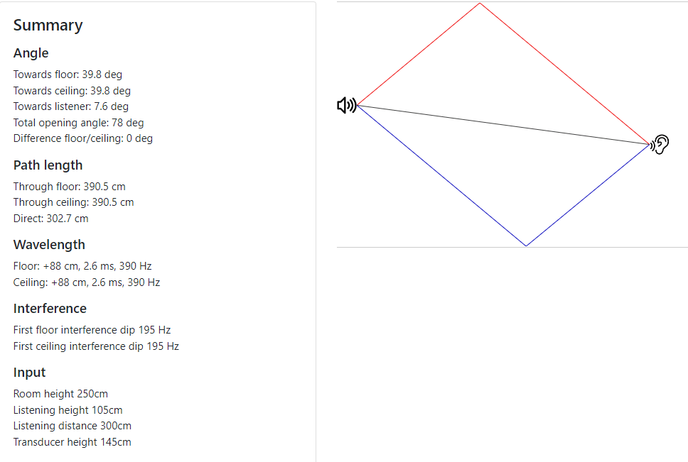

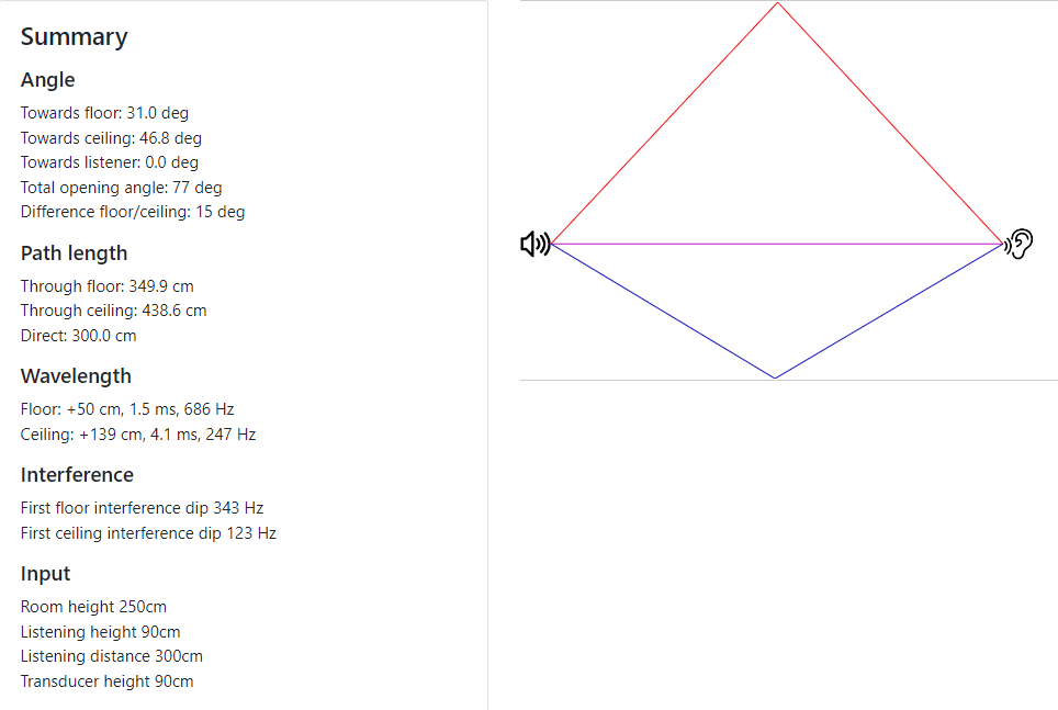

Some data for this. In the sims there is ideal sound source and its direct sound at listening spot is 80db, frequency response flat. Then there is two more sources emulating ceiling and floor reflections, ideal reflections without any diffusion or extra attenuation other than whats there due to extra path length. Here in this case, source is 90cm from floor, listener 90cm from floor, ceiling 250cm and listening distance 3m which calculates extra path length for floor 50cm and for ceiling about 139cm. Floor reflection gets attenuated ~1db with the extra path length and ceiling reflection having much longer path length has ~3db of attenuation, related to direct sound.I did not mention earlier why I would even think same order reflections from opposing boundaries would make an image: that happens with two stereo speakers, their direct sound that correlates makes the phantom center. There is precedence effect that somewhat masks reflections, but if we have two correlated first reflections, take first order floor and ceiling reflection for example, they are not too much quieter than direct sound especially systems with direct radiating tweeter and they combine together making one louder phantom image which might fight back some for the precendence effect.
But, since phantom image is created by brain it is well possible that no such phantom image is created with two correlating reflection, because the brain is processing, at least prioritizing, the direct sound. Perhaps they are part of some localization thing, or something. Anyway, hearing system is faschinating thing, surpassed by even more amazing visual system of course.

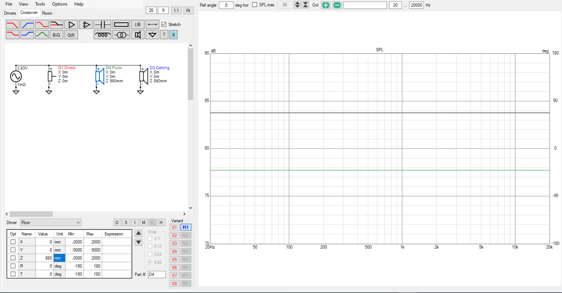

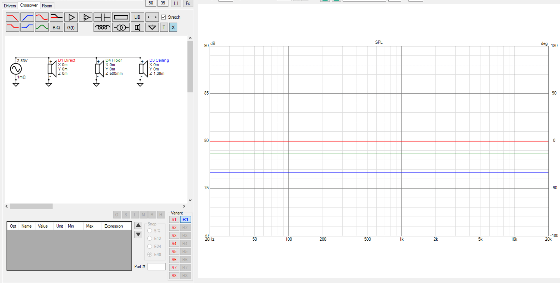

Now just mute the direct sound to inspect the reflections in isolation. Seated height, asymmetry to ceiling and floor path lengths are different and comb filter ensues. Notice though that the constructive interference is up about ~84db, louder than the direct sound.
And now the path lengths are equalized, speaker (and listener) elevated some. Comb filter is gone as we have perfect symmetry. Now its clear to see the reflections, although attenuated, but when combined make together ~4db louder than direct sound (which was 80db).
Perhaps there is no point thinking like this as I'm not sure how brain processes all this. Its nice to check out how sound sums up every now and then though

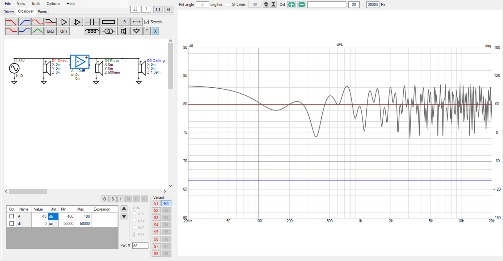

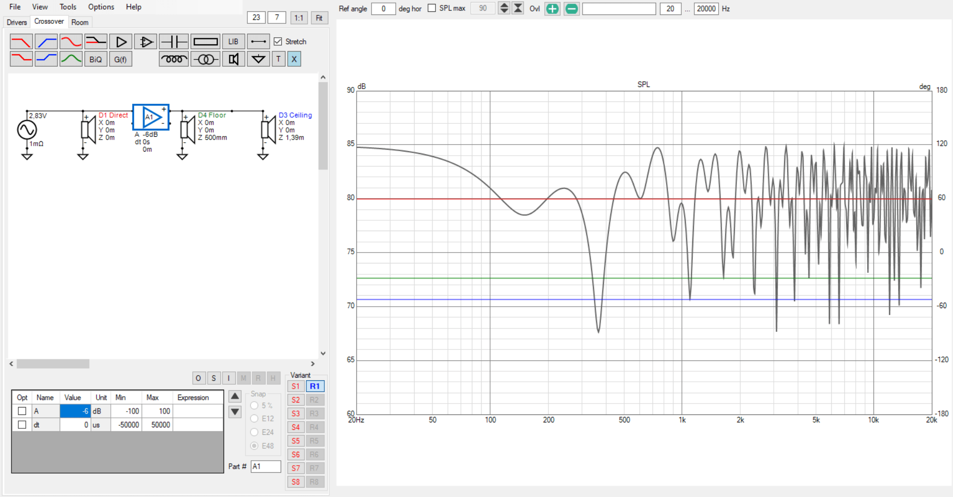

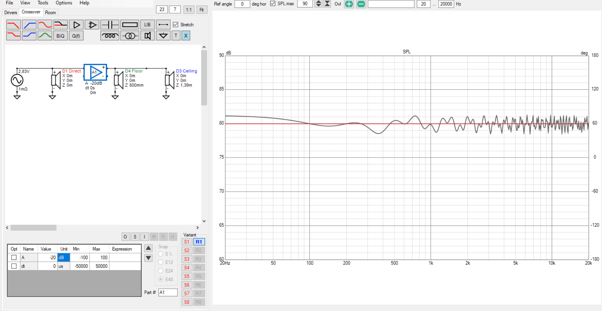

For completeness sake here is interference as all three sound sources are on, direct sound and the imaginary ceiling and floor ideal reflections:
Here reflections are attenuated broadband additional 6db, 10db and 20db, one could think this as narrower coverage angle source or added acoustic treatment. Either done broad band require huge objects. It takes about 10db attenuation to get the resulting interference +/-6db terrirory and 20db attenuation takes it to measly +/-1db territory.
Main nugget in this post to demonstrate the first reflections really are loud and completely trump direct sound (1 direct sound vs 6 boundaries), but since they are delayed hearing system is able to process them out somewhat. If all 6 first reflections (floor, ceiling, four walls of a room) had different spectrum than direct sound, but similar to each other, steady state spectrum at listening position would be more like the reflections than the direct sound. If we have correlating spectrum on at least few of the reflections to direct sound and then the rest decorrelating we probably have good situation at listening position. Think how remarkable brain is to suppress the reflections as they come later, bring out the direct sound?
