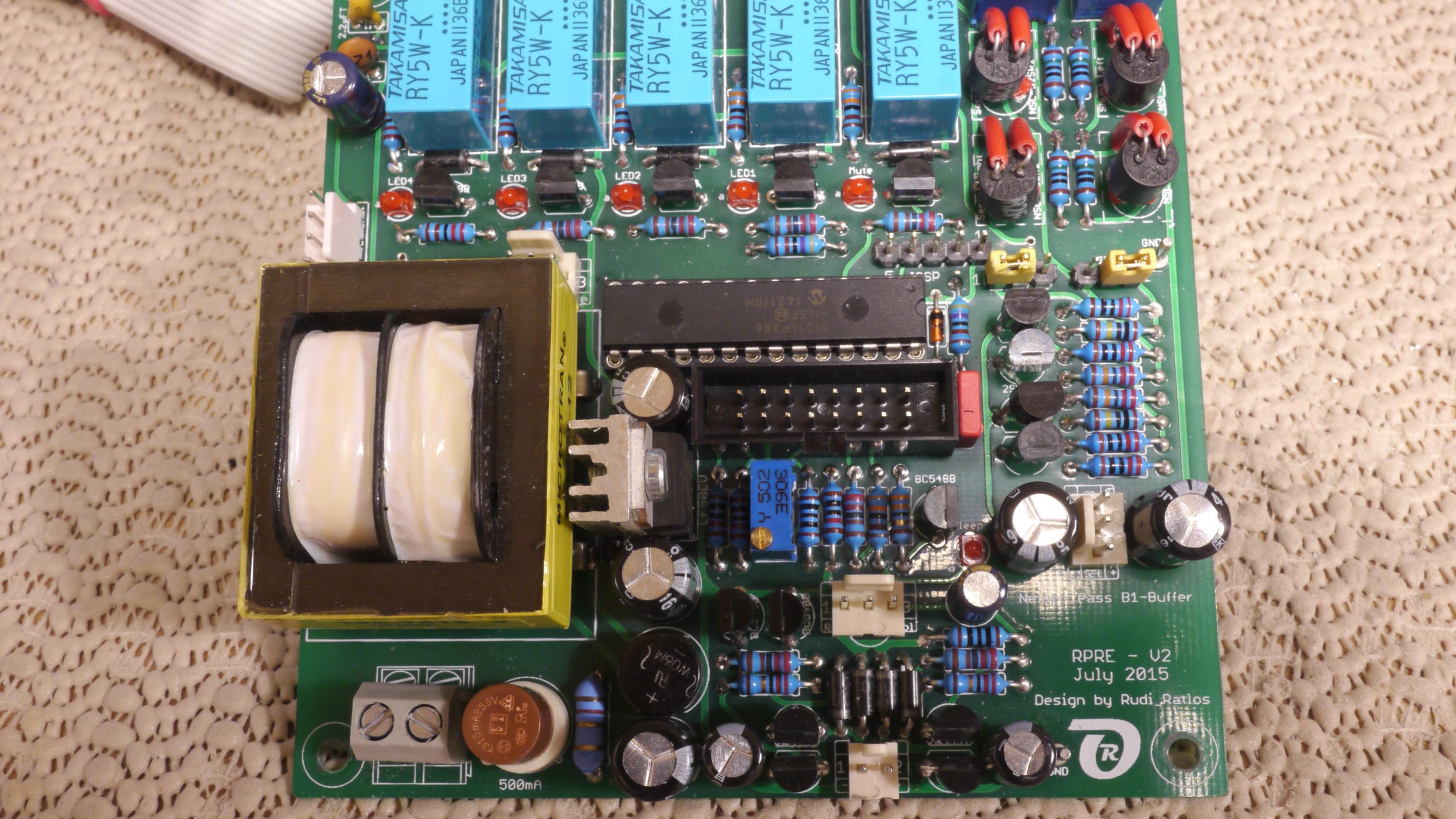

Hi All,
It's been a long time since I started this project, but I had some focused time this weekend to work on it. I've got it all mounted in the case, and was doing some testing today.
I have a rather odd condition that involves the remote and volume control. Regardless, of the orientation of the power pins, the volume control works just the opposite of the way it should. When you turn it to the right, the sound goes down, and the left it goes up. Rudi mentions in the build guide to simply reverse the power leads to the motor to correct this which I have done to no avail.
But here's the truly bizarre part... when you do press the remote volume buttons, when you stop pressing the volume keeps going. It continues until the pot is all the way turn up or down! 🙁 Not good. Has anyone else had this problem. All the other functions of the remote work correctly.
Any suggestions on where I might start to look for the problem that might be causing this?

Rick, pull of the 2-pole motor-connector and turn the potentiometer manually.
Does the problem (volume becomes lower when you expect it to become higher) still exist? Then swap the 2 outer leads of the 3-pole potentiometer connector.
There is a problem in the firmware of your PIC-version.
Please give me a picture of your PCB (so I know the version/revision), and I will send you a new PIC-processor with the reported error corrected.
Best regards - Rudi

As Rudi suggests, you need to reverse the wiring on the pot. The easiest way is to extract the pins from the connector (shunt and serial) and swap them over (not sure if it makes a difference but I'm using the Alps pot).
Rudi, the firmware you sent did the trick and cured the other problem that Rick is referring to with the volume control. Thanks for the great support.

Rudi,
I reversed the pins on the 3-pin connector and it does operate as a normal volume control now - manually. Here's a picture of my board. Send me 2 PIC processors Rudi, as I have another board I'm putting together as well.

Rick: each PCB-version has its own PIC-firmware, since I am using different assignments of the PIC's in-/output pins. So the firmware is not downward-compatible.
Why did you flip the transistors of the simplistic Pass B1-buffer?
Aren't they 2SK170s?
Best regards - Rudi

Excuse me, Rick: you have soldered the 2SK170 the right way!
I remember that I have used a wrong EAGLE-library for the 2SK170 in the PCB version that you have, and asked you to flip the transistors.
Best regards - Rudi

Remember, this is one of my boards that you put together to test everything and sent it to me assembled. That why I assumed it would work out of the box. So I didn't flip the transistors. I believe I read on the forum thread, or your instruction that they needed to be flipped.Rick: each PCB-version has its own PIC-firmware, since I am using different assignments of the PIC's in-/output pins. So the firmware is not downward-compatible.

Yep, had the same volume 'feature' with my Rpre
Which was fixed by some mailing and the replacement PIC Rudi sent me.

When I was testing mine yesterday manually on my bench, it did sound very nice - even in a non-critical listening environment. Can't wait to test it with my latest First One amp that is simply amazing sounding. 🙂 All other functions of the remote are working as expected. Now it's on to the 2nd board I will using in an integrated amp with a Raspberri Pi. 🙂Which was fixed by some mailing and the replacement PIC Rudi sent me.
