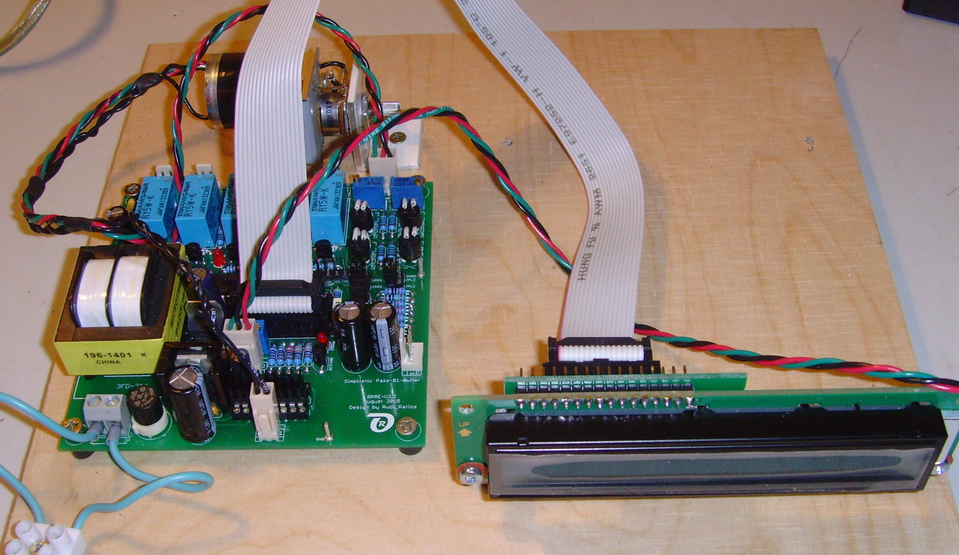

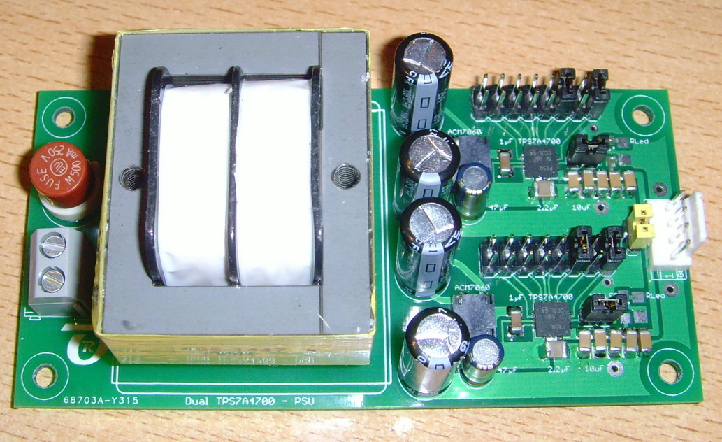

I received the TPS7A4700-PSU - PCBs back from Ales, could not resist and soldered a PSU immediately.
The PSU-PCB works as designed!
I jumpered the TPS7A4700 to give a +/-11VDC on the output (to be used with the RPRE's B1-buffer).
I will now start and send you your orders/parcels.
Aradan: tomorrow, then Speakert, then Myint, ...
I wish you a sucessful build - Rudi_Ratlos

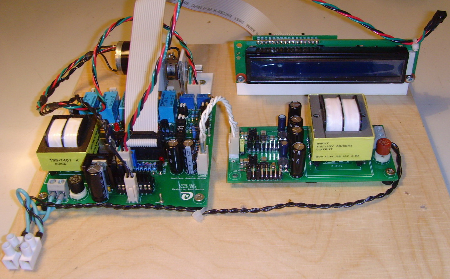

I can no more compare the "sound" of my RPRE, being driven by a dual LT1763-PSU, with my RPRE, being driven by the TPS7A4700, simply because I do no more have the LT1763-PSU.
I can compare the "sound" of the "SALAS Simplistic B1 Buffer" with my current setup.
I do not hear any difference.
Comparing the efforts it takes to build the shunt regulator on the "SALAS Simplistic B1 Buffer" and the dual TPS7A4700 -PSU that I have done a layout for:
you do not need matched components (f.e. LEDs), nor do you need heatsinks, ..., the transformer is "on-board", ... 😀
Another very nice gimmick that I found out: "the simplistic B1-buffer sounds better", when driven by +/- 11VDC output voltages (rather than by +/-10 VDC output voltages),
and to change the output voltages of the dual TPS7A4700 - PSU only needs different jumper settings.
Best regards - Rudi_Ratlos

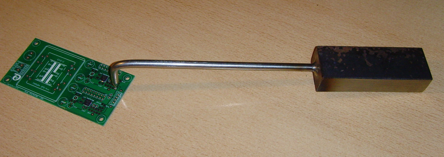

Gentlemen, I have asked Santa Claus to give me a 3rd hand this year: my right hand to hold the solder iron, my left hand to hold the roll of tin-solder and the 3rd hand to hold tight a SMD-component.
Find attached some images of what Santa Claus and his helper Andreas (a German DIY-friend of mine) have put into my boots!
http://abload.de/img/pre010gvkxi.jpg
http://abload.de/img/pre018jrscr.jpg
http://abload.de/img/pre005n1uom.jpg
The result (f.e. soldering the TPS7A4700-PSU for the RPRE's integrated simplistic Nelson Pass B1-Buffer) nearly looks professional, doesn't it?
I hope that these pictures will inspire your DIY- instinct and will take away any fear from soldering SMD parts!

Where did you buy that third hand for holding SMD-Parts.
Ronny
I like it! Simple, but genius. I have used very,very small alligator clips in the past, but sometimes they get in the way a bit. And you can only use them on the edge of a PCB board, so they are limited. This is a much cleaner solution.

It's the weight of it that holds it in place.
Aradan, I hope that the attached image will give you the needed insight! 😀
Just go to your local locksmith, give him a bottle of wine, whisky, some cigars, ..., whatever he likes, and he will make you this tool!
Redjr's answer has been perfect! The "SMD-part" won't move a µM, and you have 2 "free" hands to solder it!

Completed the PSU PCB - works great and is set up for 11V.
I just used the same soldering technique as is used for the Micrel voltage regulator.
The result looks a bit rougher than with Rudi's "Orthophon" thirth hand (never knew Rudi was that heavy into vinyl 😀) appliance for keeping the SMD's in place, but hey I'm there...
Almost there with the RPre too, still some minor thingies, after that I will hook it up in my enclosure. It will replace a previous RPRe version (NO, it is not for sale!), which works great and sounds even better! (i.e. awesome!). Only reason to replace it is the volume adjustment speed, which is a bit on the slow side in comparison to that of the current build.
@Rudi: are the SPO PCB's still availlable? I like one, it's handy to switch things on and off along with the RPre!
