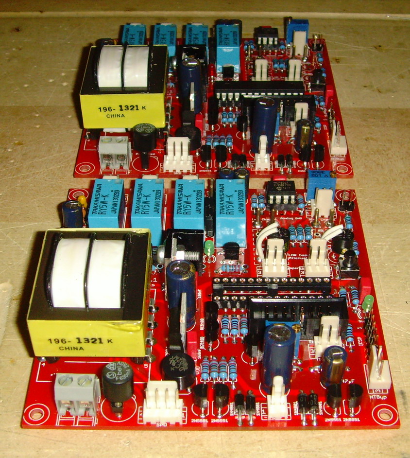

Find attached a picture of my build of the current VCPre V2.1 PCB.
Best regards - Rudi_Ratlos

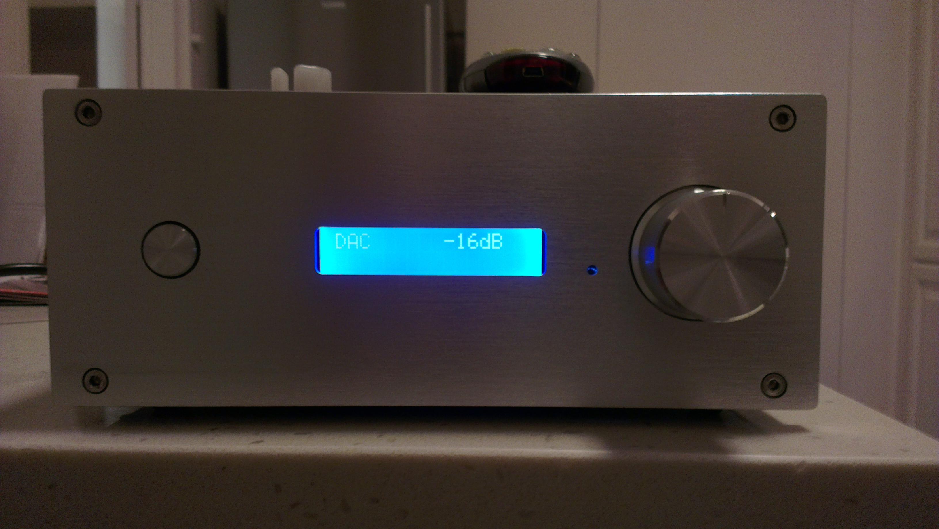

Hi Rudi,
Thanks for your kind remarks. The case was from ebay although sadly the front panel linishing is not as good as it could be.
See : New Version Aluminum Case for PGA2311 CS3310 Preamp | eBay
Also in order to get a PCB to mount the LCD and IR sensor I also bought this :
PGA2311 Volume Panel IR Remote Preamp Kit with Infrared Remote Control | eBay
I wish there was a way to just buy the LCD mounting PCB. I did end up using the LCD from the kit above though. 9mm spacers are also required for mounting the display and power switch. Haven't been able to get the cheap remote that comes with it to work though. Probably is is RC5 but a different frequency.
Best regards, Paul

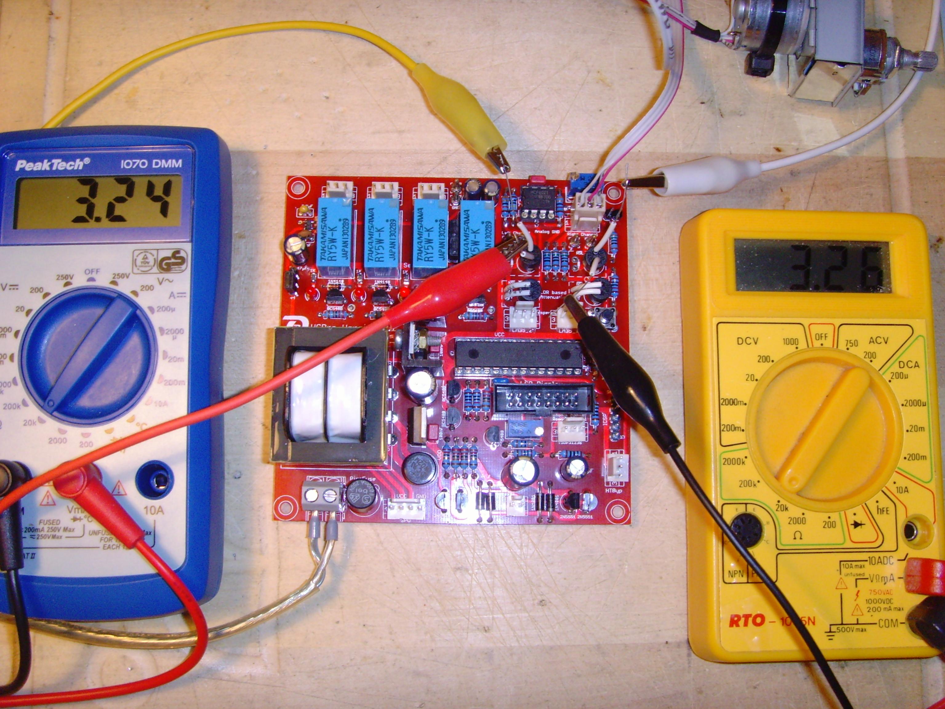

I adjusted the LDRs of my current VCPre V2.1 build today (see image attached), according to the procedure that I have documented
in the VCPre's Builder's guide.
Uriah's LDRs are really well matched!
