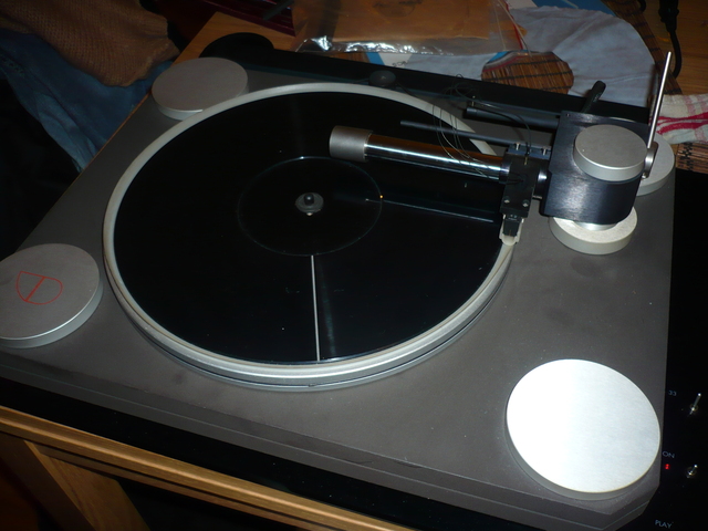

Since I just acquired a 1.2 in need of restoration, it seems like a good idea to start a thread on the topic... mods too...

No, the Versa is a belt drive with a uproc controlled stepper motor.
The stepper is very likely to be replaced, although we shall have to see about that in a bit...
_-_-
The 2.0 came first (oddly enough) and has a full air bearing under the platter with vacuum hold down.
The 1.0, 1.2 has vacuum hold down, but no airbearing.
_-_-

Yes the factory design is a microprocessor controlled stepper motor... lots o torque.
The 1.2 does NOT have an air bearing for the platter, it does have vacuum hold down.

I think he means how the air escapes from the arm carriage? It looks like the air is fed to the carriage rather than the tube......
yes air is fed to the moving tonearm part... what the means of distribution in the bearing surface is I am unsure, haven't had one apart in a decade, and the one in the picture is due to arrive later this week, in pieces... 😀

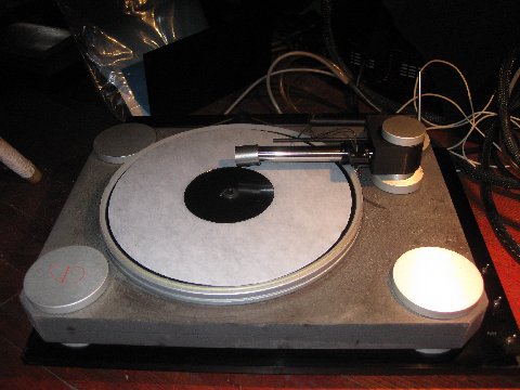

Hi Bear
I had you contacted some time ago about the Versa.
Since then, I found one in France (the only! ) in working condition but I had a lot of work on it for reliable operation. I contacted the designer (John Bicht) but it is not very talkative about his turntables and you must pay for information . So I managed alone and with the help of a very nice gentleman met on vinyl engine (Tube4life) which has a 2.0 and 1.2 that knows them well. Thanks to him I got it working without problems.
If this many people interested in France, I will make detailed pictures of the turntable and arm .

What exactly needed work on your 1.2??
Could you be detailed?
_-_-bear
PS. I got my shipment today, and was surprised that the "paint" on the chassis seems to be some sort of rubbery substance... very damped, but prone to pick up dust...

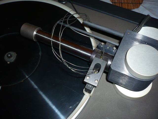

Ok, Vincent -
You have the earlier 1.X without the removable "head shell".
But what are those two shiny things on the rear side of the moving arm part??
There was some sort of "eddy current" damper said to be installed on some units,
wondering if perhaps this is it, and if so, what the details are (closeup jpeg might work)?

Hi Bear
Yes, I have a version 1.0. The difference lies mainly in the removable" head shell "
The two shiny things on the rear side of the moving arm part are just guides for additional counterweight to the cells of more than 7.5 grams. There is no "eddy current" damper, just on 2.3 and some 2.0. If you want some detailed pictures, it will be with pleasure. I'd love to know how you change the wiring arm. If you could take some pictures when removing it would help me.

I'd like to see a diagram or pix of the "eddy current damper"...
