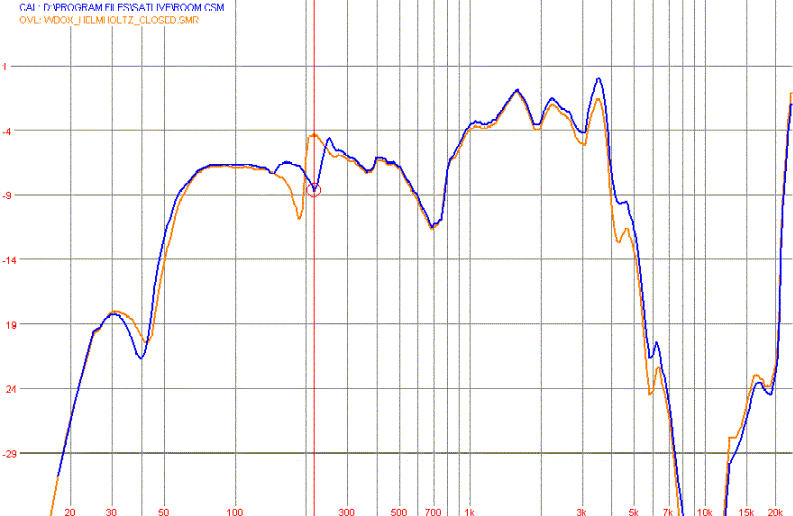

Zozo:
Thank you for posting those drawings. We now know that the enclosure that belongs to the response graph was very tall and skinny, just like the Pioneer.
One more question. You said that the response came from an enclosure that had no stuffing.
My question is: is the response graph for an empty box without any dividers or plates?
Or was the response graph for an unstuffed box but which had those dividers or plates in them?
The reason I ask is that your "spike" seems to be of considerably less amplitude than the Pioneer "spike". We now know that both enclosures were tall and skinny. I am wondering if the considerably reduced amplitude of your "spike" was due to the fact that the dividers you put in the enclosure cut it down quite a bit.

kelticwizard said:Zozo:
The response graph belongs to a completely empty cabinet. No braces, no plates or whatsoever.
Zozo
Zozo:
Thank you for the explanation.
I seem to remember the Pioneer frequency response chart-the Pioneer was 48" internal height-as having a "spike" of much greater amplitude. Like 8 or 10 dB each direction. and that was with an inch of stuffing on the internal walls.
Yet your unstuffed pipe, a little shorter but of very similar proportions, shows a "spike" of about 3 dB each way.
Once again, the mystery deepens. Or once again, my memory fails. One or the other. 😀

kelticwizard said:I seem to remember the Pioneer frequency response chart-the Pioneer was 48" internal height-as having a "spike" of much greater amplitude. Like 8 or 10 dB each direction. and that was with an inch of stuffing on the internal walls.
An inch of damping is going to be negligble at the frequency of interest.
dave

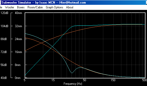

7V:
First, I would like to chart the frequency response chart for a woofer in both a well designed vented box and an enormous, (600 L) sealed box. The sealed box of over 20 cu ft is meant to simulate an infinitely long and infinitely high wall.
The speaker is 8 ohms. The drive level is 50 watts, (20 volts).
Qts = 0.38
Fs = 30 Hz
Vas = 56 Hz.
The orange is the speaker in an infinite baffle, (600 L).
The light blue is the speaker in a vented box of 56 L and tuned to 30 Hz.
The only difference between the infinite baffle and the dipole is that the bass is better because the bass cannot wrap around the baffle and cancel the front wave. If the speaker were unenclosed, the bass would have a worse rolloff that started sooner from that effect.
Notice that even though the Closed Box-of which the Infinite Baffle is a variant, has approximately the same cone excursion as the Vented Box. Yet the Vented Box has a reputation for driving the speaker into wild cone excursions.
The reason is that if we had the speaker unenclosed and kept adding more power to it at, say 20 Hz, the speaker's excursion would get gradually larger right before our eyes. the large excursions come as no surprise, since it is a linear result of added power.
The Vented Box tightly controls the cone excursion right down to the tuned frequency. Then, suddenly, it lets the speaker go and revert to it's unenclosed behavior.
It looks like the cone is spinning wildly out of control. It is no more out of control than than an unenclosed speaker. It is just that when the Vented Box goes below it's tuned frequency, it "goes dipole" real quick, and it looks like it is going crazy.
The rise in cone excursion is a measure of how fast a Vented Box-a Helmholtz Resonator-"goes dipole" once it passes the tuned frequency.
By the way, the excellent freeware program I used to illustrate this is Subwoofer Simulator by our own F4ier, downloadable at the following URL:
http://www.geocities.com/f4ier/speaker.htm
It simulates many boxes and charts impedance, impedance phase, and about a dozen other things.
Now, the reason for all this is to illustrate that above the tuning frequency, the air does not escape from the box. If it did, the Vented Box would resemble a dipole at all frequencies, and it would be essentially useless as an enclosure.
The Vented Box goes through three phases.
Phase 1: From the highest frequencies down to an octave or so above the Helmhotz tuning frequency, it is identical to a Closed Box.
Phase 2: From an octave above the tunig frequency, (Fb), down to the tuning frequency, it is a Phase Inverter. It reversed the phase 180°. If it did not do that, the output from the back of the speaker would come through the vent and cancel the output from the front of the speaker. Instead, the output from the back of the speaker gets it's phase inverted, and reinforces the output from the front. In fact, at Fb, the output from the vent, (which is completely generated from the back of the speaker cone), is four times the output from the front of the cone!
All that is due to phase inversion in the octave directly above the tuning frequency.
Phase 3: For frequencies beneath the tuning frequency, the Vented Box reverts to a dipole, as the cone excursion graph shows. The now-uninverted back waves leak through the vent to cancel the front waves, as if the enclosure did not exist.

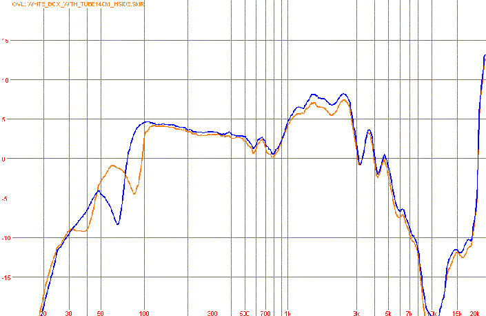

When I played around with the two chamber setup I didn't pay attention to calculations, because I wanted quick results and also had several other options in mind like the TL like setup and others. Nevertheless here are the measurements.
I have divided up the enclosure at around the half and first put a 14cm long tube inside then a much longer one, about 1m. I still have the folded tube, so I can make a measurement on the length if it is important.
So, the enclosure :
... and here are my measurements. These are a little bit different from the first one I posted and this is because I didn't use XO with these ones, so just the woofer alone.
The blue curve belongs to the longer tube as you might guess out. There is no sign of standing waves (at least no spike), but the woofer starts to roll-off much earlier.
I was thinking of using longer tubes (around 2-3m) to extend the rolloff frequency, but finally started to try other options.
I think the problem with this setup is that the tuning frequency gets higher as the woofer doesn't see the whole enclosure behind, only the half of it.
Zozo
