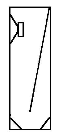

pinkmouse said:Or you could always build your box as a terminated TL, no chance of standing waves then!😉
And so as not to be accused of being off topic, it is a divider, and it is vented at the bottom😀
I don't think you'd want to vent a terminated TL (since that unterminates it), but the pic pm shows is a good trick done in midrange enclosures and i don't see why it wouldn't work here. Doubling the path length halves the resonance and tapering it moves it down some more. Progressive damping to absorb all the energy and you have something like the B&W Nautilus.
dave
I meant venting as in the divider not going all the way to the bottom, i.e. it vents one side of the interior to the other😉😀 😀 😀
In a closed box, the standing wave problem could be solved with damping material - end of story. However, isn't one of the purposes of this discussion to explore alternatives to damping, as damping can cause a "deadening" effect on the sound?

I can also see advantages in doubling the box length as pinkmouse and planet10 have pointed out.
One concern I do have, bearing in mind that I tend to use full-range drivers, is that the upper mids and high frequencies are reflected straight back at the drivers rather than down the cabinet to be absorbed by whatever damping is down there. Is more damping required to fix that?
Steve
Steve
7V said:I can also see advantages in doubling the box length as pinkmouse and planet10 have pointed out.
Steve
You can play around with baffles all day🙂
7V said:The TL and Mass Loaded TL solutions are interesting but do they solve the damping problem or is damping material still required?
Yes, but less
In any case, I seem to remember from A. Bailey's original articles on TLs that he said that the line could as well be open or closed. If we do nothing with a tall, narrow enclosure we could claim that it was a terminated TL
Yes, but ideally for a closed line we would like it to be a 1/2 wl of the lowest notes, and for an open ended TL 1/2 wl.
pm's drawing makes the line longer, it eliminates a pr of parallel walls, and it acts as an effective trapezoidal brace for the cabinet walls it is between.

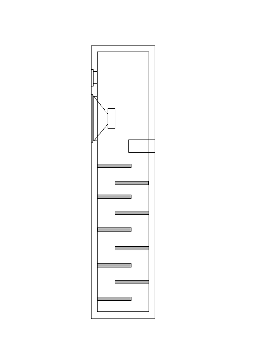

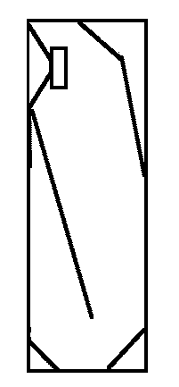

Kelticwizard,
The internal dimensions of the box I experimented with (in meter) : 0.97H x 0.2W x 0.17D.
I attach here two layouts wich worked the best for me. The first is rather a TL like approach, while the second is a combination of the TL and Helmholtz chambers. Both can reduce the spike, but also the Q of the vent, therefore I think it is important to tune the chamber(s) exactly to the frequency of the standing wave as you and others already pointed out.
Zozo
