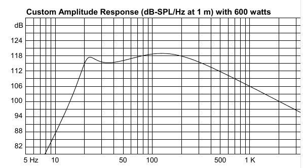

Here from the eminence Lab15 cabinet design document are 115 to 118 db from Large vented deep bass box page 10 to 20 hz and 120 db from small vented box page 13 to 40 hz. Both at 600 watts, both require high pass filter as described in the document to avoid excessive excursion. See Eminence.com
