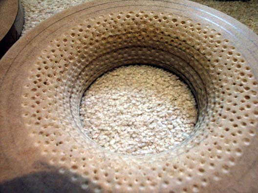

Its not as bad as you think ... with a hammer and hole punch I get about one dimple per second 😉 .... working like this >>>
in a hurry I'm almost as quick as that lil yellow guy!
