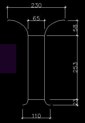

I quickly modelled the XLS in that box in WinISD pro beta, and got slightly different results. ~60 m/s in the vent with 300w input with a 65mm vent. Hmmmmm interesting. Also managed to get <34 m/s with 90mm vent.
Still, the point is, B&W got it right with their design, if they can get a 65mm vent to do what I would have used a 90mm vent for. I will definately be exploring this option!!!
The tuning at 29 Hz seems a bit high, I wonder if they are in fact using the downfiring vent to lower tuning, as 25 Hz looks a bit better.
Does this look right Rabbitz?
OK get this Paul which makes it even more remarkable:
On your sketch-
58 is actually 62
23 is actually 29
253 is get this 162
Total length including flares 253.
I did my modelling in LSPCad lite so maybe a bit different and I haven't worked out how to model this port. I had a rough idea of the Fb in the box it came out of so to lower the Fb I made some assumptions and increased the box size.
So Vb goes up, Fb goes down with the same port...... Newton's 18th law maybe ;D
Thanks for clarifying. I'm trying to work out the idea behind the way it is flared. In a flare there are 2 vectors. Supposing x is parallel to the diameter of the vent and y is parallel to the length of the vent. They have made x greater than y. Due to the inertia of air moving parallel to y, I would have expected this dimension to be greater. Any ideas why they would do it this way?
I suspect them paying more attention to the flare underneath is not as this is more optimal, but that the inside flare is just not as important.
The inside vent is just one out of their parts bin common with a lot of their speakers and I'm sure the configuration of the external port would be determined from that it is downfiring.

Getting back to my vent options, of the 3 I posted in the image, I like the one on the left. Can anyone see any problem with the location of the inside vent opening being so close to the driver?
