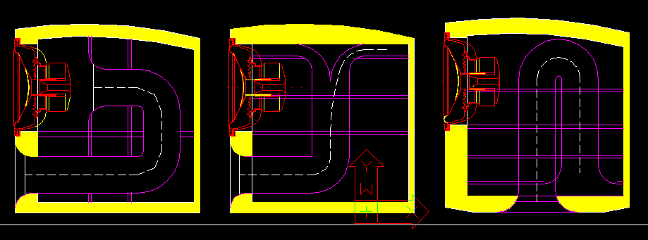

Here's a few concepts I'm working on:
right
the clearance around the vent is deliberately less than it should normally be to extend the effective length. A local speaker builder tells me you can get 2 - 4 Hz lower Fb using this method with a downfiring vent. I have done this on both ends so they are symetrical. Not enough clearance around the internal vent, though. This option allows the largest possible vent diameter or the lowest possible tuning.
middle
same concept but only done on the internal vent. The interior should mask any turbulence caused by this technique, although the cone shaped piece should prevent this.
left
uses a larger 120mm vent - tuned higher ~24.5 Hz. A side benefit of this may be that there is some extra cooling. The vent is placed less than the diameter of the vent near the driver magnet, however this should have both a cooling effect and should if anything, lower the tuning. I'm concerned that placing the vent facing the driver may have some problems however:
* turbulence from the driver itself which would normally be masked
* will it couple to the box in a different way and not function correctly since it is facing the driver?
Dashed line shows the effective length.
Thoughts? Opinions on these approaches anyone?

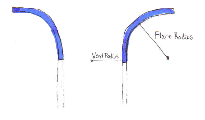

Hi Paul
I call any radius on the flare which is more than the radius of the port extreme as at the outlet it would be more than twice the diameter of the port. These would show more compression and distortion at higher SPL's. Asymmetrical ports with smaller radius on the inside are supposed to be better at reducing distortion and compression.
There was some work done by some guys as JBL and Infinity, preprint 4855 from 105th AES convention 1998 on ports (no I don't have a copy but someone around here might and you can get it from their website if you pay for it).
When it's all said and done, to reduce chuffing etc, the only way is to increase the port diameter and flared port can help greatly and I've seen stuff around like a 3" flared is like a 4" straight port. There is some formulae on diysubwoofers but it relates only to if you have no, 1, 2 flares on the port.

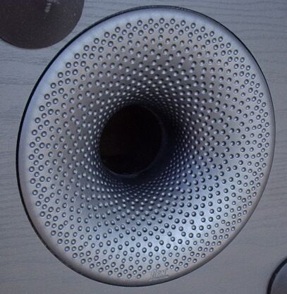

I've posted this before but the B&W flowport I use should chuff like mad but doesn't and it's only 65mm for a Peerless 10" XLS. The flare radius looks bigger than it actually is as they use an involute curve so the further out go go it's more like a taper than a radius.
you know I really wonder if all those little depressions they put on that flowport really help that much. I think there is some bit of confusion about what you meant by radius on the flare rabbitz. I think I understand though, and I have drawn a little picture so you can tell me if I'm right. flare radius could only describe flares that are circular arcs and not some conic or perhaps a shape that isnt defined by a simple mathmatical function. End correction for different flares is surely different.

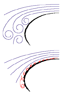

B&W have info on their site in their tech development section, quite interesting. It's very much like golf balls. I don't think it is a gimick. As I understand, it creates very small eddies that introduce a boundary layer of moving air on the edges - I think it is the acoustic/aerodynamic equivalent of sliding down a wet slippery slide vs bare skin on dry hot rubber! OUTCH!
This makes the air follow the shape of the flare better, helping it overcome the inertia where it wants to move straight out the vent, which creates turbulence between the rapidly moving and the stagnant air.
This diagram shows the idea
Supposing a port were not a simple radius. If we define it by two vectors instead, one parallel and one perpundicula to the direction of the vent, which should be bigger. I would say it might be an advantage to make port flares so that they extend further along papallel to the direction of the port, as this goes with the inertia of the moving air.
With standard flares of a given radius, or close to it, like the Precision ports, it seems you can take the effective length to go up to half of the length of the flare. This may change with different flare shapes.
paulspencer said:BA,
B&W... <snip> ...very much like golf balls. <snip>
Golfers a long time ago noticed that the older and more beat-up their balls were the longer they would fly. The physicists got ahold of this and now golf balls are all dimpled for good reason: reduced drag. The air has a harder time holding on to the dimples. This would probably get you better fuel economy in your car, but who would buy a golf-ball looking car?
Anyhow, for reducing surface tension of air to a solid surface, the concept is pretty good.

BUMP! ... no comments on the three designs anyone?

This will give you a better idea of the dimples which are 4mm dia x 2mm deep. The ones near the port tube are smaller. It would be easy to make the dimples in MDF but the layout is not so easy plus heaps of time. The inside flare is also dimpled BTW, but heaps less a smaller. Here's a pic to show you a bit more detail.
What is the diameter of that flare at the largest? What is the diam of the smaller dimples? I didn't think they would be that big!
The port flare is 230mm outside diameter....... yes 230mm for a 65mm port. The smallest dimples are 2.5mm x 1.25mm deep.

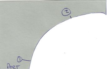

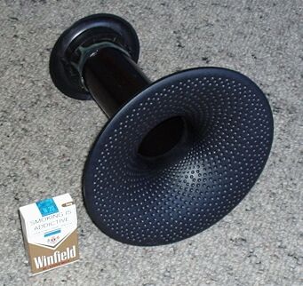

To give you some idea on the value of this thing is that it's for a Peerless 10" XLS, Vb=35 litres, Fb=29Hz.
This port is 65mm dia x 253 long which should give a port velocity of 90m/sec at 200W and 65m/sec at 100W so it should chuff and bang like crazy but the sucker doesn't.
To get a port with acceptable velocity of less than say 30m/sec, I would need 115mm dia x 893 long with a port velocity of 30m/sec at 200W and 22m/sec at 100W.
So there is definitely something happening with this port.
Here's a profile with the port starting at 32.5mm R, slight taper up to point 1, 65mm R (same as port dia) to point 2, then a taper with a slight curve up to the end. The distance across the top is 115mm and the height from the port to the flare in the vertical is 65mm. So the radius and the height is the same as the port dia. How much is cosmetics and how much is for sound.....dunno. BTW, this is for a downfiring port.
The inside flare has a dia of 110mm and looks like a stock part from the 7 series B&W's.
Hope this info helps.
