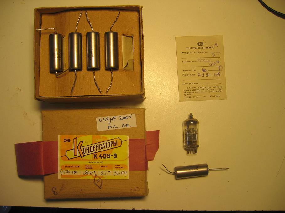

Which coupling cap (1µF) did u used? I have some Angela MKP 630V types that I want to try. (small size)
Cheers
I used these russian caps. I had also four of 1uF. Two of them are now in the amp, and the other two will go in my speakers.
I also used these in my BoZ, which improved a lot over the Wima MKPs that were installed first.

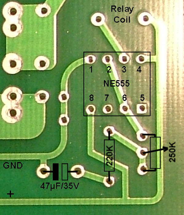

For some reason my relay doesn't work with the delay circuit. If I apply a voltage on the relay's coil it works, so the relay isn't the culprit. No load voltage is 10,12VDC. I have a 250K trimmer + a 220K resistor.
The regulator circuit for the heater supply works fine.

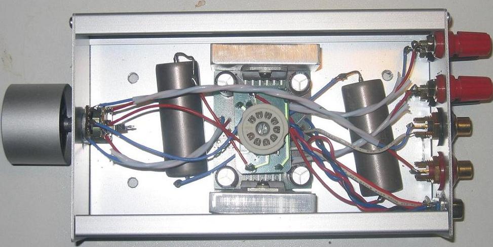

Looks good inside Hanzwillem; I assume that the heatsinks of the LM3875 are connected to the enclosure? Otherwise i am not sure you have enough heatsingarea for long and loud playing music with the amp.
I see that you do not use shielded wires for the inputs (to the potmeter, and from the pometer to the amp). Maybey that is the reason for hum?
Onother question: is there a schematic fo the pintout from the sub-D? a schematic that shows also the connection from pin 1 and 3?

Let's try to find the problem, look at the simple circuit below:
- is the orientation of the NE555 correct (not as printed as on the silk side)?
- Voltage between pin1 and 8 of the NE555 correct?
- some Voltage between pin 1 and 6 of the NE555?
- and the voltage between pin 3 and 4 of the NE555, after 20 sec?
Hardly, as there is no AC in the amp's box. It must be a grounding issue.

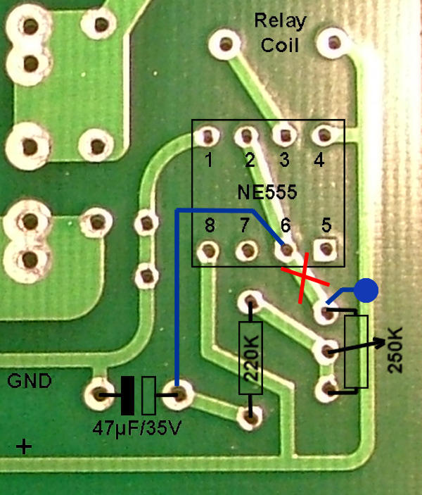

I am trying to figure out how this delay circuit is connected. According to your drawing and the wiring diagram of the power supply the 47µF capacitor is connected between GND and pin 2 of the timer IC. On the PCB this capacitor goes from GND in series with the resistor and trimmer. Also the resistor (trimmer) is on one side connected to the +VDC, I can't see that on the PCB. Am I totally missing the point here or is there something wrong with the PCB. The thing that strikes me the most is that Hanzwillem has a working amp, we all have the same PCB's do we?

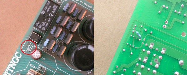

I build it exactly as in this post:
http://www.diyaudio.com/forums/showthread.php?postid=767836#post767836
a 470k resistor gave plenty of time to stabilize.
the only error on the two amp boards is the reversed tube socket. Just solder it on the other side and the amp can be completed.
I thought my post earlier (
http://www.diyaudio.com/forums/showthread.php?postid=790426#post790426 ) was pretty clear.
The silkscreen for the high current diodes only is wrong. Just use common sense and mount all diodes in the same and propper direction. I am not at home at the moment, so I cannot post a picture.

Here I am again.
The picture in the post that Hanzwillem is reffering to states that the PCB layout of the timer circuit is indeed wrong. If you put a resistor (470K) on the PCB with the small bridge (red circle) everything works. Zang should have been a bit more clearly what he did and why he did it this way. If you populate the board with the trimmer and the resistor you have to follow the changes I made.
If one follows the traces on the PCB and compare them with the wiring diagram it shows what is wrong with the timer circuit. If somebody knows how to put up a wiki page I will post all the changes that have to be made to get a good working amp.
