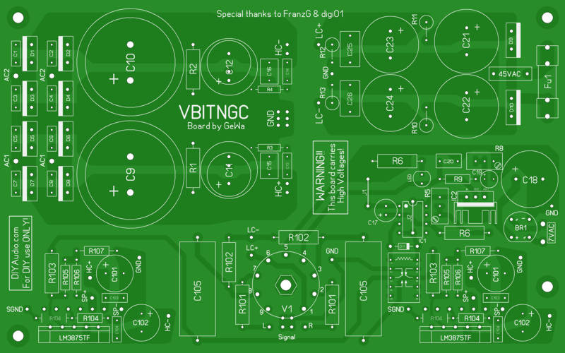

This is the final version now!
I've been checking the layout a few time now to make sure there were no screw ups and guess what......., there was one.
I took care of it and made a few small last minute adjustments.
Also been talking behind the scene with digi01 to get the boards made. Looks promising but for the moment he's a bit short on time so, be patient.
Regards

Nice board GeWa!.

Looks good Zang 🙂
It's weird to see these in reality now. I've seen the layout for so many hours on my screen, but still.....
I do hope that they are bug free and that everybody can finish the amp without troubles.
Regards
Regards

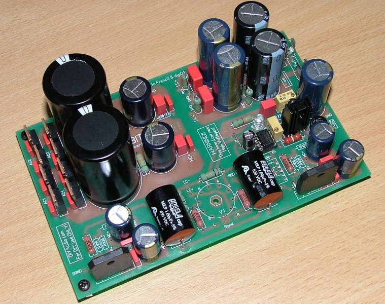

I'M BACK!!
Yesterday I received the long awaited board from Zang.🙂
It was a nice feeling to finaly hold it in my hands, although I've seen the thing for God knows how many hours on my screen during the development.
Couldn't wait to start stuffing the board to sadely realize I didn't had all the parts to finish it. In the attached picture you can see how far I've progressed.
The comments so far:
Nice quality of manufacturing
Very good layout (ahumm)
There are a few components that could used a bit more space, but nothing critical.
I will give an update as soon I have the remaining parts.
Regards
Regards

Look's good for sure. Is that a tube i see 🙂 ( I mean socket for one )
