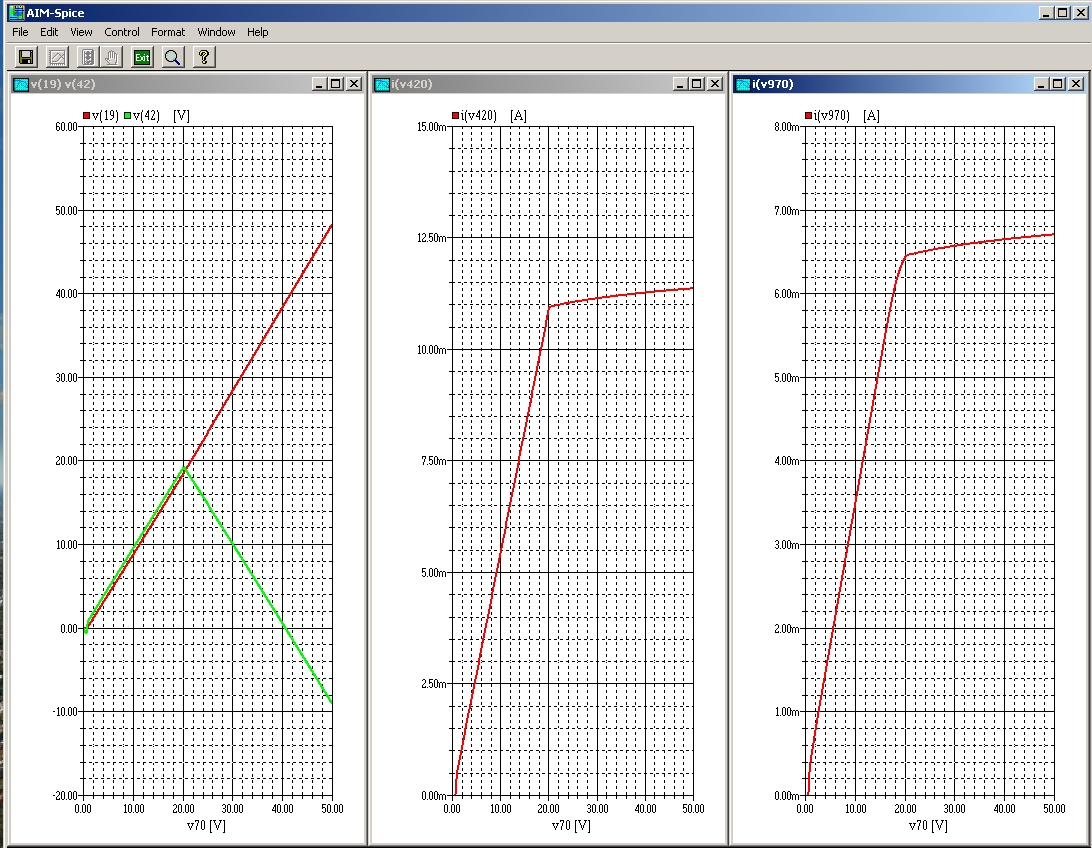

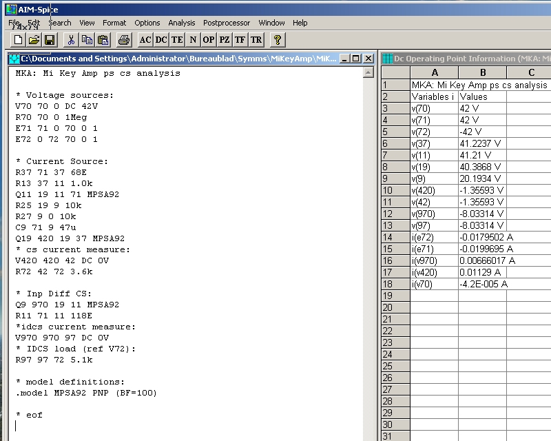

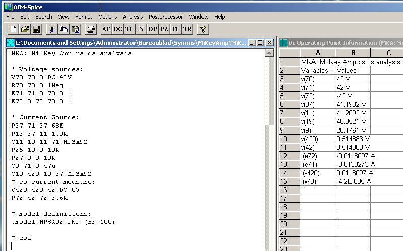

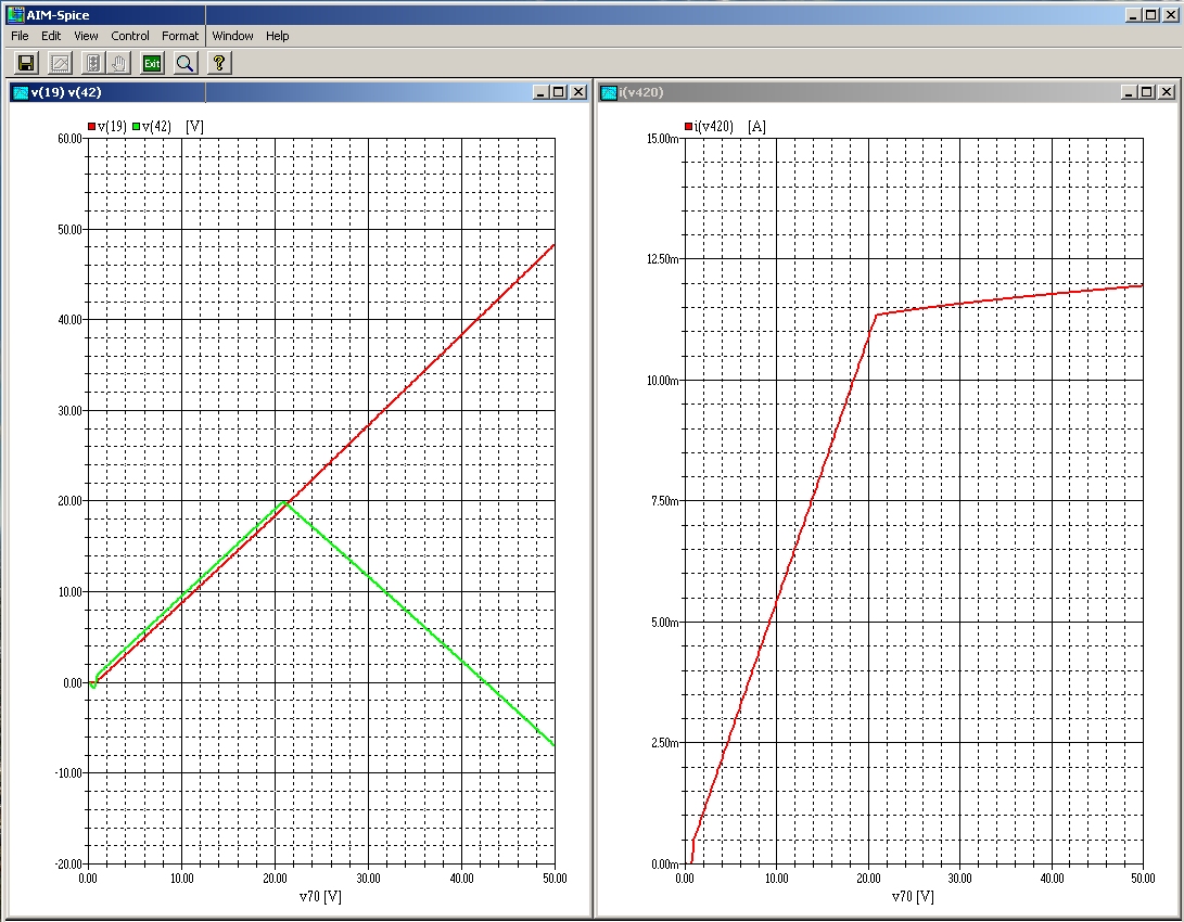

Did this fast analysis: problem is major in connecting input diff cs to Q11-Q19 cs. That's no good, very ps susceptible

... what I was refering to about the loads...

Single BJT bias generator with compensation resistor in its collector (as described in Mr. Self's book) is the best case of Ube splitter schemes. It's voltage drop is undependent from signal part of VAS output current and has close to symmetric transfer characteristic around VAS idle current. You can read about it on link in #25
Including the dc-performance of the input differential current source.
Keep in mind that this idcs dependency is amplified - in phase - to the bias circuit, rendering this topology to the quality of the ps instead of intrinsic stable. Hence the difference of 13 vs 39 ohms for R39. Feedback should only address one issue: signal control. No other fuss.
This is not my preference to amplification of audio signals, but granted.
