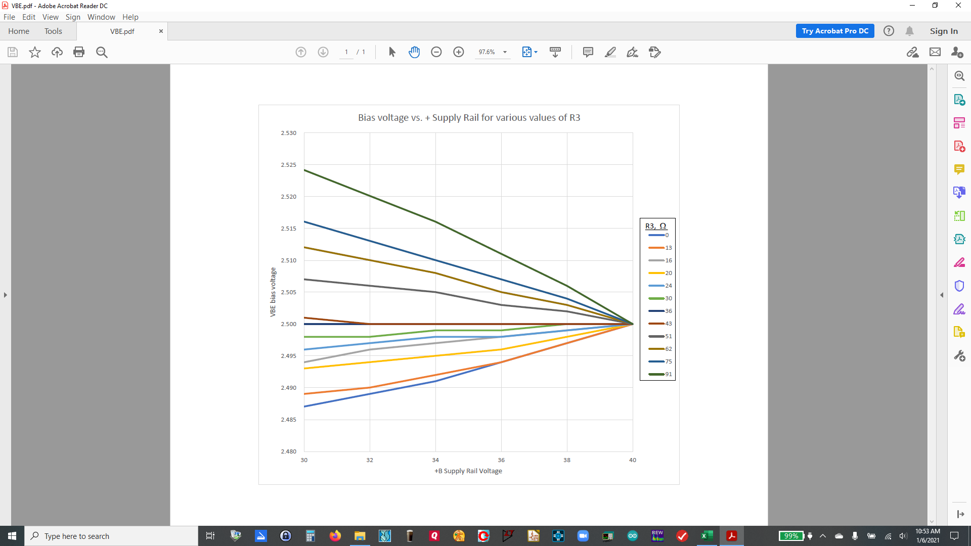

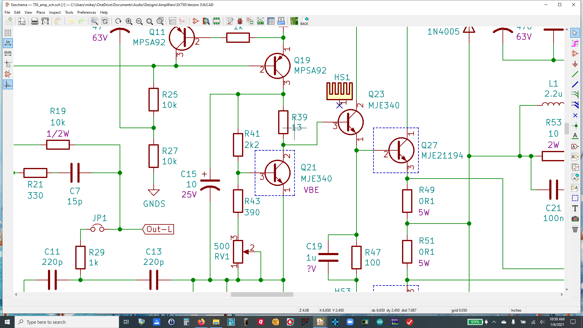

Wondering if anyone has done tests to optimize the value of current compensation resistor (R39 on the attached schematic) to minimize the shift in amplifier bias setting with changes in the +B supply rail voltage. If so, what results were obtained.
I just ran a real world test on various values of resistor ( 0 to 91ohms) and found the optimal value to be 36ohms, which is much higher than the conventionally suggested value of about 13ohms for the 10mA VAS current being used. Interestingly this agrees with the optimal value which my LTSpice simulations predicted while designing the amplifier. At that time I suspected my SPICE simulation was erroneous since it did not agree with what I read in certain books on amplifiers.

One thing to bear in mind is that you should not be trying to make a bias generator that does not alter its voltage with current.
What is needed is a bias generator which when combined with the output stage, gives minimal variation in the output stage quiescent current when the supply voltage varies.
It is a different target.

I did read your elaboration on that point last night (Self on Amplifiers v.6) and it sounds like it is not a simple matter to perform this optimization given the shifting points of driver/output devices with temperature variations. I will have to re-read that section again (slowly) and plan how to proceed.
I assume with these kind of bias circuits that the dc current flowing through it is constant when no ac signal is applied to the input (or this Hawksford - Early effect would kick in; ref #5).
So the optimum value for the bias compensation is different from the power supply compensition value. These are different phenomena and one resistor cannot perform two duties at the same time. But it is very interesting indeed.

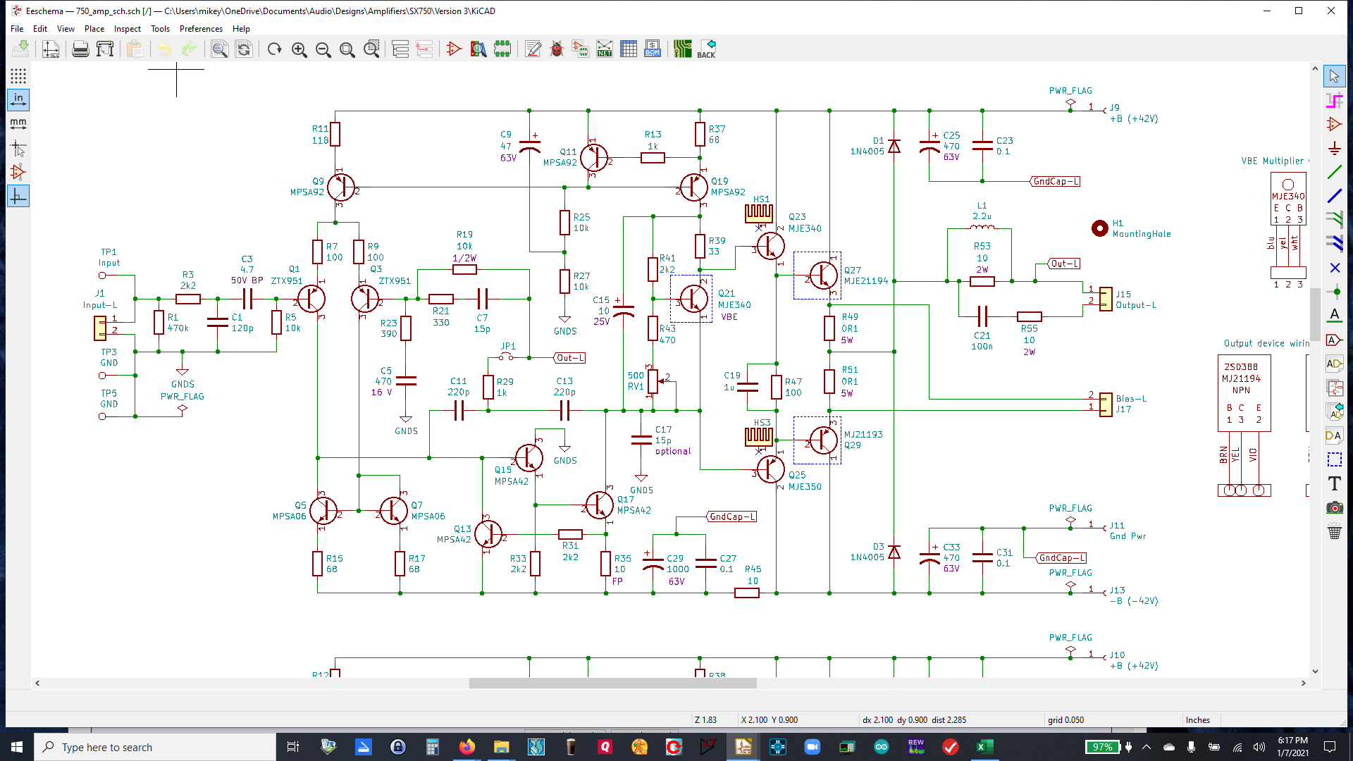

Can you show the rest of the circuit? By exchanging parts or segments of the complete circuit it could show less dependency of ps variation. The ideal would be to find the proper topology where R39 can remain the same 13Ω.
And measure it after building it of course to verify the simulations!
The only sure way is to build it and measure it.
SPICE representation of Early effect (which is at the heart of this) is rudimentary.

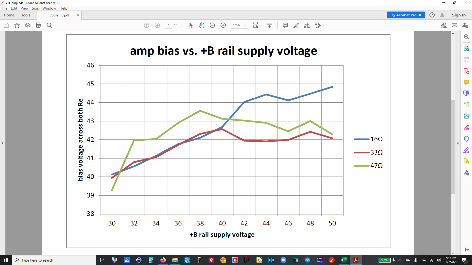

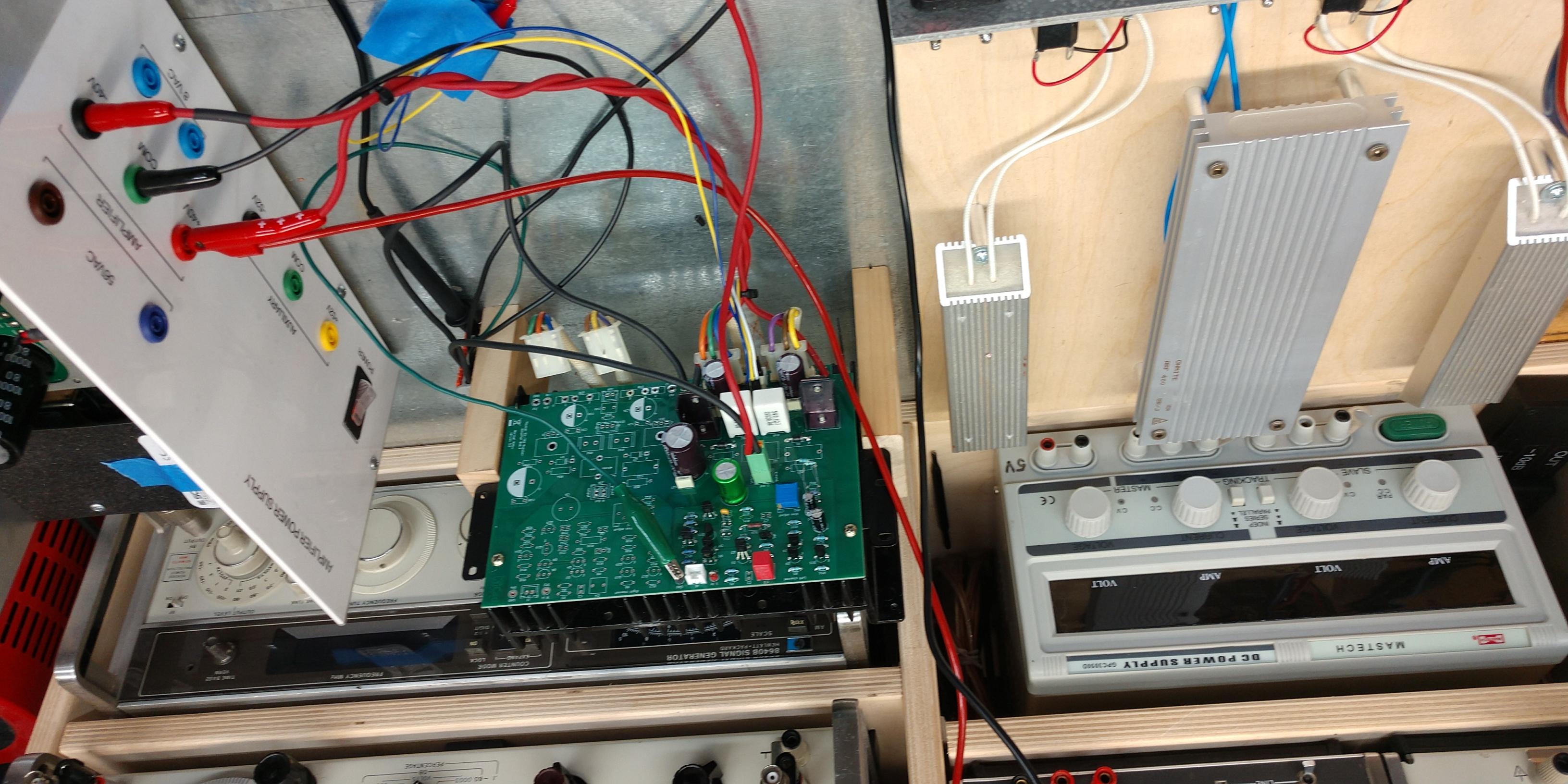

Thank you Douglas for your reply. I have done just that with three values of resistor (16, 33 and 47 ohms) on a build of my current amplifier board and found the results to be pleasantly in line with what I observed in SPICE calculations and with a breadboard buildup of the VBE multiplier subcircuit alone.
For my particular amplifier the optimal value for this resistor (R39 on my schematic) appears to be about 36ohms in all three cases. (I did not have a 36ohm resistor handy today). I apologize for the roughness of the data points in today's graph. They are actual measurements using the averaging function in my HP34401A DMM. (Please note the bias voltage levels (Y-axis) are in mV)
I think perhaps the simple calculation sometimes used of R = intrinsic emitter resistance (re) * VBE multiplication factor (4 in my case for two stage EF output) needs to be re-thought. I believe Douglas may have elaborated on this in a section is his tour-de-force on audio amplifiers Ver.6. I will have to re-read this material tonight and see if this is the case.

Thanks for the input. I have attached a picture of the whole schematic for one channel
I hope you realise I meant build the Vbe generator AND the output stage.
Yes Douglas. I did understand your reply and my tests today were on a complete amplifier channel. I found it interesting that my measurements agreed with the same findings that SPICE simulation and breadboarding just the VBE multiplier & VAS current source produced
(to close enough degree given I only used three resistor values on the actual board today due to the lack of resistor values on hand in the sub-50ohm range and the time involved modifying a PCB)
The current through the bias is set with the current source made of Q11 and Q19.
Take this section (Q11, R25, R27, R13, R37, Q19) in a separate simulation, give it a load of 4.2kΩ to the negative rail - the collector of Q19 will set around 0Vdc.
Then vary the rails to determine the ps dependency of this current source.
Curious to view the graph.
(I've no time now to simulate it myself and your models are unknown.)
Also, the input diff cs is also depending on these results.

From what I have seen a careful optimization of the current compensation resistor on the VBE transistor collector can very much reduce +B rail variance induced shifts in bias adjustment. I'm not sure if the value can be calculated or must be selected by tuning a finished amplifier design. The calculation I have seen suggested is not correct it appears. And there may be other ways (as suggested) of producing bias adjustment than the conventional VBE multiplier. But I had already designed this amplifier using a VBE multiplier and am now in the optimization phase on Version 3.0, which I expect is the last for this amplifier.
I believe the root of the problem is the sensitivity of the VAS current source to supply voltage variation. It is not a perfect current source. This issue is well known and the resistor R39 is supposed to compensate for it. My problem was accurately determining this resisitor value as the "textbook" method I had been using was just wrong.
