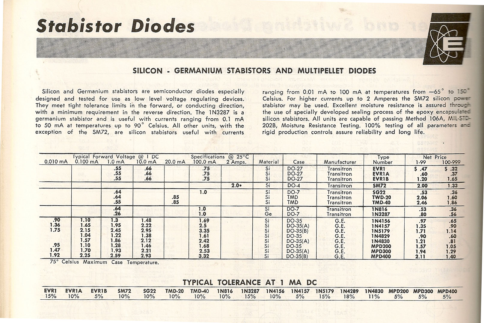

Just after the Earth cooled in 1968 we could buy multi junction devices.
both Germanium & Silicon. I don't recall any audio circuit using them,
but some power conversion ccts, AC to DC could put them to use.
Add to that the Unijunction Transistor used extensively in SCR control circuits. 👍

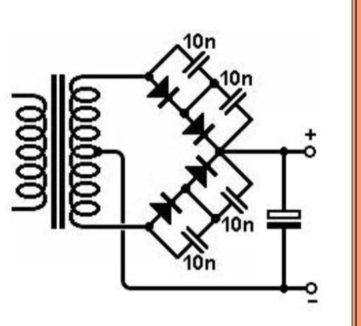

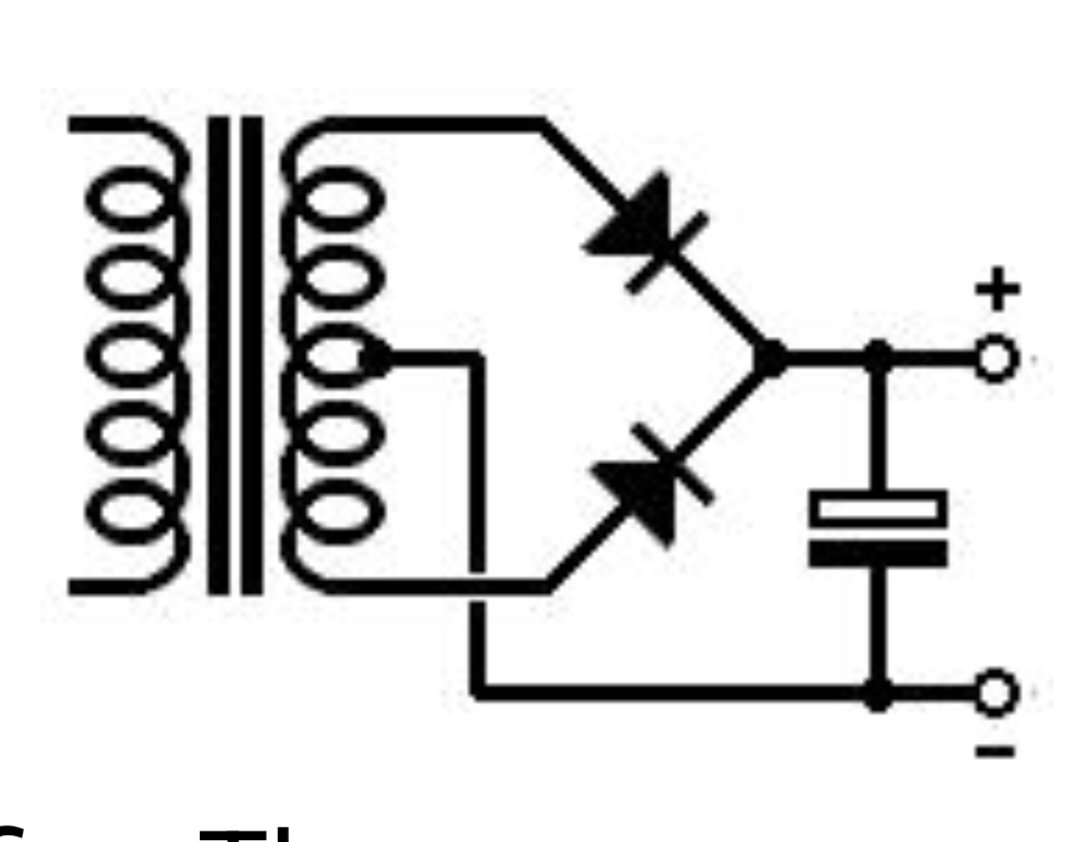

Instead of adding the rectifier back, do you have a couple of diodes that you could tack in place as an experiment to eliminate the rectifier tube?
Well, I will have only those that I have ordered, 1N4007, but I won't be able to test with those at full voltage (230v AC) unless I wire two in series with some ceramic caps as attached photo clippet from the excellent ValveWizard.co.uk website. The second photo, using 1n4007, is recommended only up to 290-0-290v (mine is 375-0-375v)
Test process then:
1) pull all tubes and test Mains transformer voltages at (empty) rectifier pins 4 and 6. (should be up to 375v)
2) test all heaters.
3) install 1n4007 diodes as below photos, say the 2nd with only 2 diodes, and test up to 140v ac with the driver and output tubes in place.
These 3 steps should give me the answer, I'm hoping, obvs, all 3 are OK then it's the tube rectifier.
Max unloaded voltage is 530v and all caps are rated 600/630v.

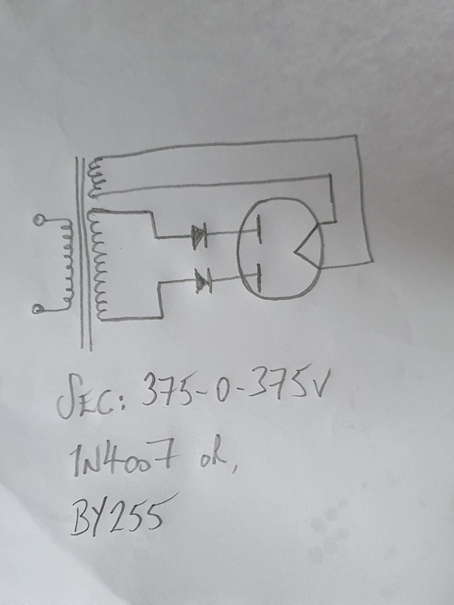

Hi Guys,
Almost there, after a busy patch at work.
Quick question, anyone have any issues with the attached sketch, in particular, using BY255's instead of 1n4007?
Read that 1N4007's are optimal.
BY255 are better rated.
I have both, and enough to run either in series, with 10nf parrallel caps, if required using a 375-0-375v transformer.
